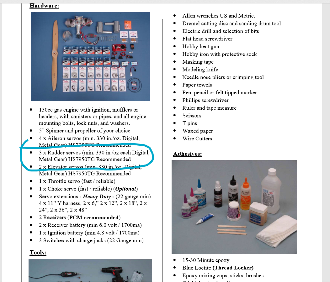

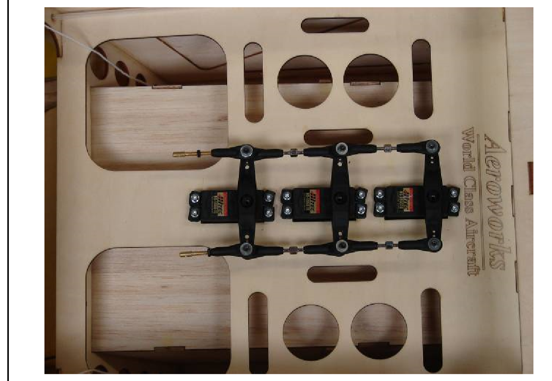

LOL! Really! There are 4 for ailerons, 2 for elevators, 3 on rudder, and 1 on throttle, choke will be manual out the bottom.
Wow did not think it needed 3 on the rudder that is a lot of power for a rudder. That should prove interesting to setup.
acerc
And it came with the hardware for the three servo linkage. It may not need three with my flying style but unlike other airframes they did not say 2 or 3. They say three at a minimum of 330oz-in/990ttl, two of these at 486oz-in/972ttl is not quite equal to the minimum requirement.
972 is a lot of pull. Depending how the arm ratio is setup with that much power it would be interesting to see if the rudder is strong enough to absorb that much power. You are going to need some special hardware to make all that work properly. Be interesting to see how it is done. I have never had to put something with that much power together.
acerc
All I know is what they say in the manual, 3 servos with a minimum of 330oz-in each. Here are a couple excerpts from the manual of the set-up and requirements.

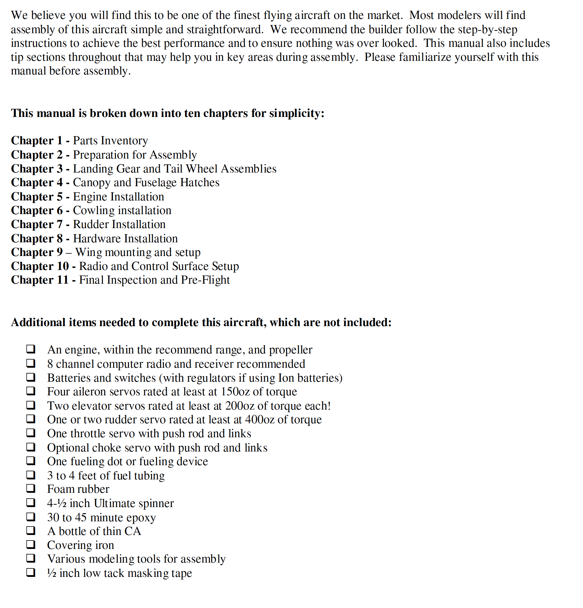

So here the PAU Ulitmate 120 set one servo , suggest minimum 400 oz output
Remember that Areoworks plans were design when high output servo weren't available, food for thought , sometimes you have to think outside the box they have given you.
