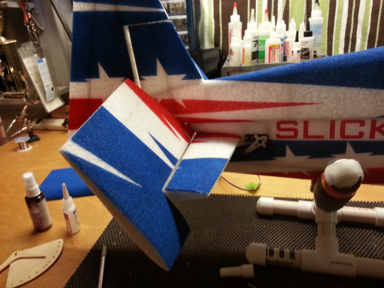

The only mod so far, (if you want to call it that) I'm not using the nylon bolts for the landing gear. Used metal bolts with some blue loctite. I have installed the servos but not the arms yet. I had planned on using the longer arms on all surfaces, then just going in or out a hole or two as needed. I obviously haven't flown it yet, but I would think it would be a little floatier than a balsa. The tail feather on this beast is enormous!!

I've got it setup with 55 degrees of throw for now!

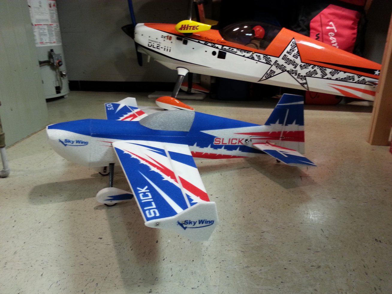

Diggity
I got all the arms on, trimmed, and all my throws the way I like them. Just waiting on the motor to come in. Mount it, then she's ready. ETA for the motor is Thursday!

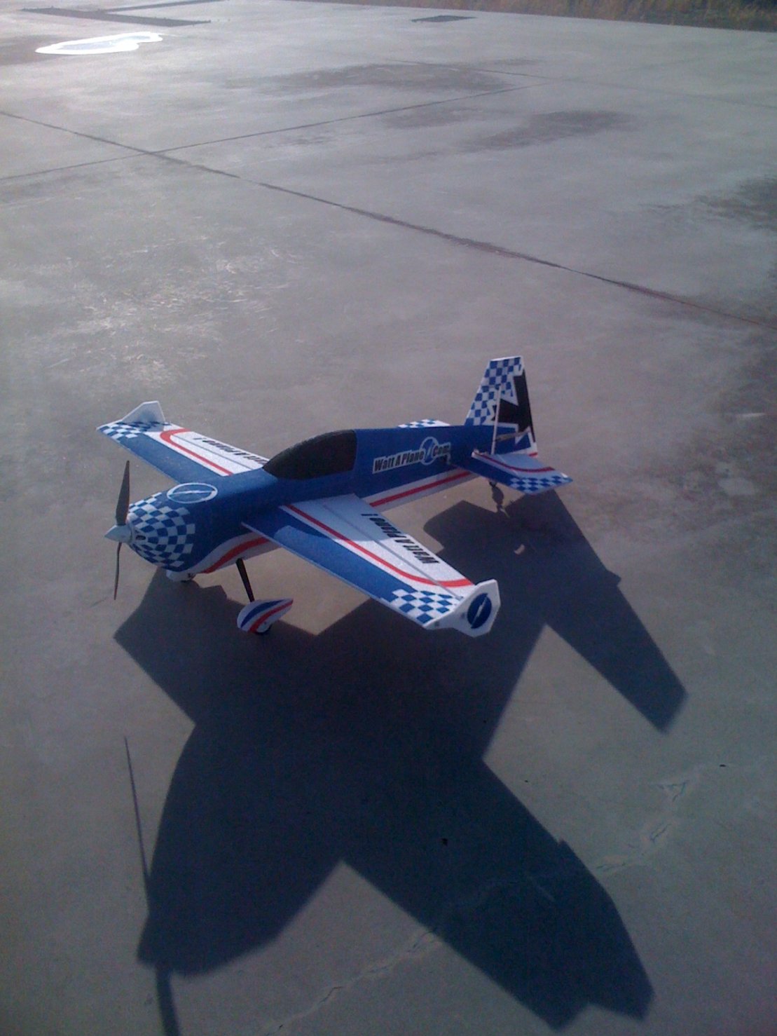

wedoitall
Member
heres mine, sorry about the crappy pic tho.
