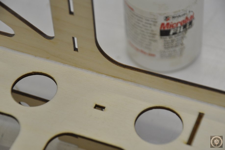

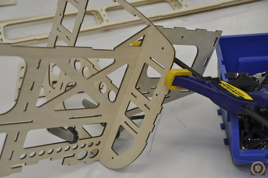

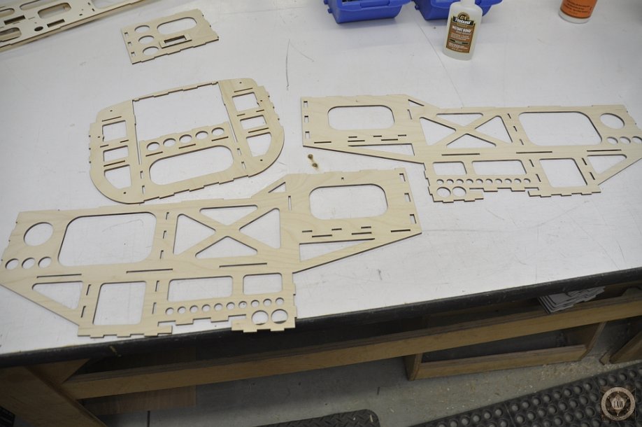

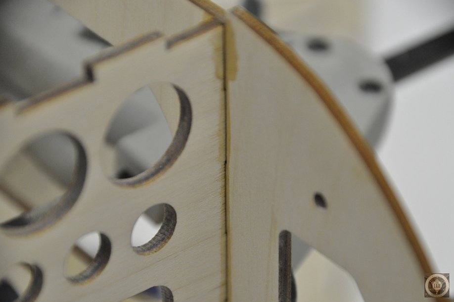

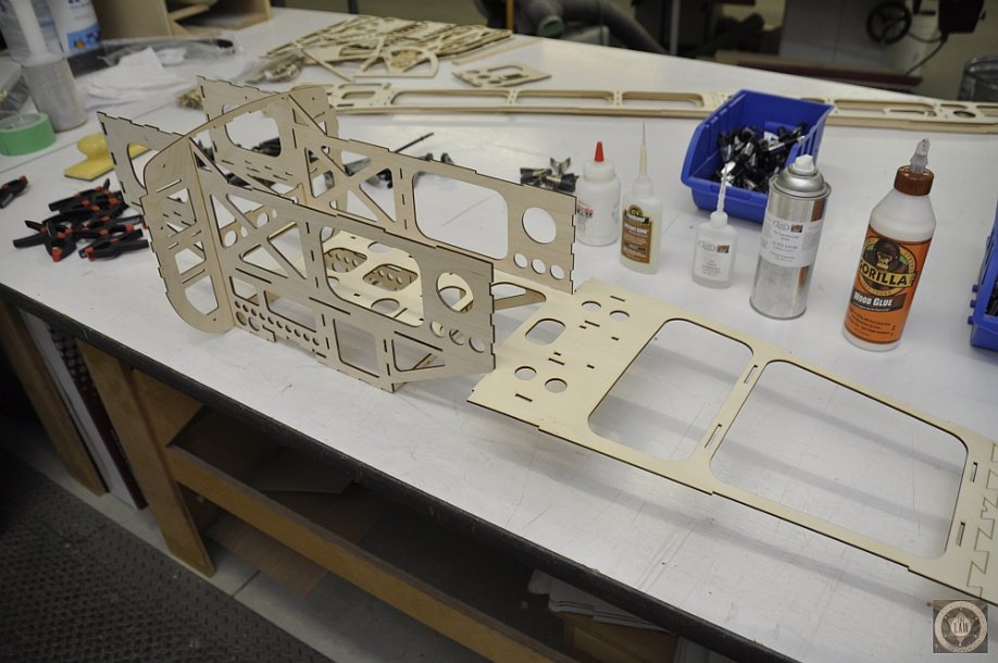

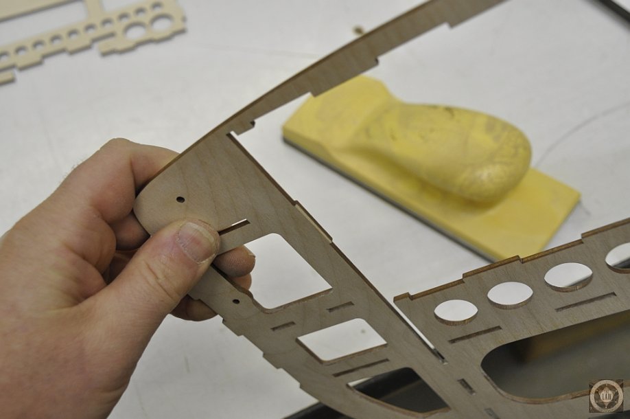

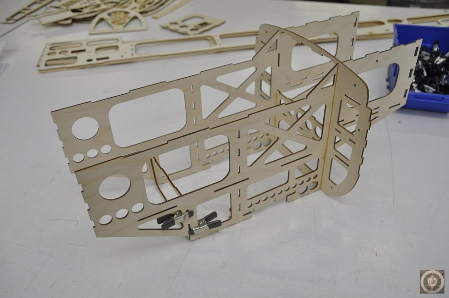

OK, time for the engine box. Normally I recommend the same wood glue as used on the longerons and such. I've done some experimenting and medium CA also seems to work equally as well and in some tests even better. The trick though is to have everything test fit (which you should do anyway) and also have clamps in reach and a plan for where you are putting the clamps.
It may be helpful to slightly bevel the tabs on certain parts in order to allow them to fit better, just don't go too much.
What I'm doing is:
- Test fit parts
- Apply glue to mating surfaces
- install part & clamp immediately
- chase the joint with a very thin tip and a very small bead of CA and do not use accelerator

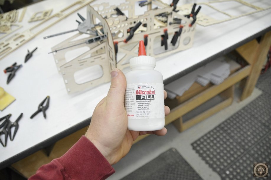

Another option to build strength in the joints is to apply some microballoons to the joint to build a fillet. Just sprinkle some on the wet glue and blow off the excess. Microballoons also acts as an accelerator.

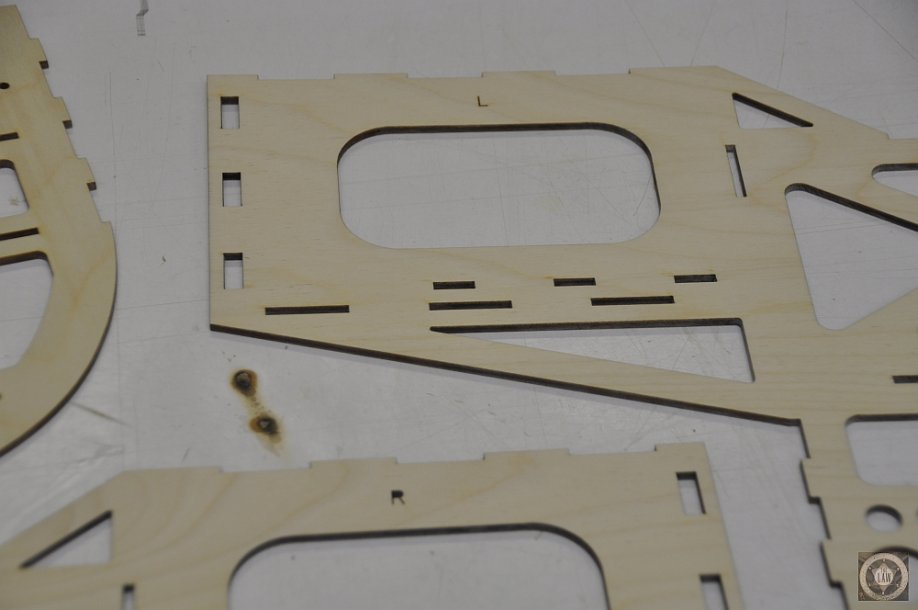

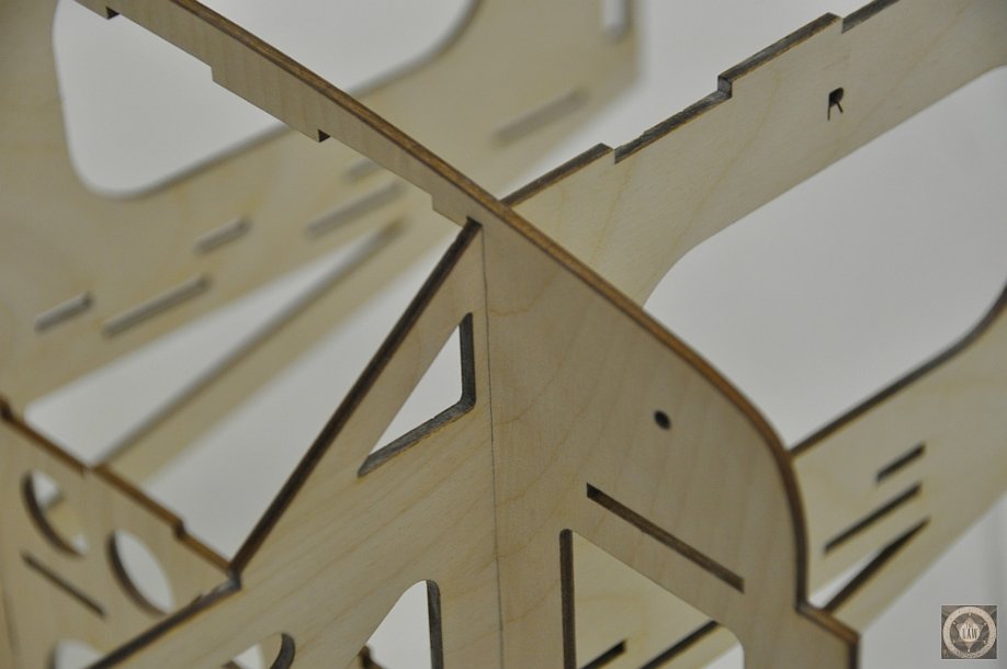

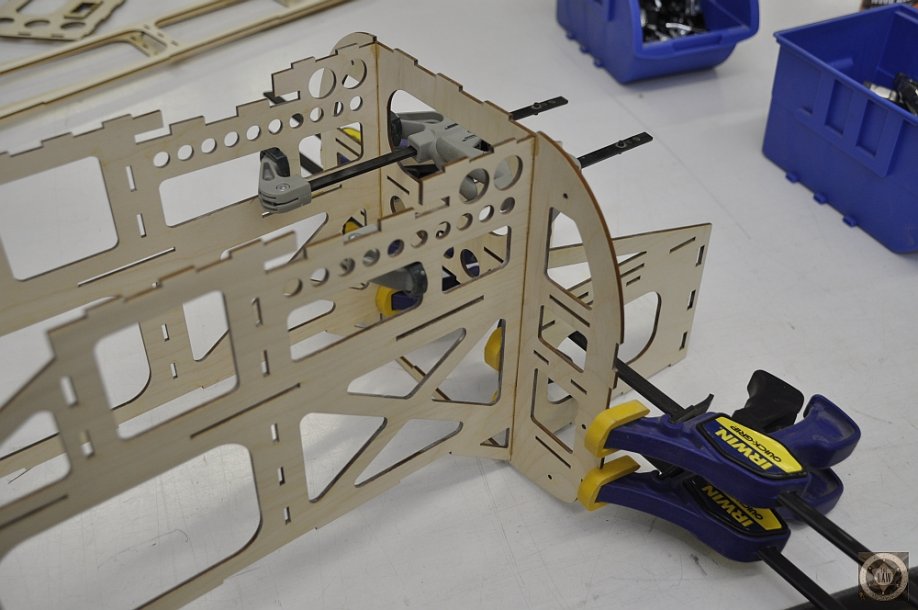

With that, install the F-1 former onto the engine box sides. This joint will get a workout in the next few steps so glue it as normal but don't fret if it cracks or creaks in the next steps. We will reinforce this further later.

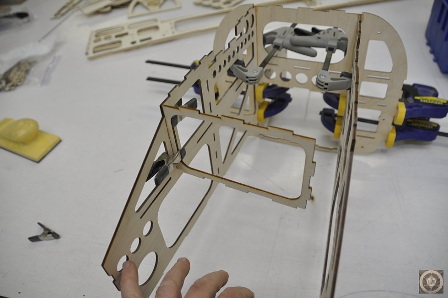

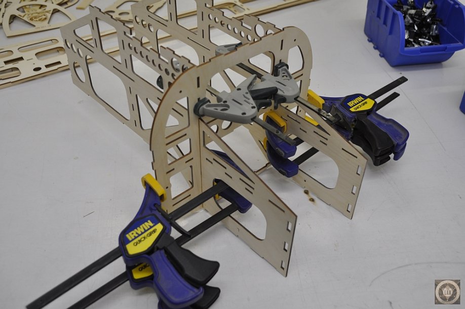

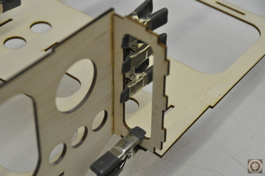

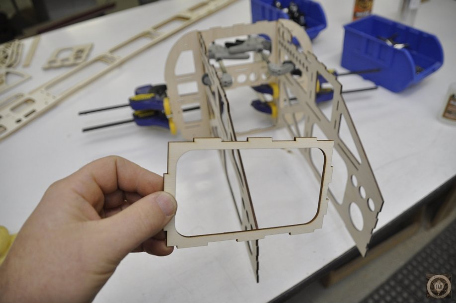

Now install the lower part of F-3 which is basically there to keep things square. It is very important but can be a pain to install. Only glue in one side at this time and leave the clamps on for now.

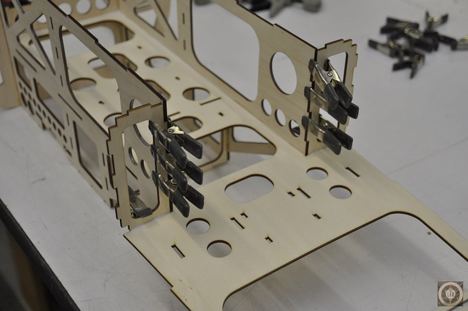

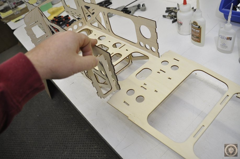

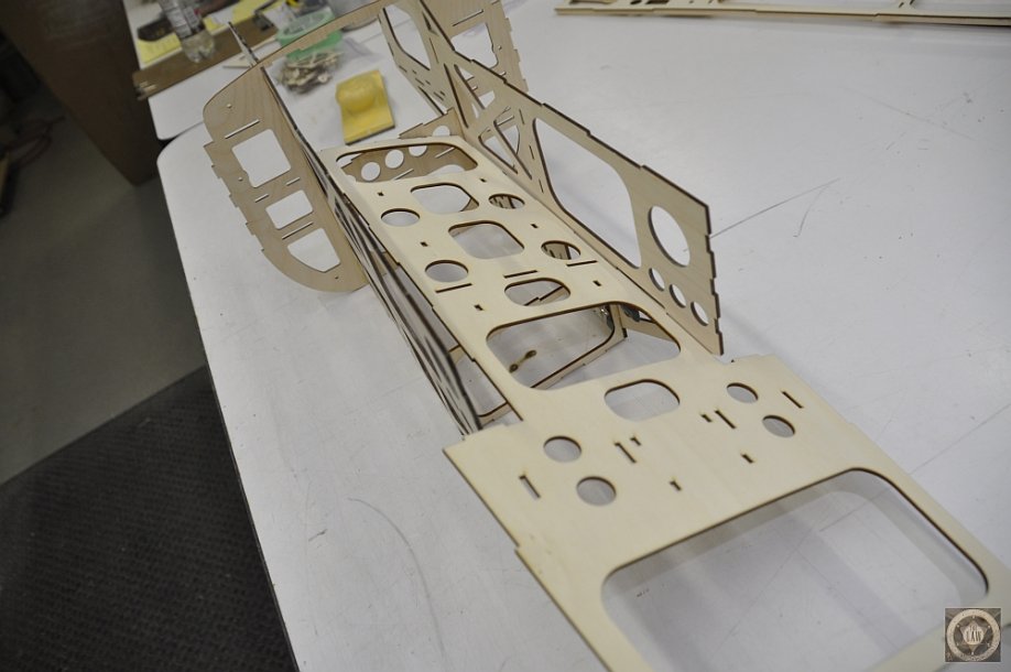

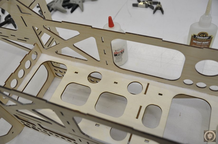

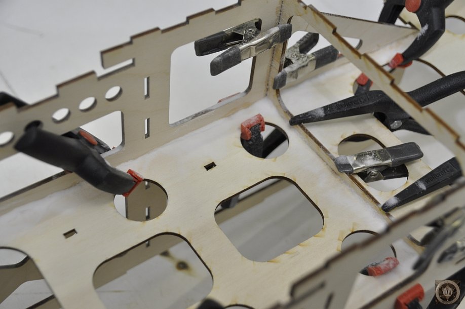

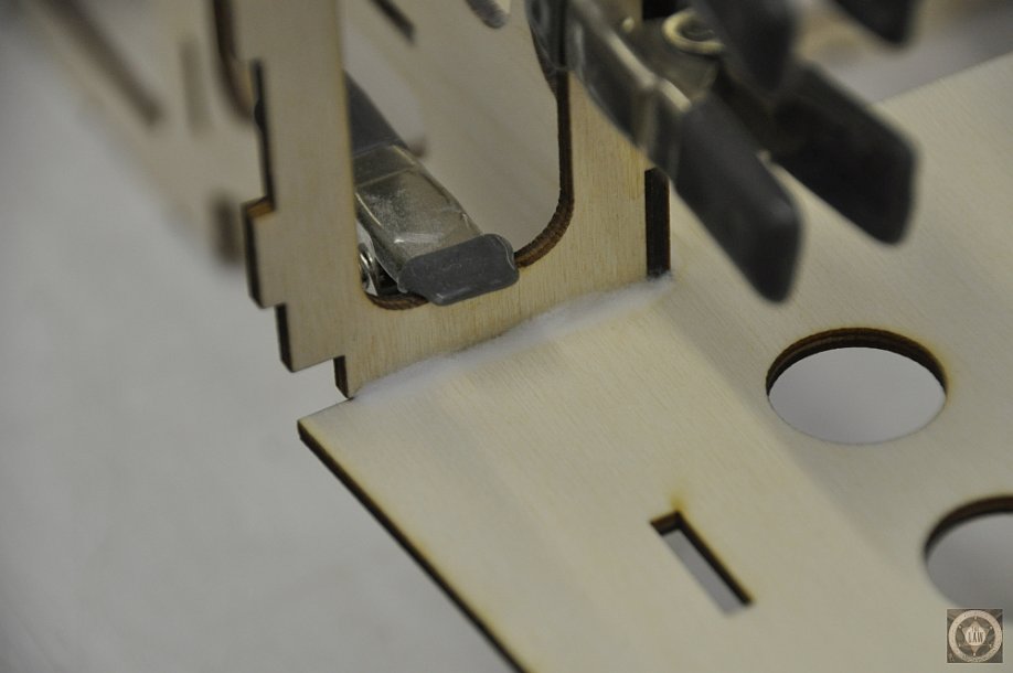

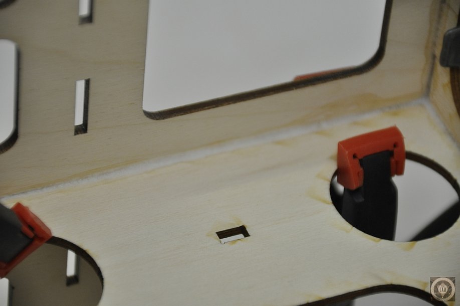

Next we'll install the floor that was assembled earlier. This part is very tricky to install and probably the hardest but also the most important part of the front fuselage to take care to pre-fit it.
Since I'm using CA this was especially important. I glued, clamped and chased each seam top and bottom with the CA and also applied microballoons. Finished assembly is very very solid!!

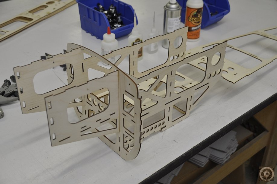

Next install the upper part of the F-3 formers which is basically two small rectangles. Test fit as always and glue and clamp with joints nice and tight. If using CA form a fillet at the rear side of this with microballoons and glue. If using wood glue, install a small piece of 1/4" balsa tri-stock here.
