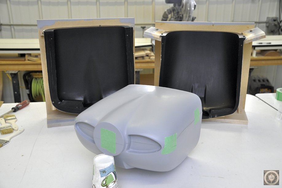

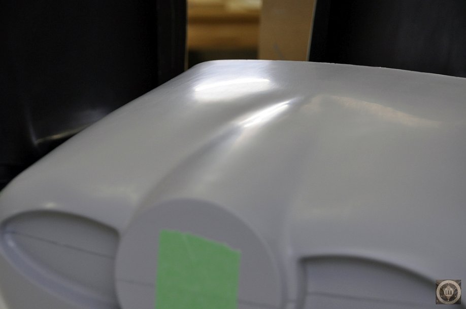

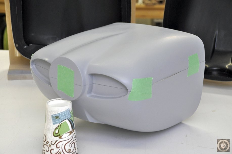

Well, the primered cowl is out and looks amazing. However I learned something. PRIMER STICKS TO THE FREAKING MOLD REALLY GOOD!!!! It took me almost 25 minutes to get them out of there while the other lay-ups were 2-3 minutes. Also another thing I learned is that the gelcoat mixture I've been using was only adding about 1 ounce of weight but it adds tremendous surface tension and makes the cowl very strong. This primered one is too flimsy to use without adding some glass to the inside. I am going to fill it with spray foam and use it as a plug to make myself another mold sometime later this Winter.

Sort of defeats the purpose. The Gelcoat and primer are doing the same thing....giving a smooth pinhole free surface. So the only way to really do this primered version and strengthen it up would be to add glass or use a different weight of glass. Rick really has a good combination that he uses at Fibertechnmore to get a nice strong and light cowl but the sacrifice is you have to fill some pinholes which is really no big deal. You either add labor and materials up front or you add labor and materials at the end of the process....no way around it.

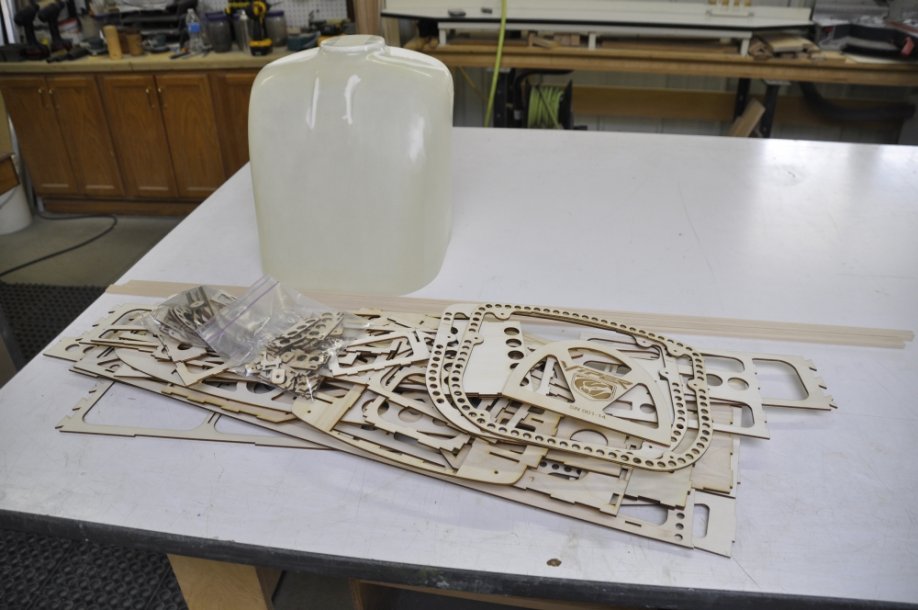

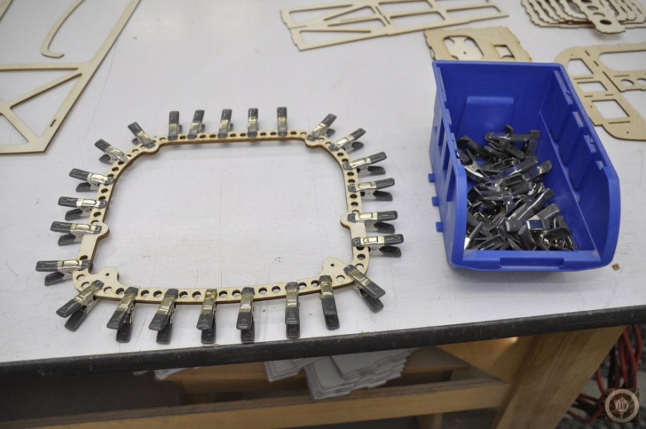

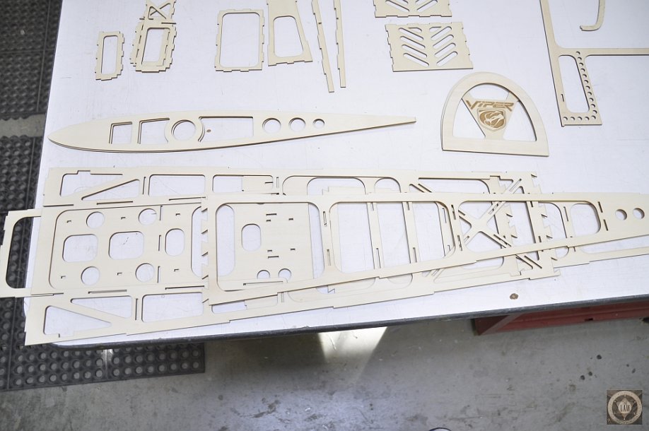

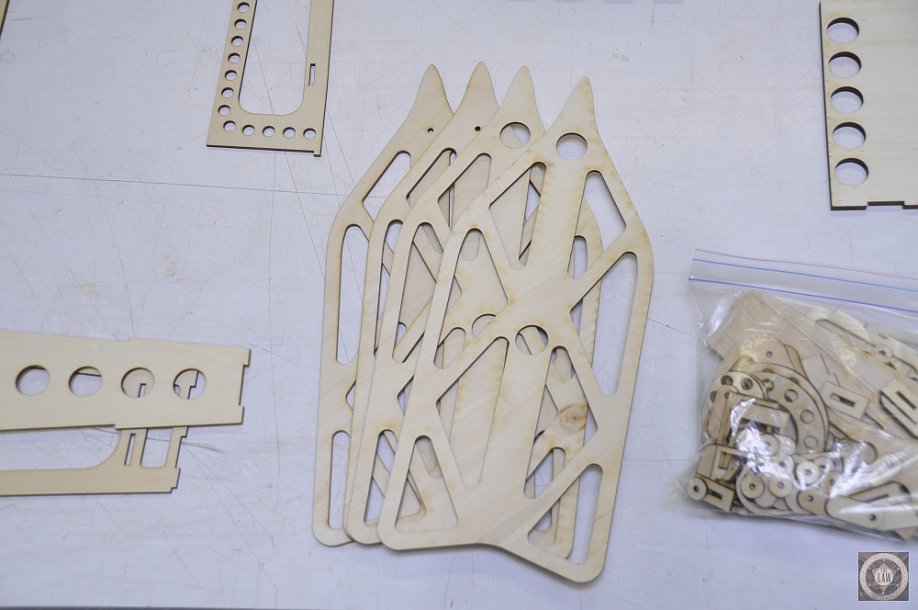

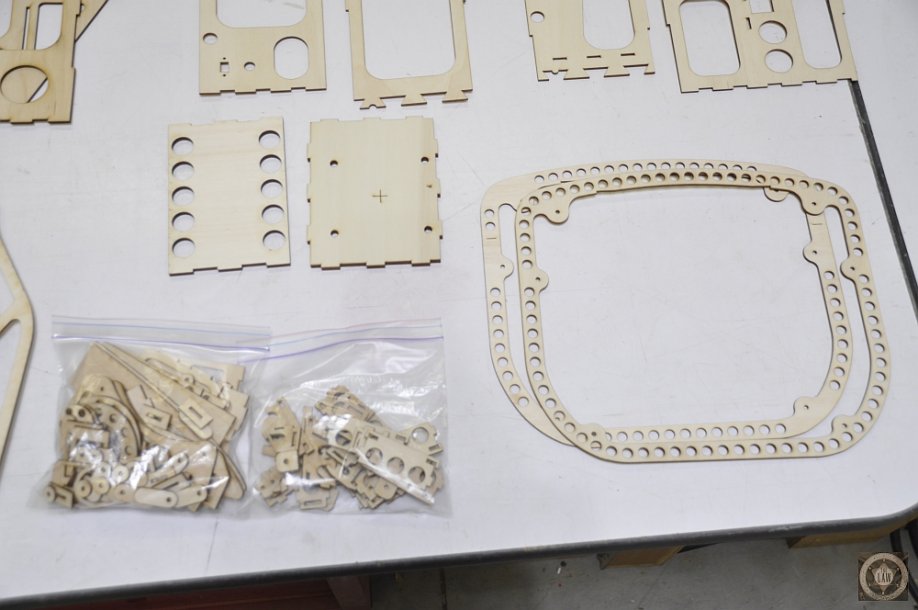

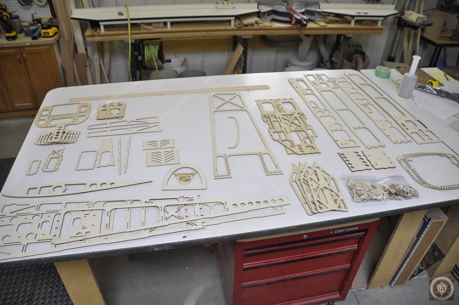

Picture of a kit fresh off the press. I modified a few parts so that there is no way to install them backwards or upside down. K.I.S.S. is always best
Terryscustom

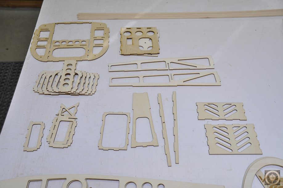

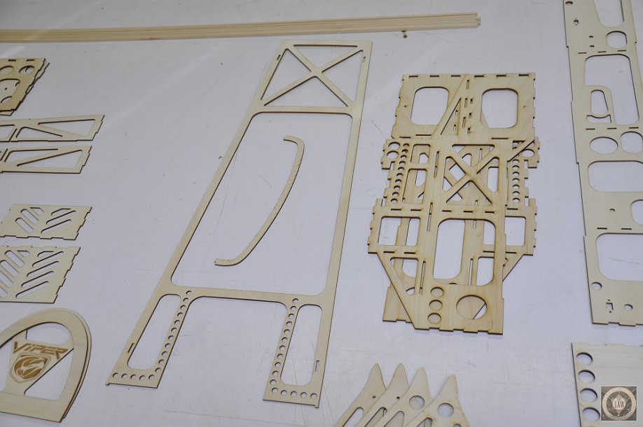

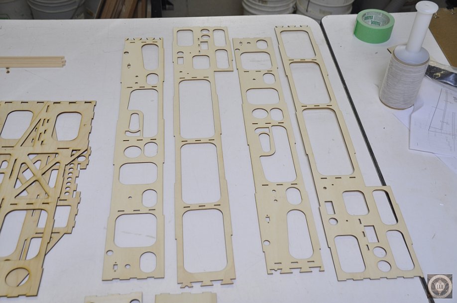

Parts layout with all formers, sides, top bottom and misc. fillers doublers etc.

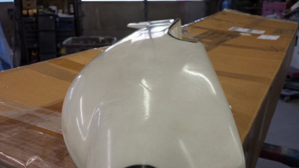

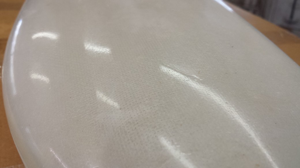

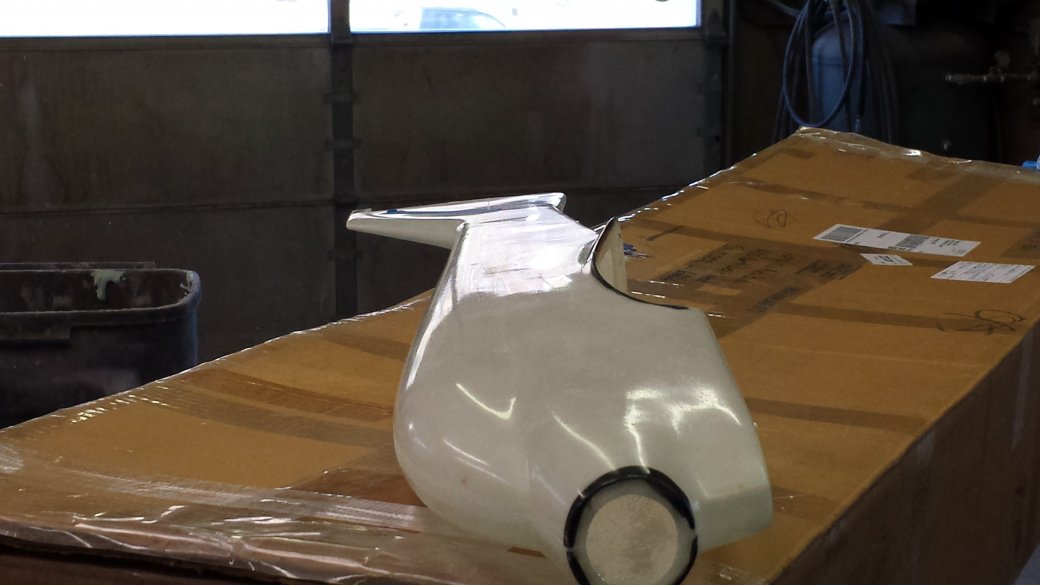

To make you feel even better about your work check out these photos of a glass fuse I just received. I won't say who made it even though they don't hangout here, but I was very disappointed when I got it out of the box. :face-palm: Sort of hard to see in the pics, but it's loaded with flaws, pinholes and waves.

Wow! Thanks for making me feel good! Pinholes in a cowl are no big deal, but in a fuselage I would wonder about structural integrity over the long haul. I'm new to this whole composites deal but the surface tension on there has to play a big role in the fuselage performance. I know you'll make it cool though, can't wait to see it finished some day!
