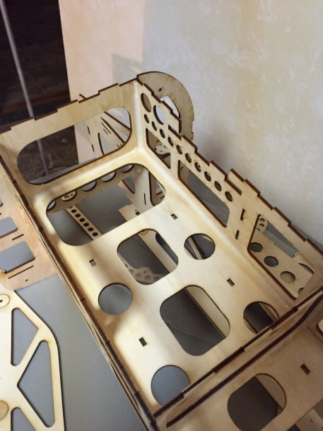

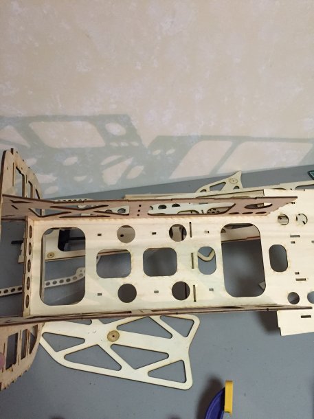

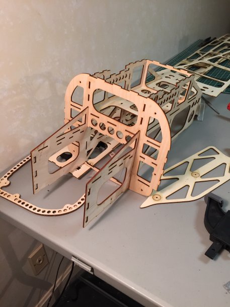

My god it was scary. I glued in the floor and it was scary. I used wood glue and I'll follow with hysol. It's a nice tight fit. I had to use about 12 clamps. It's now solid as a rock.
Terryscustom
Yup, floor is a tricky part. Thank goodness for test fitting to play your attack:yesss:.
That part takes little stress but plays key roll in holding the entire plane in alignment. All downhill from there.
