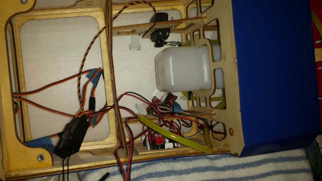

What a "birds nest" of wires.:lol2: Wired the ignition cut off and realized that I did it backwards! Holy :steamer:!!!:cryin: Packed it in for the night and will approach it fresh tomorrow. So close yet so Far!:attaboy:

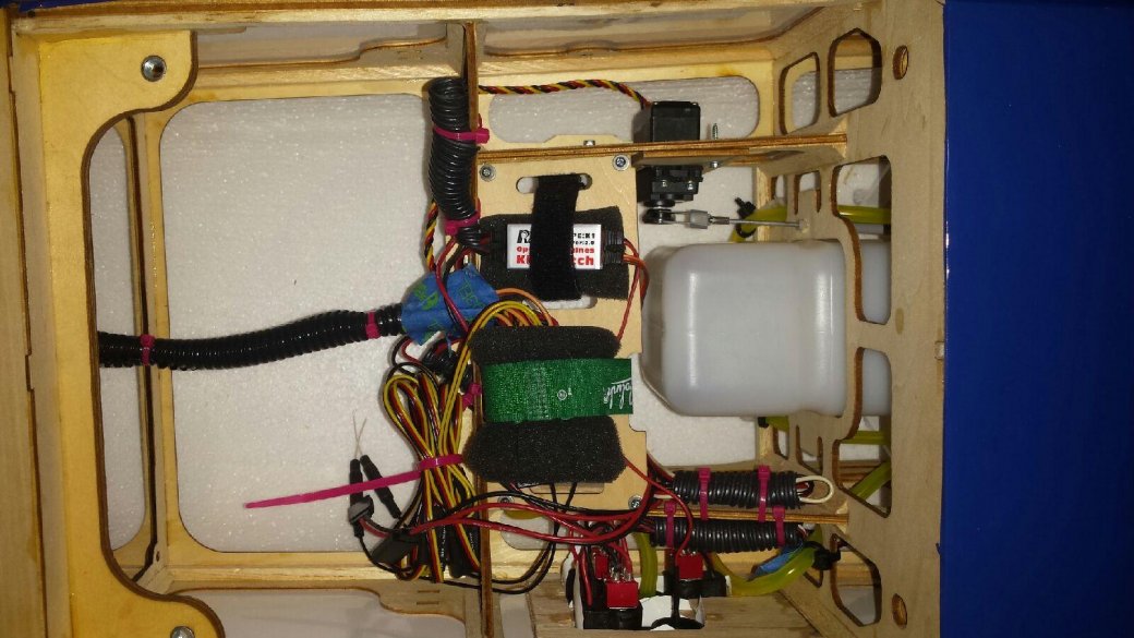

Well got a major part of the ultimate assembly done tonight, the wiring. As all you know that is probably the most important part of any assembly because without power, you aint flying, or worse, crashing! I like to use the plastic wire conduit to protect the wiring from any rub. Cable ties secure the conduit and Velcro for securing the receiver and ignition kill switch.
Just have the cowl to do, balance using the batteries and I'll be done. Hopefully the next picture will be the bird completed with a nice "glamor" shot.:way_to_go:

Why the foam insulation? :oblong::p
Just old school, probably vibration isolation. I've got foam under most of mine, I don't have them completely wrapped, but I went different route on my newest assembly. I didn't use foam anywhere, not even on ignition. I saw that after I secured the rx, and igni. with foam, that the foam was so crushed that there really wasn't any need for it, so I directly mounted with velcro, and then used couple zip ties to secure it. SO far so good, but only 5 flights on that paticular airframe.
Yep. Old school. But I don't nearly foam 2.4 like the old 72's. Probably on the edge I won't foam any thing. Old dog can learn new tricks. ;)
Xpress
Nope, 2.4 receivers aren't as vibration sensitive as the old receivers were. I'd suggest just a piece of velcro to secure the receiver- plenty of vibration isnulation and lets it breathe in the event you're pushing current through it.
