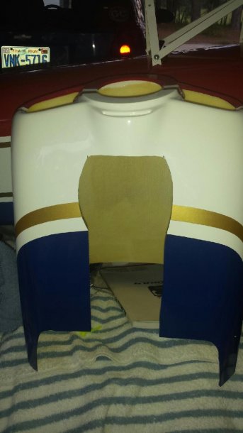

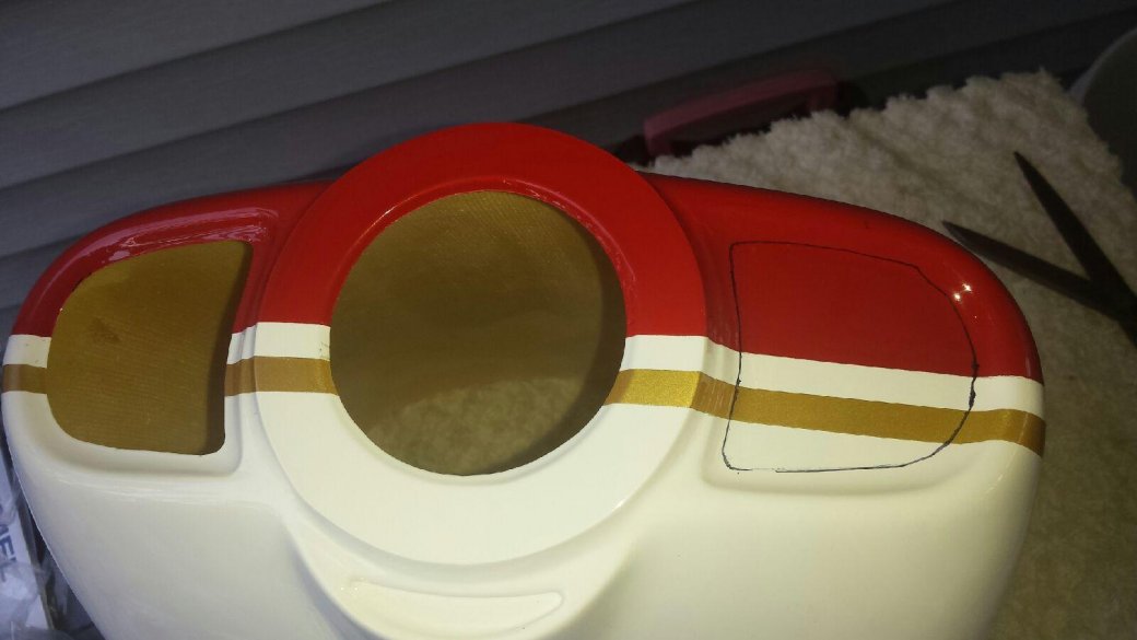

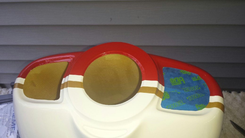

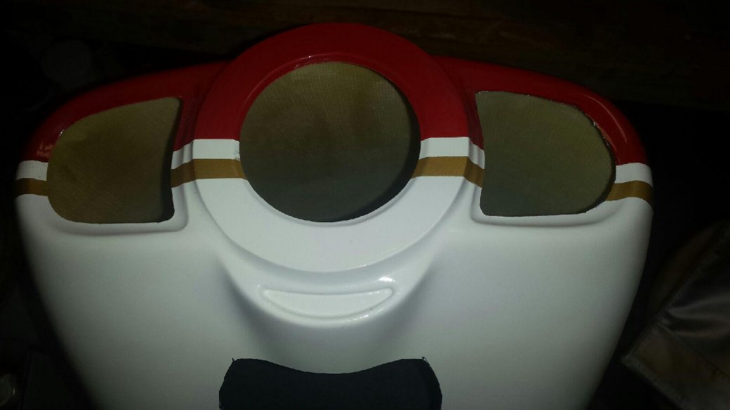

Needed to open the other side of the cowl up for cooling so outline the existing hole on blue tape, traced and placed on area to be opened.

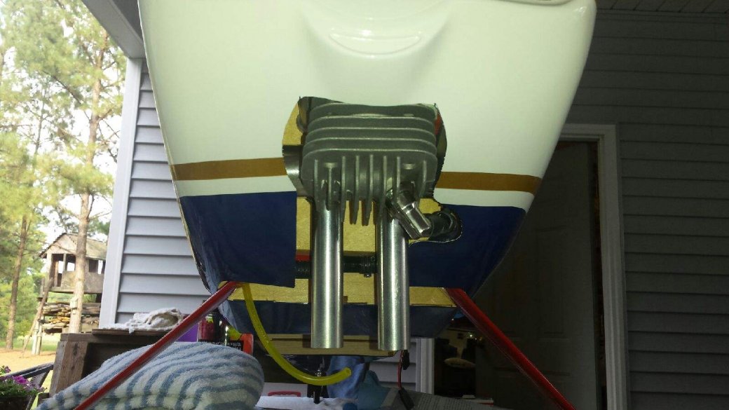

Opened up the bottom for the muffler and Jug. God I hate cutting up a cowl but no choice here in that this bird was originally designed for a side mounted glow, not a big gasser!:epic:

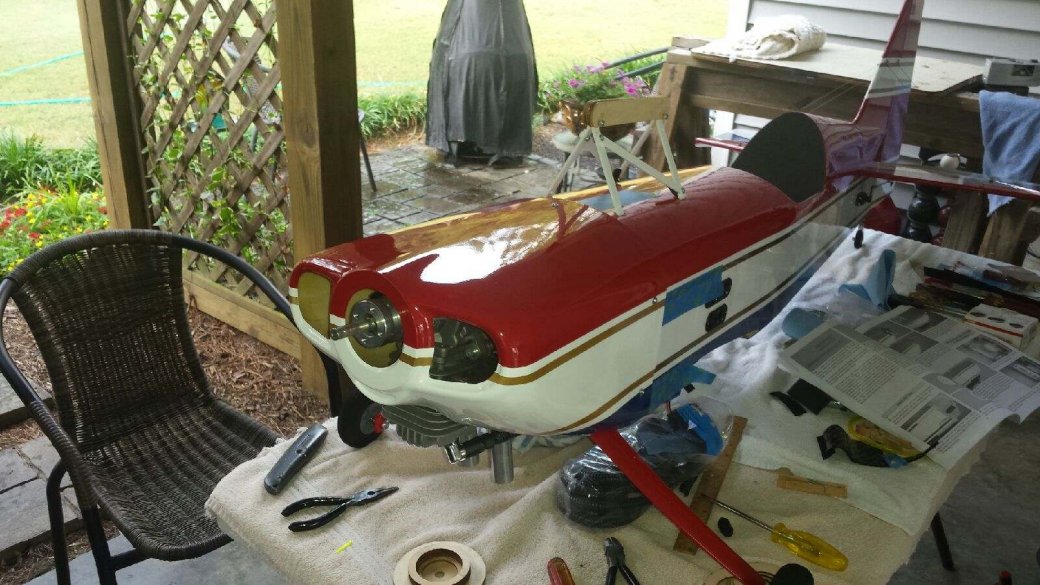

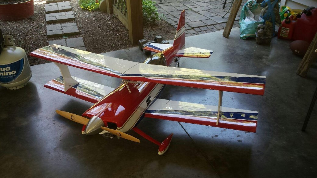

Installed!:woohoo!: Hopefully next pics will be fully assembled. Need to clean up fuse and wings, tighten up covering, attach wheel pants, props, and spinner. Install batteries for balance and should be done! Hopefully tomorrow. Been a long day so heading to :sleepy: in a few.
May wanna save those pants till after maiden, and a few flights to get used to her. They get busted just looking at em.
