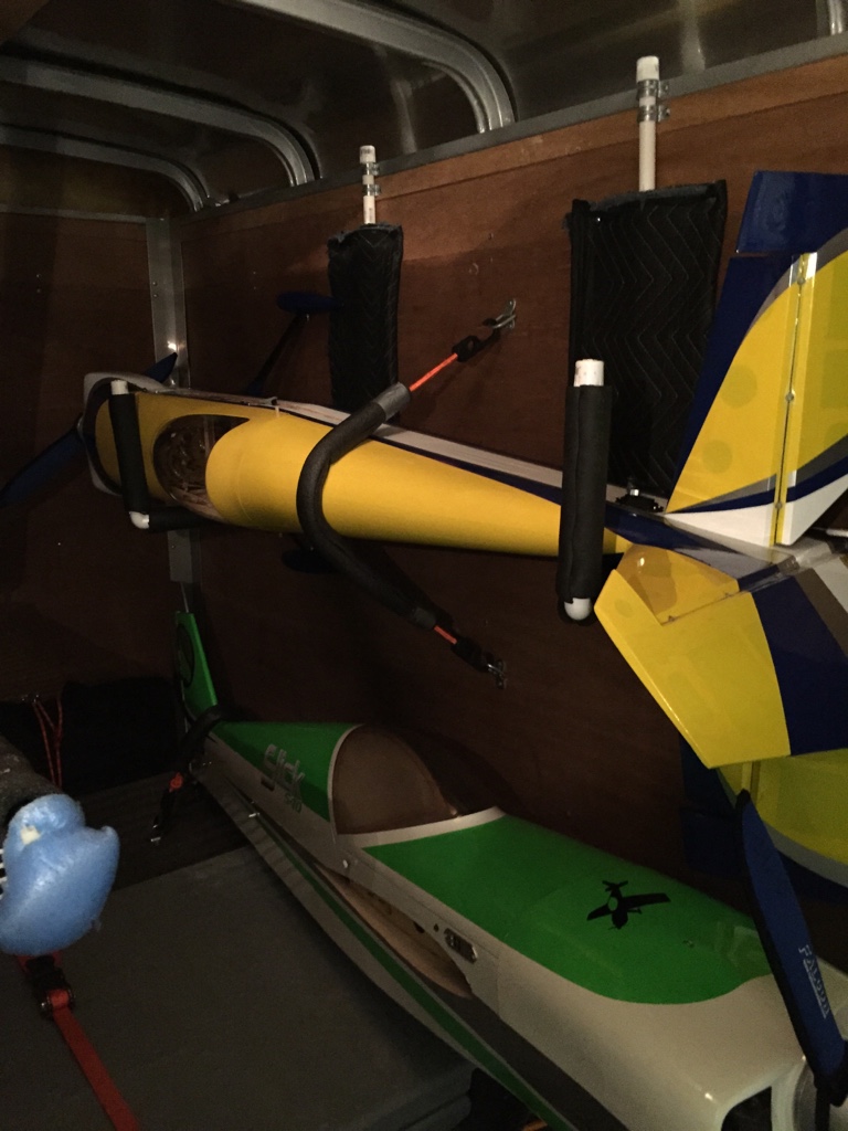

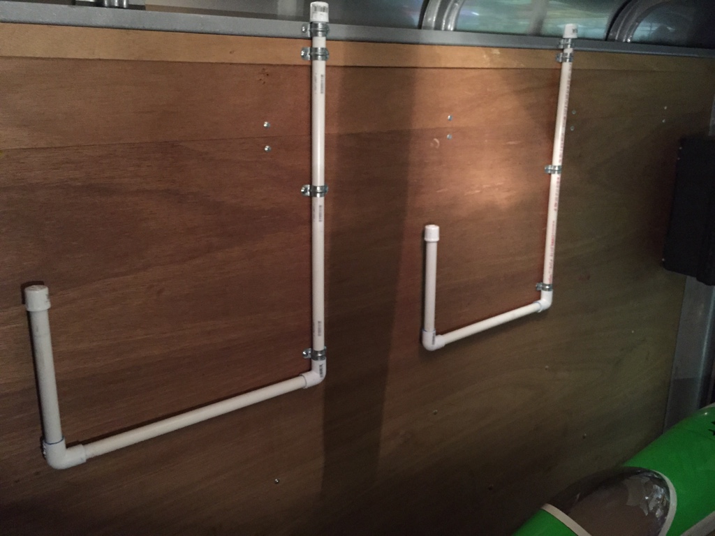

Well... On my last road trip to Tulsa, I had one of my ceiling retaining straps break on each leg of the trip... Both times the suspended plane fell. No damage the first time, but on the way home I lost a canopy from a puncture/crush.

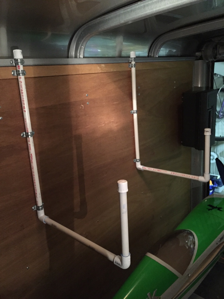

So time to think up a new way, and this is what I did:
First, 1/2" Schedule 40 PVC "L" brackets made and affixed to the side wall.
The neat thing is they fold flat so I can easily move about the trailer securing the bottom planes first.

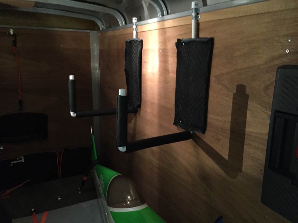

Then, covered in foam rubber, and some moving blanket affixed to the side wall just in case.

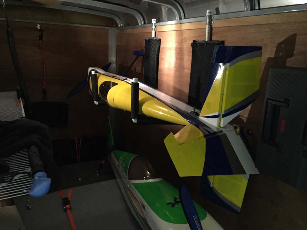

Test fit, all looks good.
Finally, a foam covered bungee strap to keep the plane from sliding around too much.
This rig is holding the EF 74" Laser in these pics, and I'm confident it'll work for any 35cc and below plane... what do you think? Am I crazy for not putting a screw into the brackets just in case the end cap on the top fails? Obviously they'd then be locked outward...

I would put a screw that doesn't pass all the way through the PVC, just far enough to keep the tubes from sliding down. I would put the screw between the top two metal bracket fixtures to maintain full rotation.
You could also use a screw passing through the caps and tubes...
Both are perfect suggestions Jacob, I'll do them both tomorrow.
many thanks!

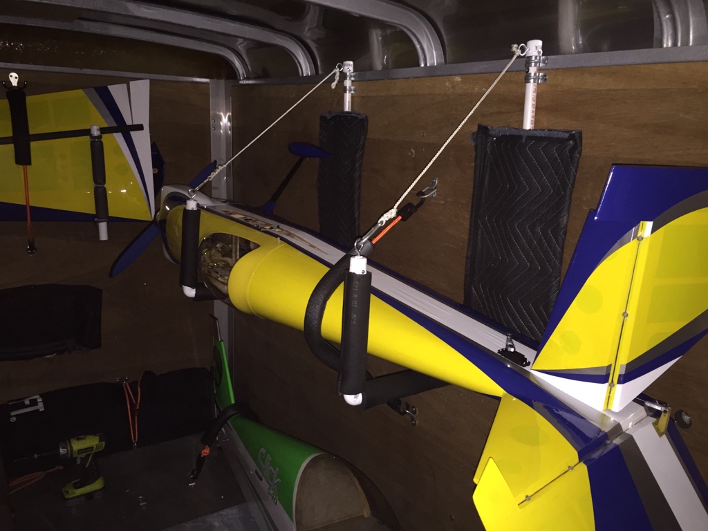

If it was me, I would take some PVC caps and drill them for some eyelets. Then add some cable and come carabiners (for quick disconnect) to make a cable brace. That pipe can work harden and snap over time. The cables if loaded a little could take the stress off the 90° elbows.
Smart!
I'm going to do that as well. I was worried about stress on the elbows. thanks Tom!
I followed Jacob and Tom's advice, and I'm really happy with the results. Much more stable!
Screws in the caps, elbows, and in between the top to brackets. Used eyelets and push clips for the suspension. Worked perfect.
Even added a rack on the front wall for the wings.
