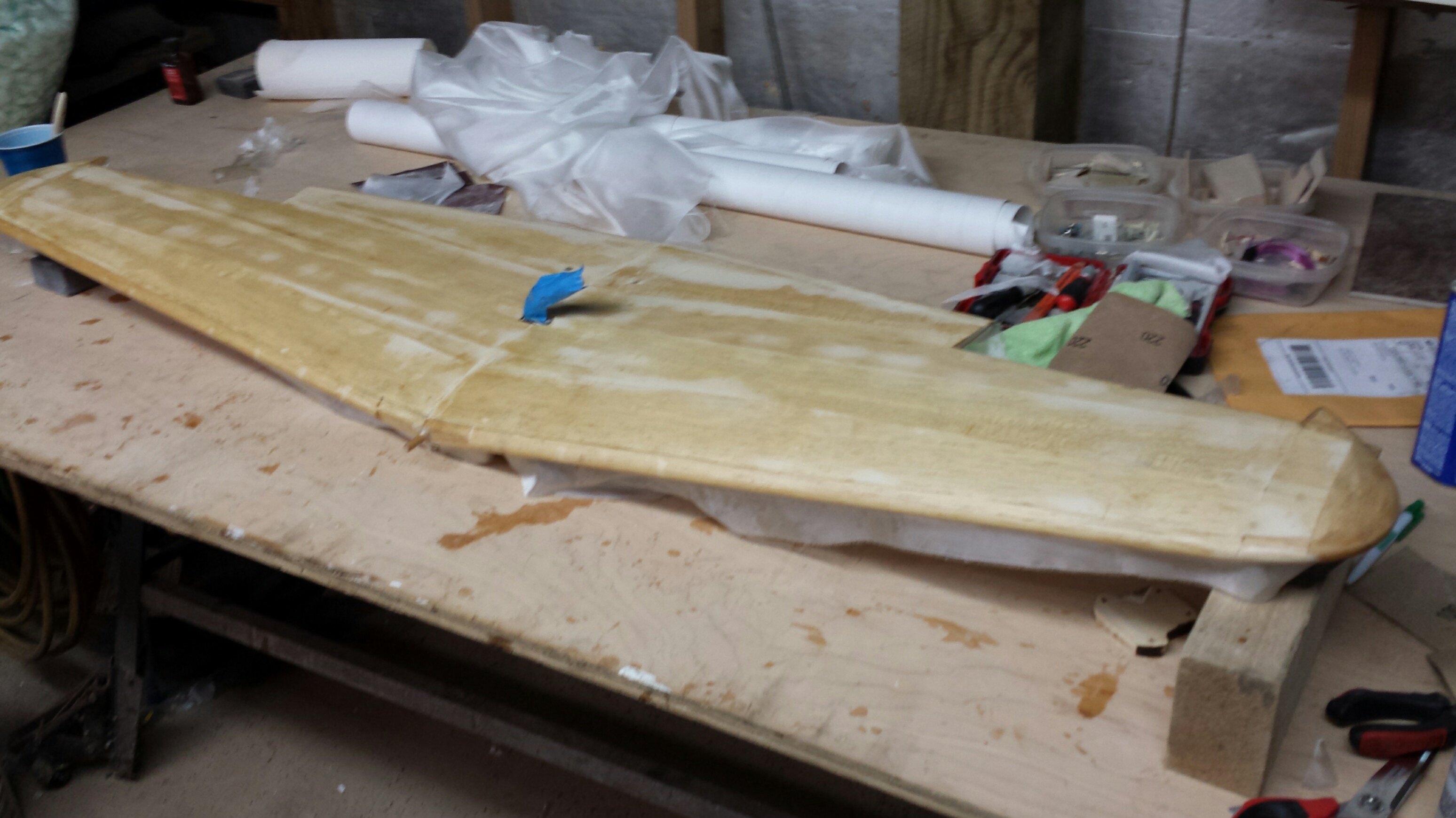

Charles
Have the first coat of glass on the bottom of wing. 20150227_143048_resized.jpg
3dmike
Man that's looking nice! You are one very patient person! I just couldn't do it.... I tip my hat to you.

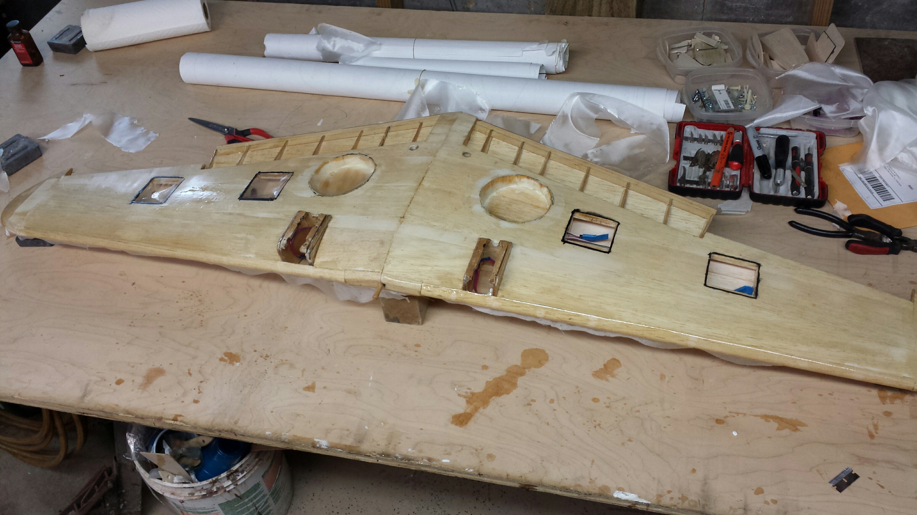

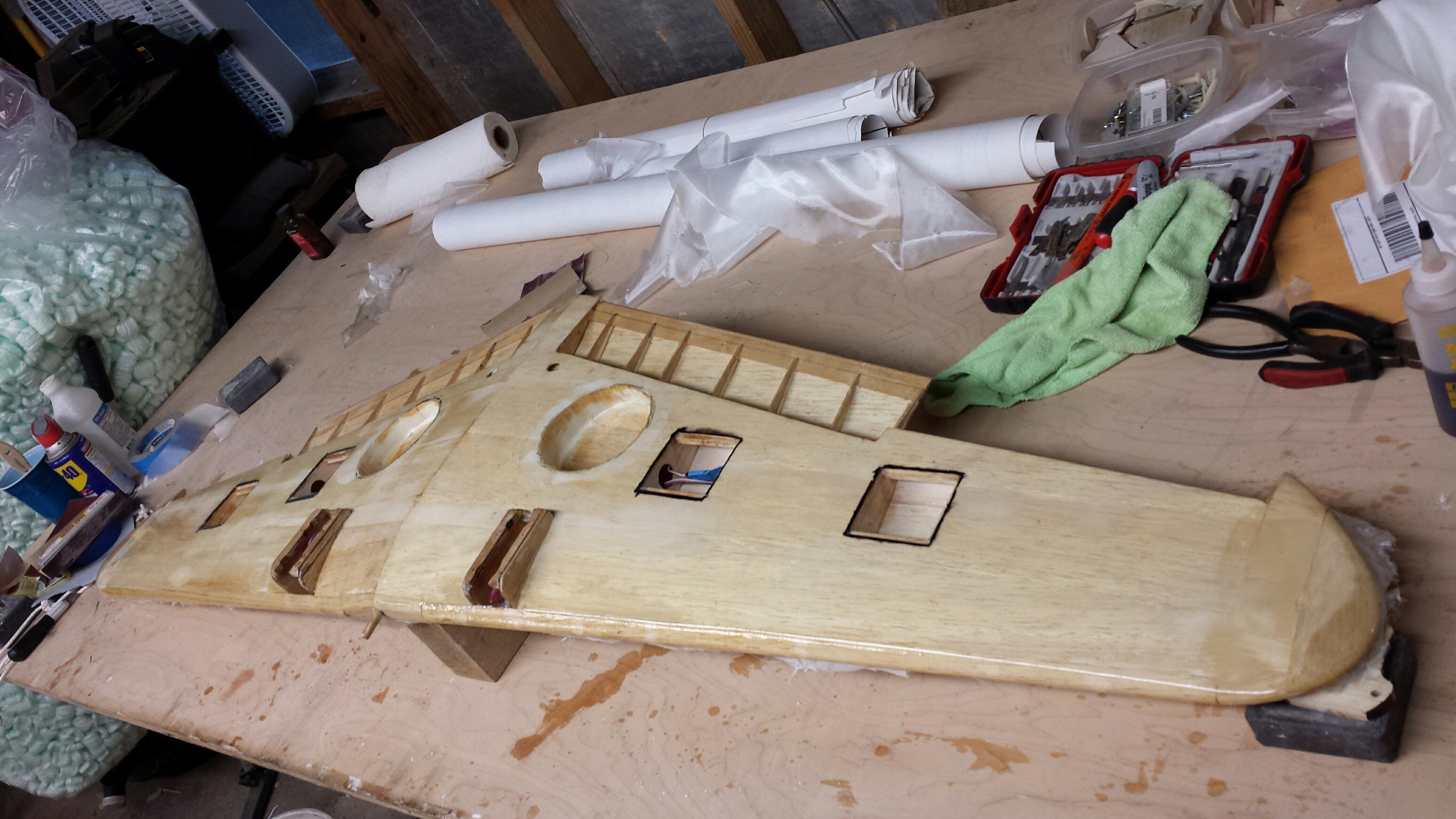

Charles
20150303_190144_resized.jpg20150303_201252_resized.jpgI turned the wing over and glassed the top of the wing this evening. I will trim the excess and sand the edbes tomorrow and put on a second coat. adding 50% denatured alcohol really makes the epoxy brush on smoothly and helps the cloth lay down good on the balsa and it saoks into the balsa and makes for a really strong surface.
