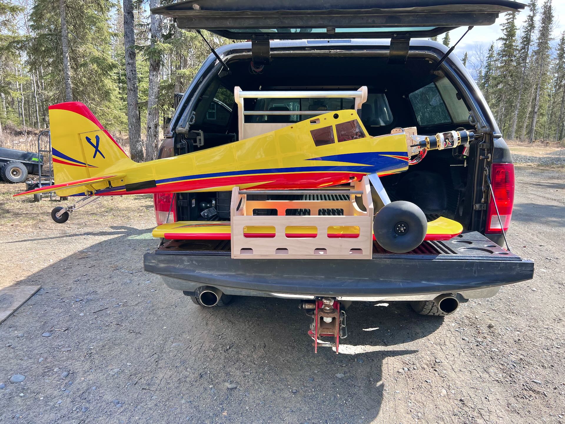

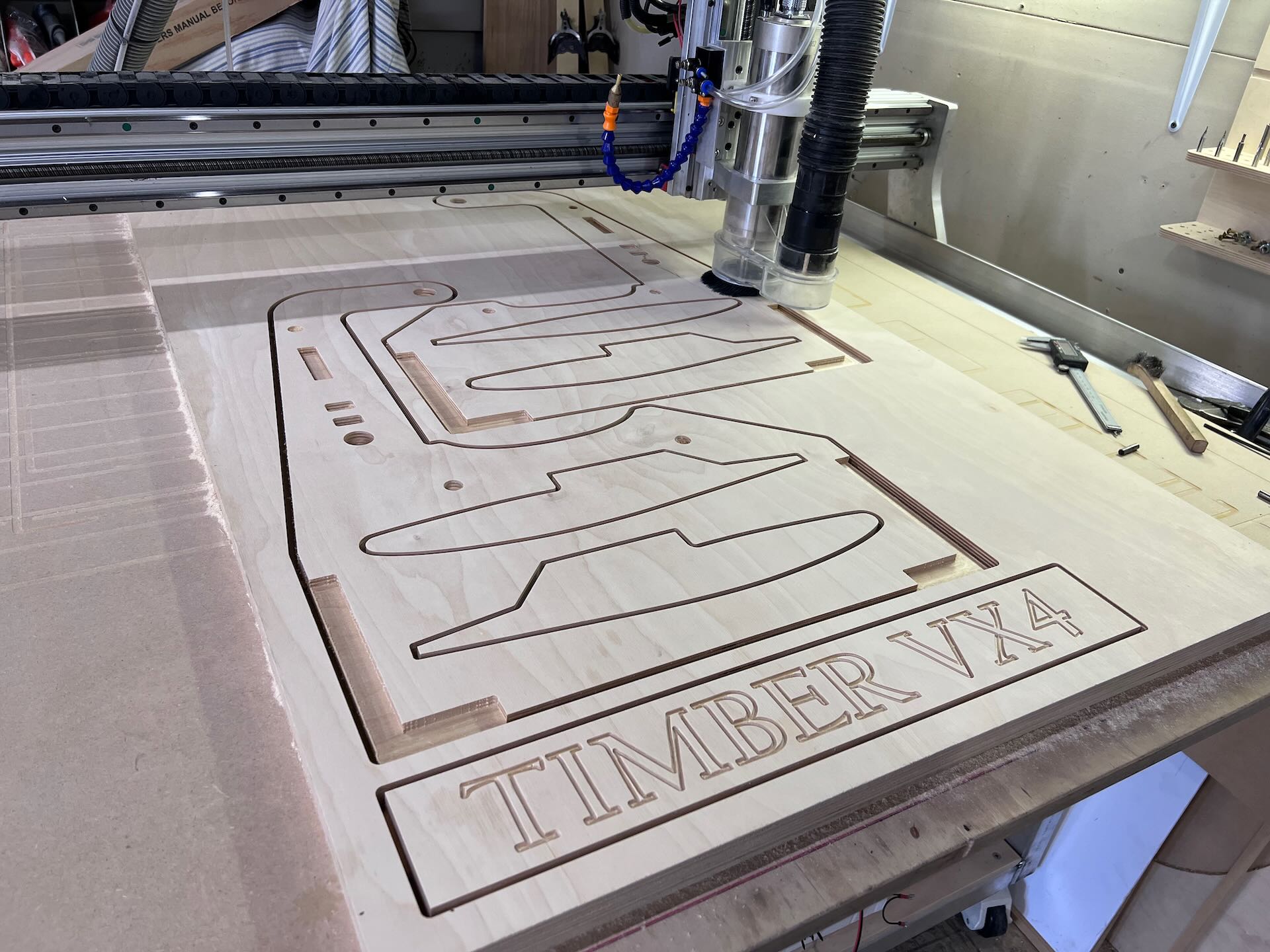

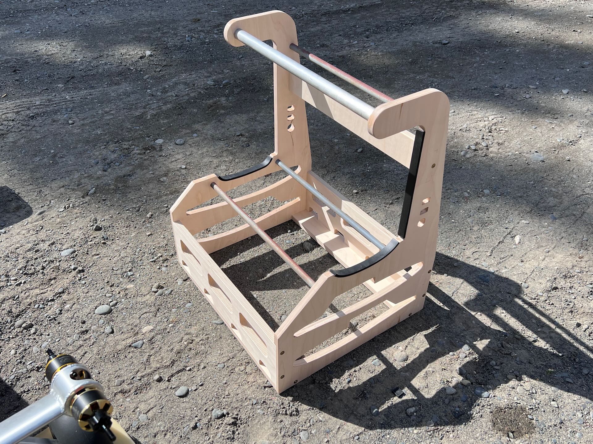

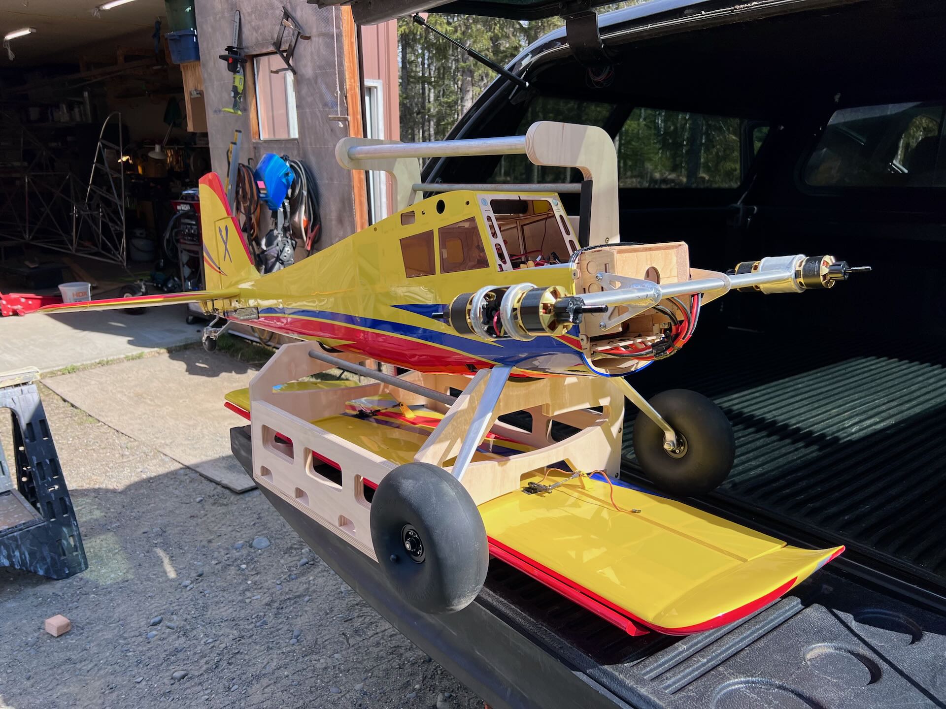

Cut out a transport rack for the Timber. I made something similar for the Ultra Stick and have really enjoyed it. I've strapped it on an ATV rack and gone 7 miles up a mountain without issue. This allows me to carry my flight gear and plane in one trip if I need to walk over a berm and down the beach. I need to apply some clear and paint the scrap 4130 tubes I used for cross bars. After than the permanent saddle padding will go on.
Beautiful! Mikey like.

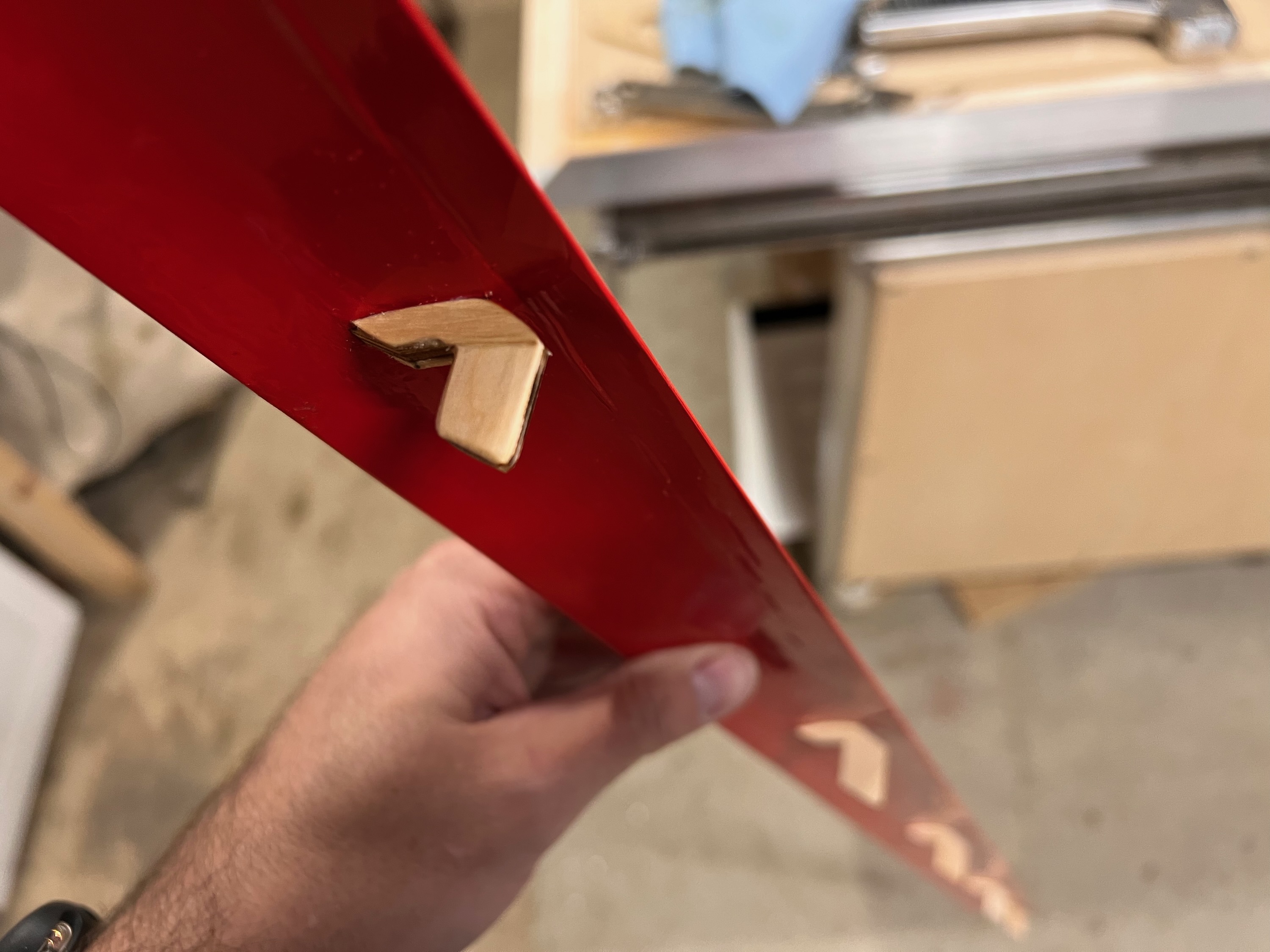

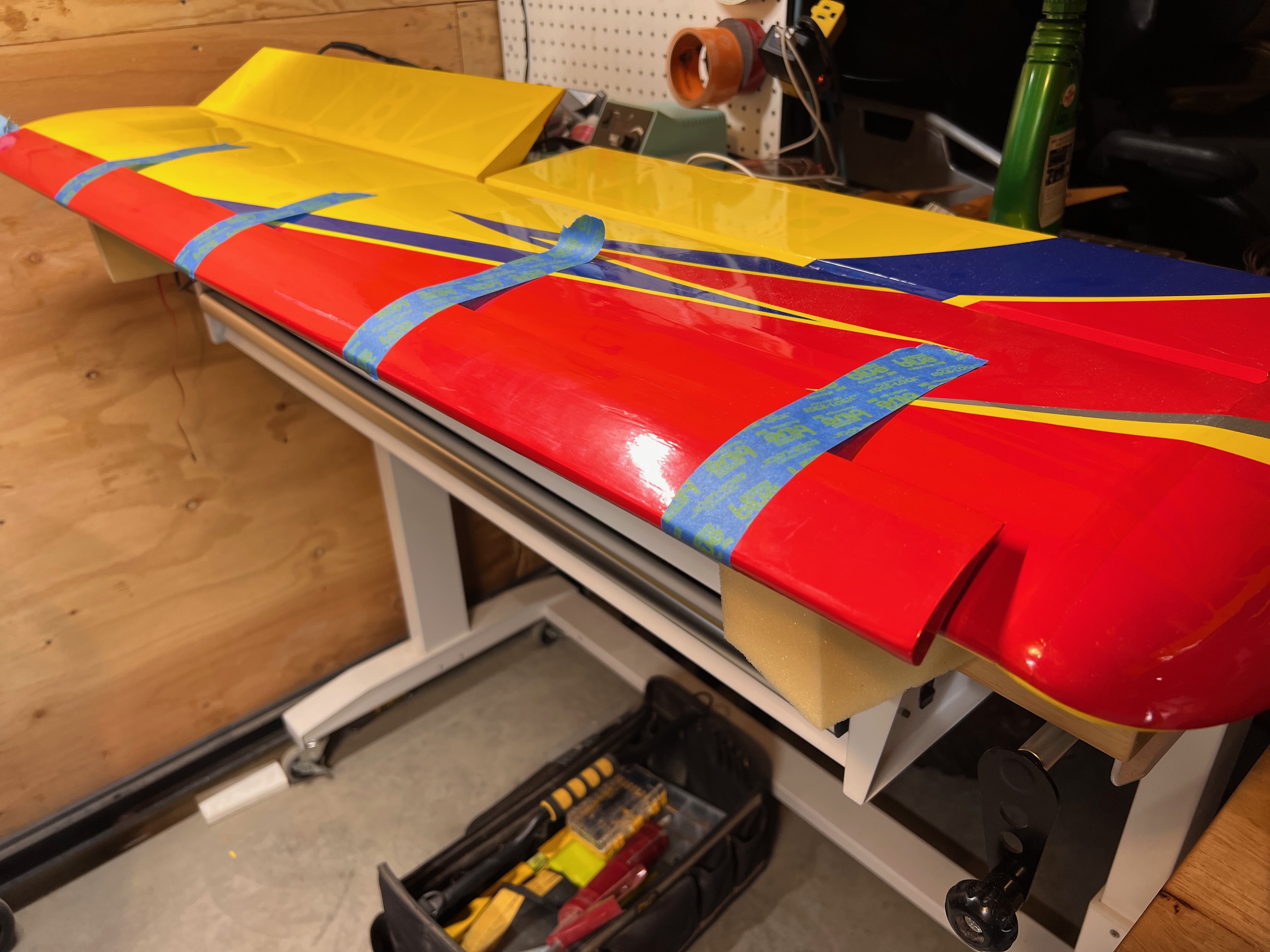

Milled a tiny slat tab sandwich extension to grab on to the stub left from shipping damage and epoxied on the remaining slat. I've been enjoying fine tuning the Aura 8/Spektrum setup and added a differential thrust mix:
