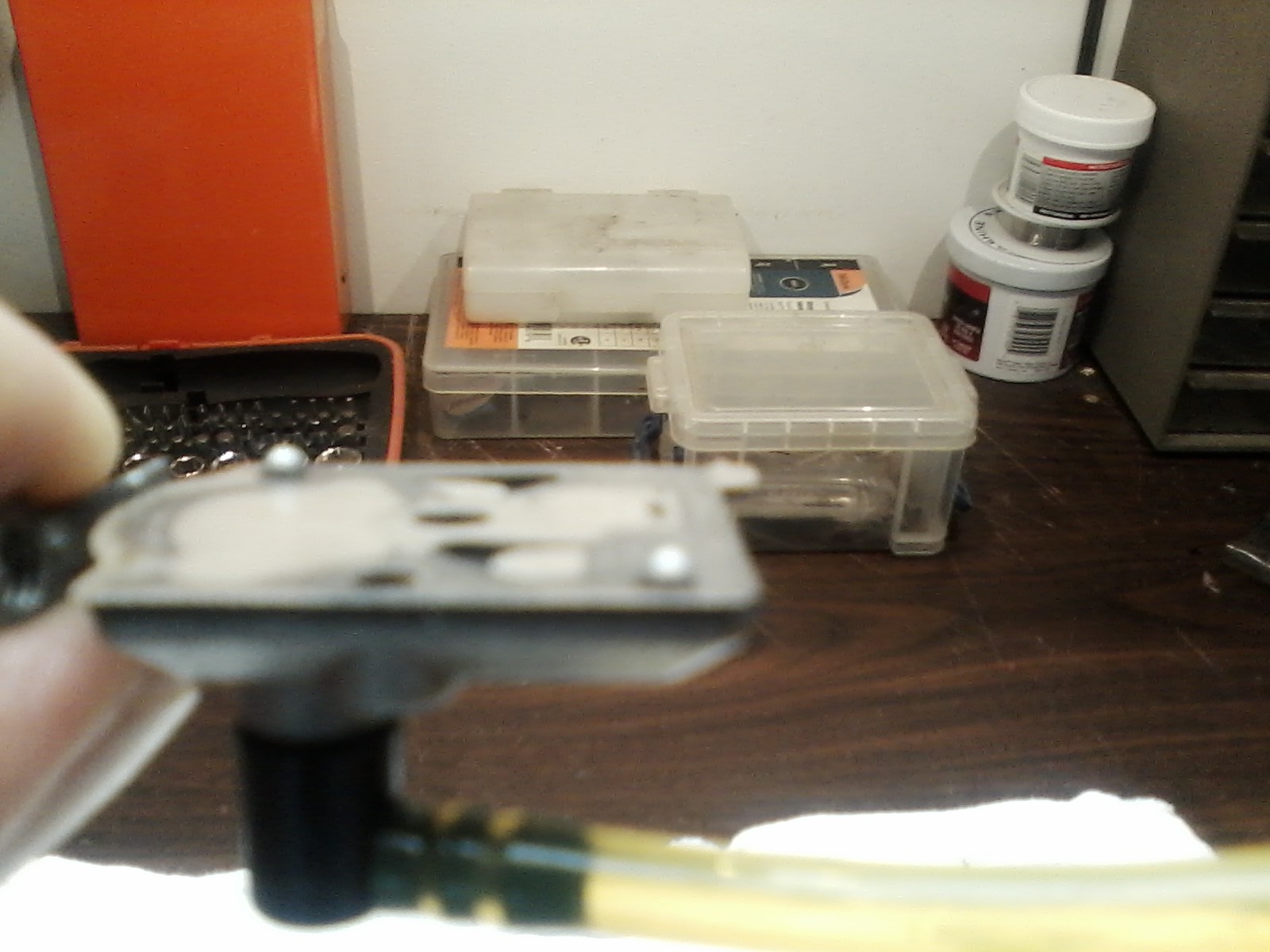

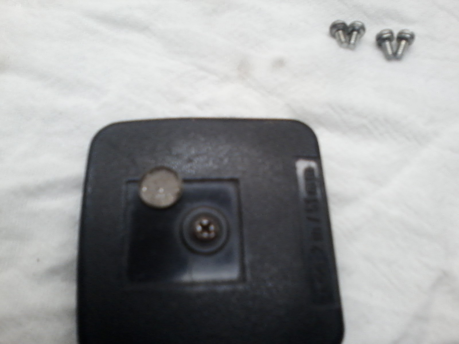

After seeing those servo grommets my OCD sent me to new heights and I actually pulled apart the carb with out having to take pictures :attaboy:.
So here are some pictures :oblong:.
0730171441-00.jpg 0730171443-00.jpg Found some demons inside. Bunch of metallic debris and crud on the screen and the "pump" gasket stiffened with a deflection of the petals keeping them off the ports.
You would think I would have a better camera by now but those demons are in my head too for an OCD guy :geek:.

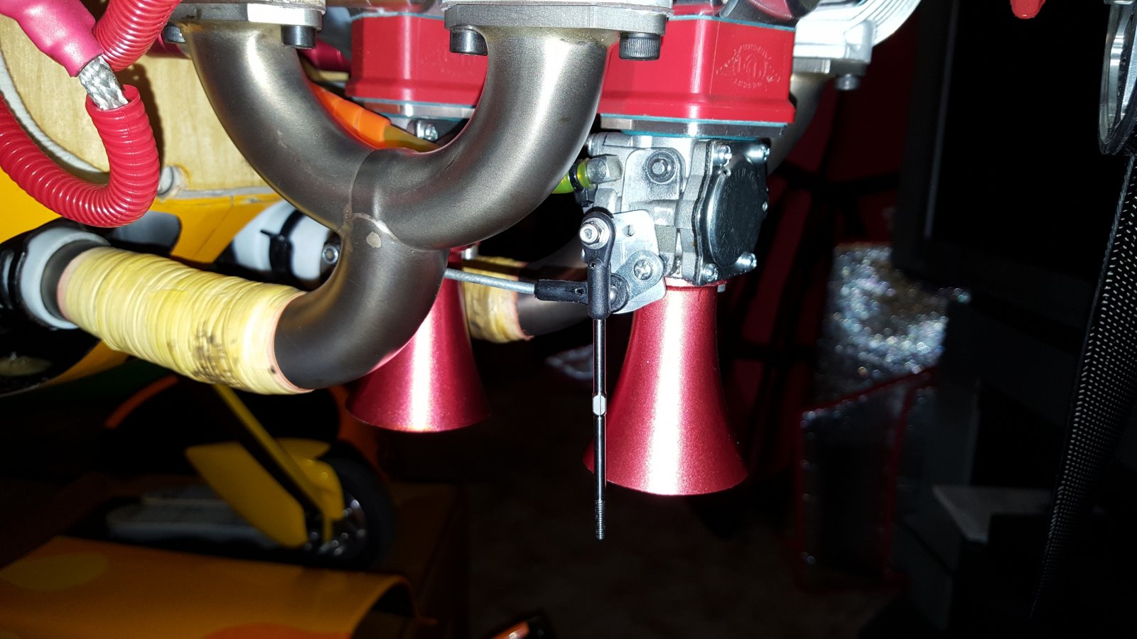

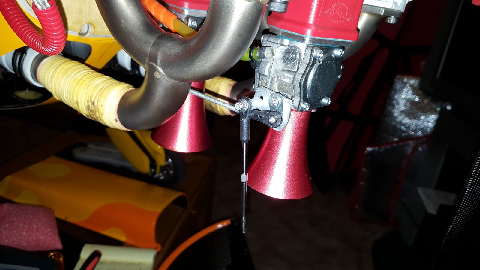

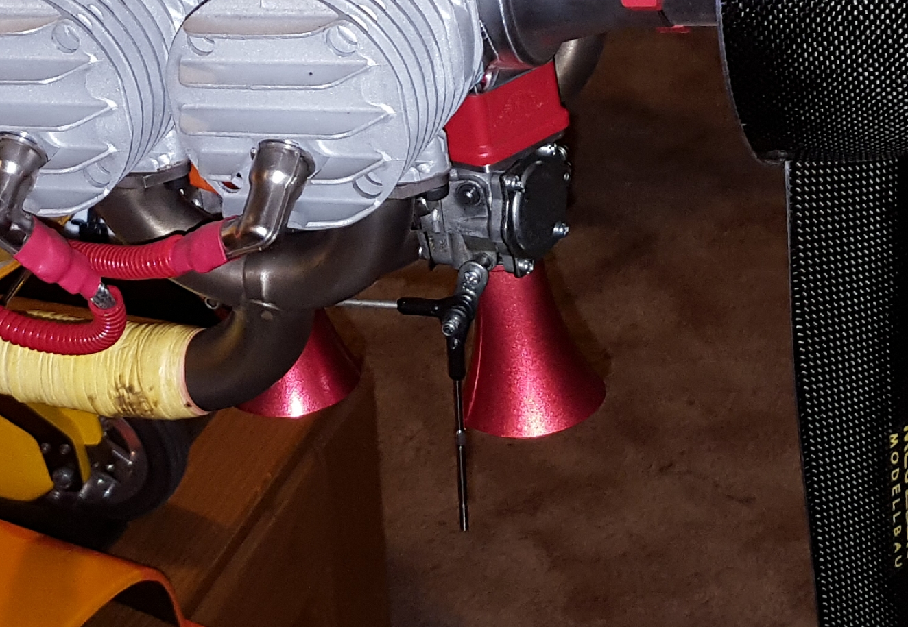

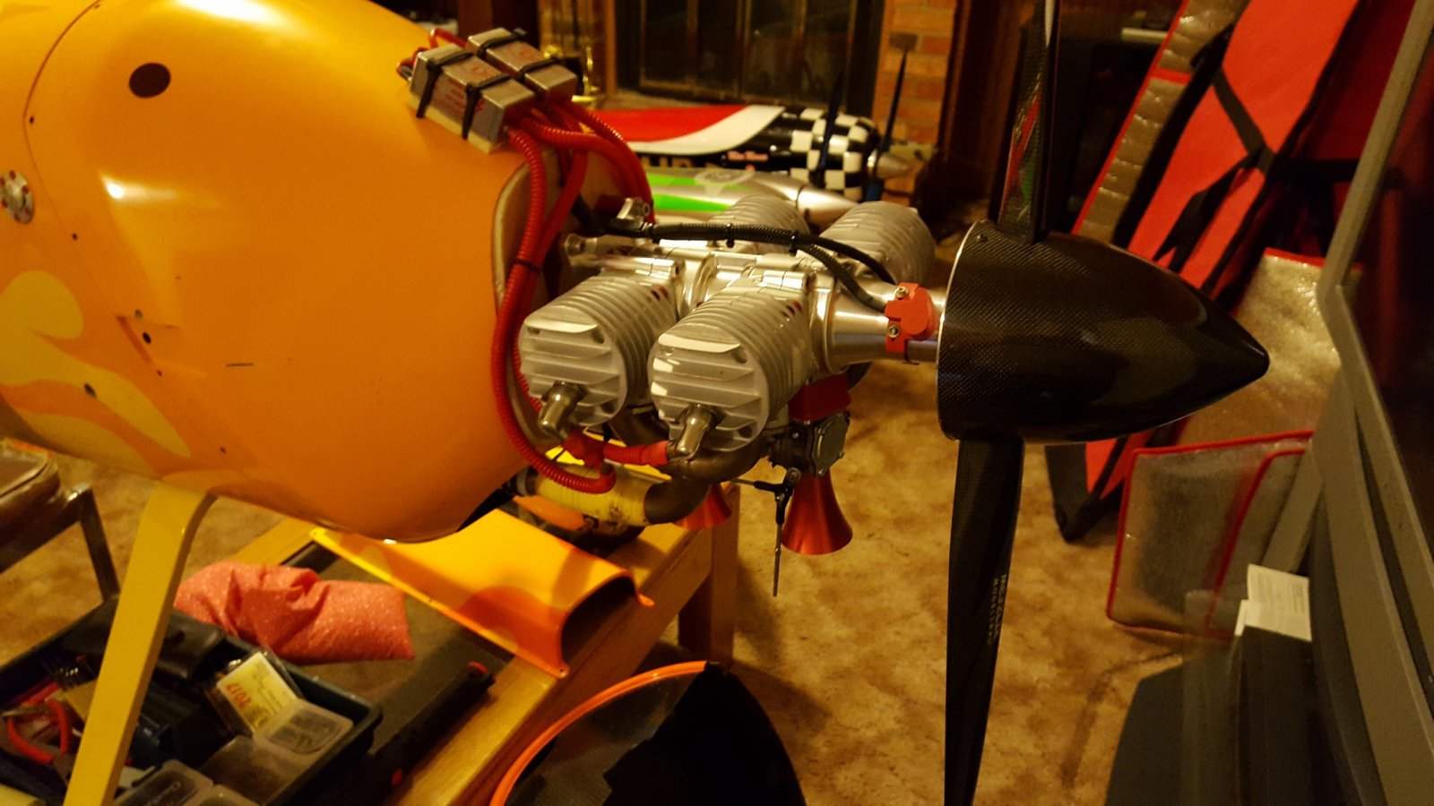

I worked more on the Sukhoi tonight. I put the throttle servo back in and as I was hooking up the linkage and noticed the chokes weren't working right. The rear one would only close about half way. I had to flip the choke arms over and reengineer all the linkage, and make an aluminum arm, and it took forever, but I got it working pretty good.
BEFORE
AFTER
BEFORE
AFTER

All good stuff! Should be quite the reliable ride when you're all done. :fist_pump:
I'm hoping so. Just reprogramming the radio should do wonders. The only tricky thing about that is programming the smoke pump to adjust with throttle. Everything else is standard stuff. The servo matching is done in the Powerbox so I shouldn't have to do that. I am adding a kill switch for each ignition, and a gyro.
