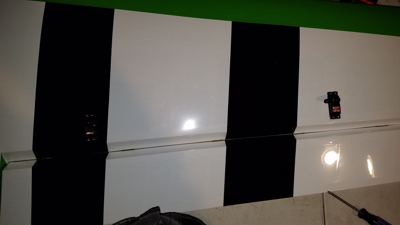

Well I finally started to work on my 107" Pilot Edge! I've had the thing for at least a year and a half now and have done absolutely nothing with it until last night. Put 2 servos into the left wing panel and was going to continue to the right panel before I realized I don't have any harnesses or aluminum servo arms :oblong:
Hard to tell but there's 2 HSB-9380TH's in there :D

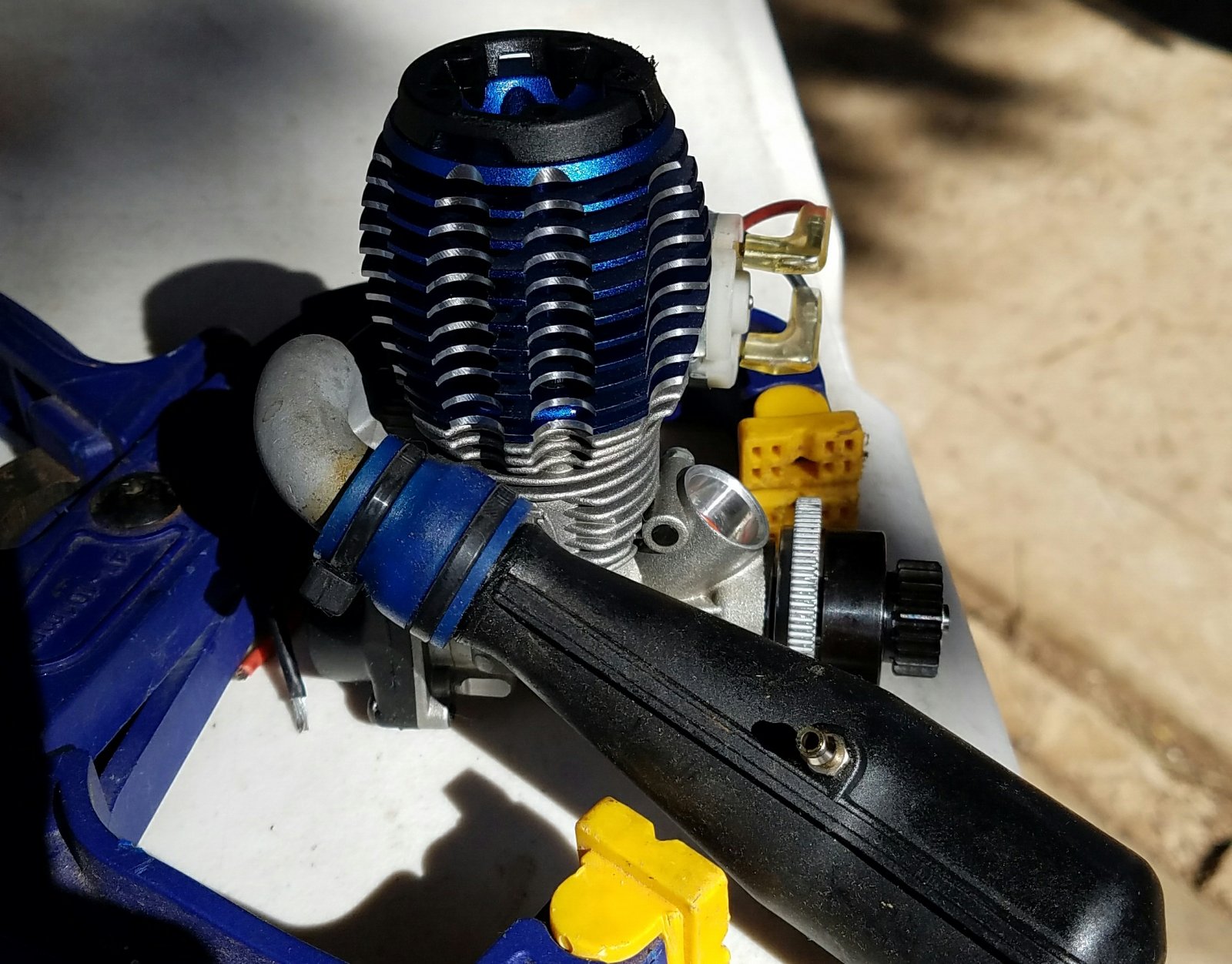

Not much airplane related stuff the past few nights, but last night and tonight I tackled this Traxxas T-Maxx TRX2.5 engine. It was stuck from what I'm assuming was a bunch of gunk inside and not having been ran for years. Tore it down, stuck the case, crank, and piston assembly into a cup of nitro fuel and let it sit overnight. It must have worked because it didn't take much to free it up come this morning :)
I test fired the engine on the bench and it roared to life so back in the truck it went.
Discovered that the fuel inlet assembly on the carb has stripped out from the carb, causing a big leak. Tried to seal it with some red RTV but to no luck, a new carb is only 30 bucks though. I think I'm also going to buy a new EZ Start box, I got the truck for free so if it only costs 50 bucks to get it back to 100% then I'm all for that!

I use air tool oil for all nitro engines , just a small squirt and flip it over a couple of time and your good for years .
Nitro engine are prone to have bearings go bad , the nitro fuel thats in the crankcase draws moisture towards to and then bearing issues start.:oblong:

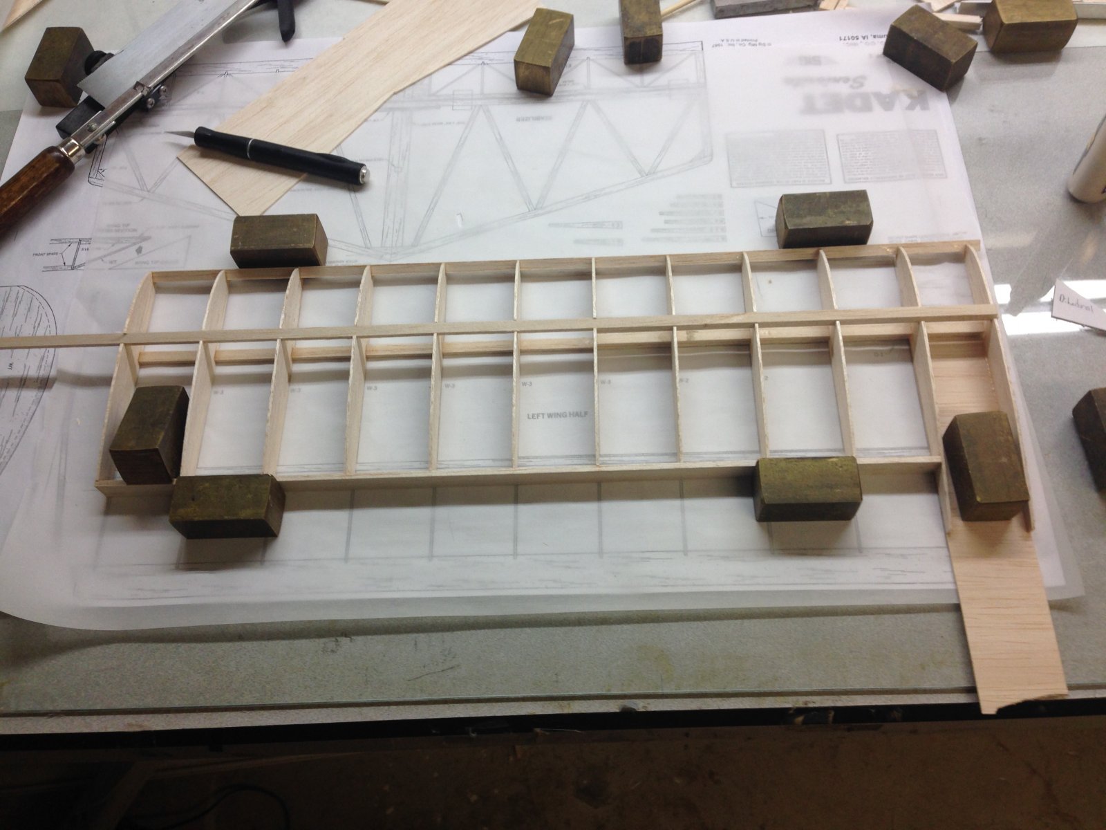

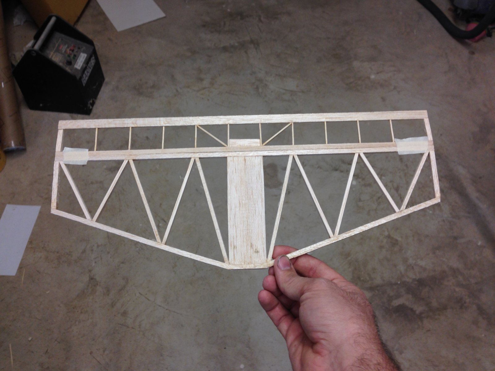

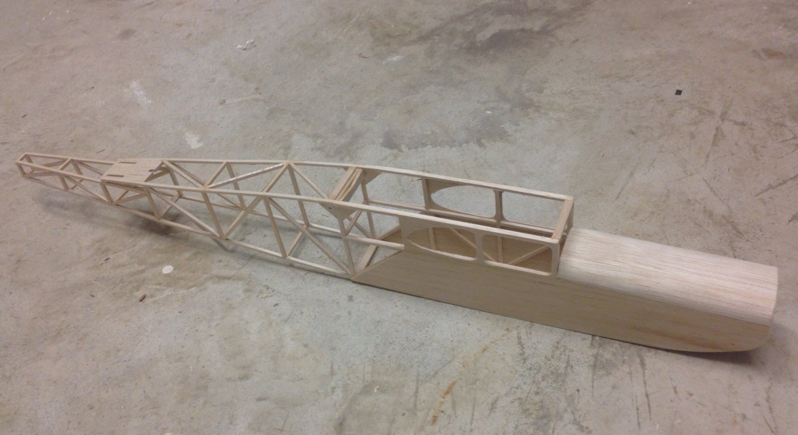

Building a 66% Senoirita. Comes out to a 44" span and ubber light weight. Fuse as it sets in the picture is 1.23oz. Will get a blue wonder setup.
Been fun building it but takes a little time. All framework in the fuse is 1/8" square sticks so I'm using wood glue over ca as ca will wick into the wood to much and make the wood itself brittle
