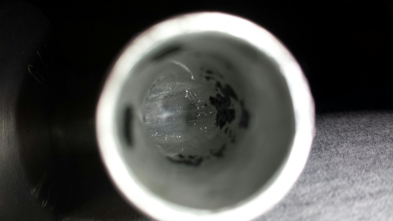

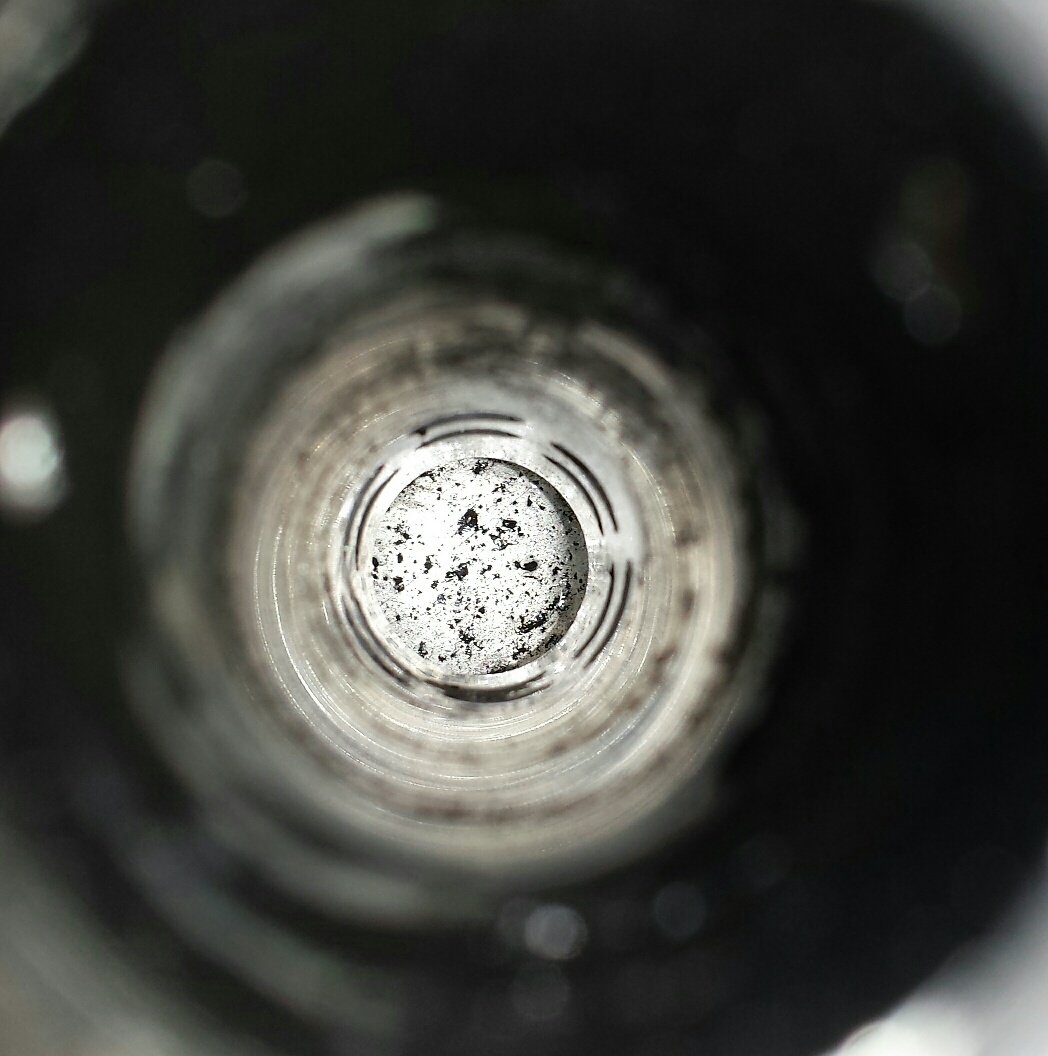

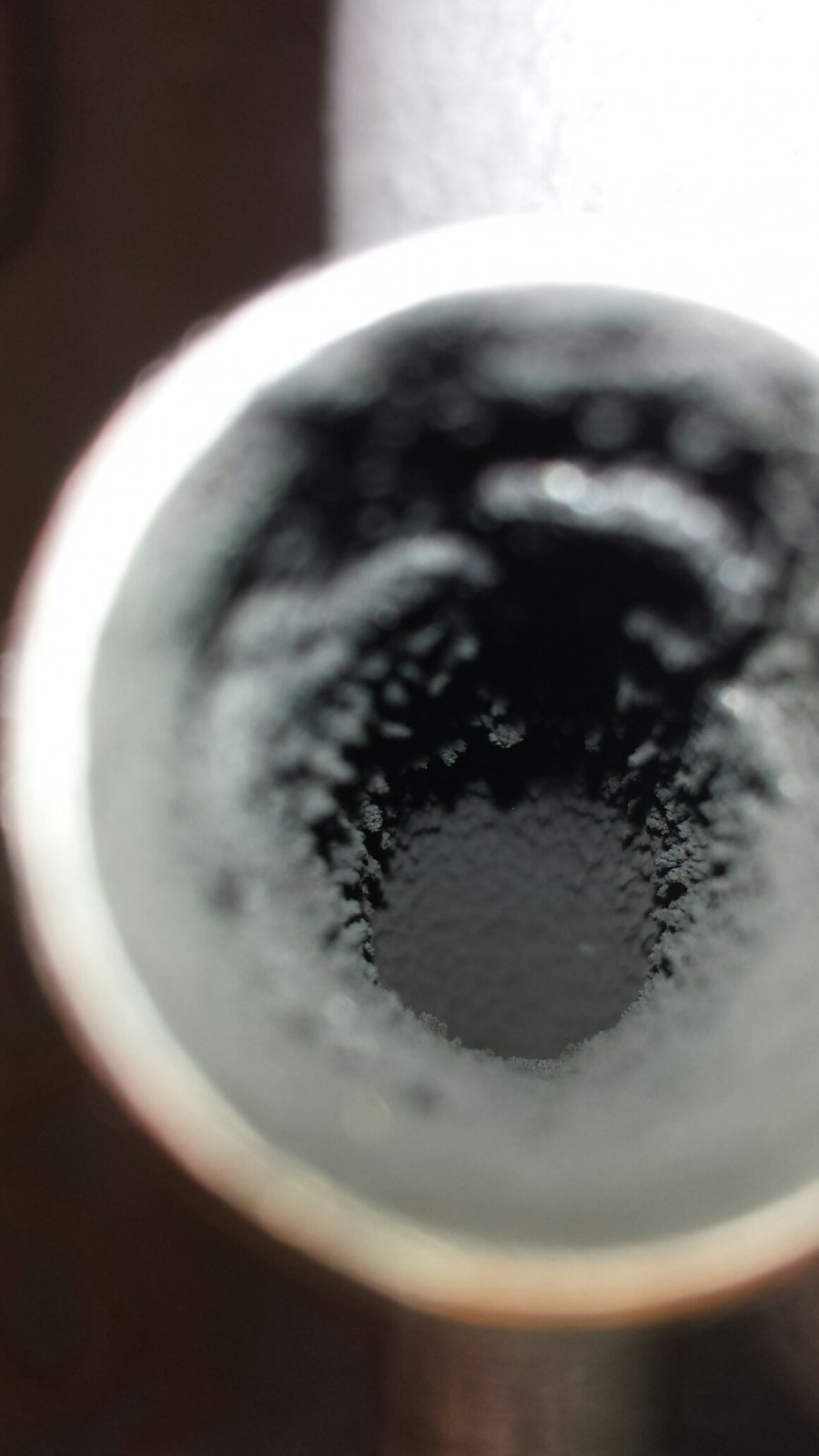

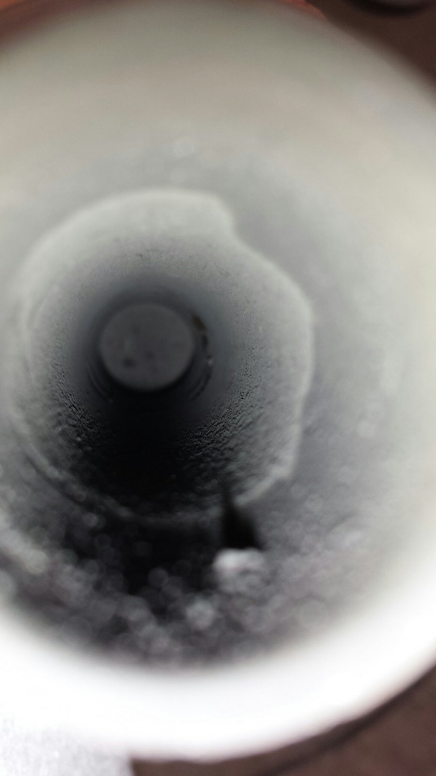

With the disappointing performance after swapping a GP61 into my Pilot Edge I decided the canister might be clogged so I went through the process of cleaning it this week. After reading a post by @Robotech I decided to use Berryman Chem-Dip carb and parts cleaner. I capped the Stinger end and filled it with the cleaner. I let it sit a few days and emptied it and rinsed it with water, then blew it out with compressed air. I got a lot of chunks of carbon out, but realized that when I filled it I should have tilted it back and forth to make sure all the blocked areas actually filled.
When draining the water out I could tell it was still somewhat clogged because I couldn't get all the water out of it without shaking while blowing 150psi air through it. And even then it took a long time.
Thursday night I refilled it with the Berryman, this time tilting it back and forth to make sure all the chambers were full. Then Friday night I drained and rinsed it again. I didn't get a lot of chunks this time, but the cleaner was black as tar. When rinsing it this time I could easily get all the water out of it by blowing air in the inlet. It seems to me to be pretty open inside now.
Last night I installed it on the airplane and today I'll test run it and see if it helped.
Inlet before and after. I think a longer soak would really get make it spotless.
View attachment 89133 View attachment 89134
Outlet before and after.
View attachment 89135 View attachment 89136
That's awesome dude. Looks great. Any chance you got a before and after weight? That would be interesting.
I test ran the GP61 today, and I think cleaning the canister did the trick. I had a 500+ RPM pickup over last Sunday. Tomorrow will tell the tale. It's supposed to be in the low 70's and almost no wind. Not much sunshine but great weather otherwise. Time for a test flight!
Looks like you have it fixed. While reading about the process and the difficulty with chambers makes it difficult to clean. We know that heat will help the process but my thought is if the pipe is standing up and you connected a compressed air line the bottom and allowed the air to bubble up through the the pipe gently so that the solution get agitated. Do you think that would help.
