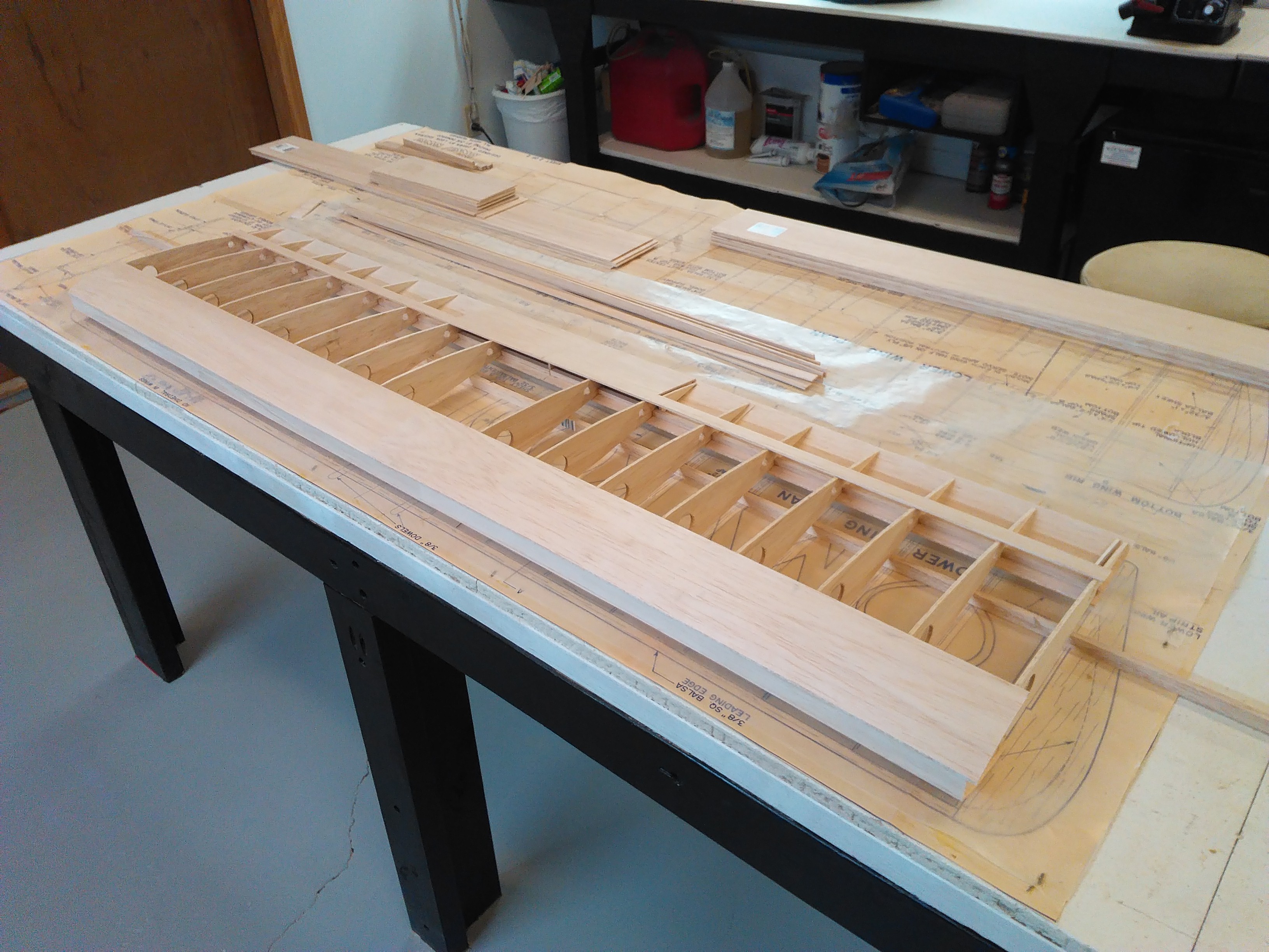

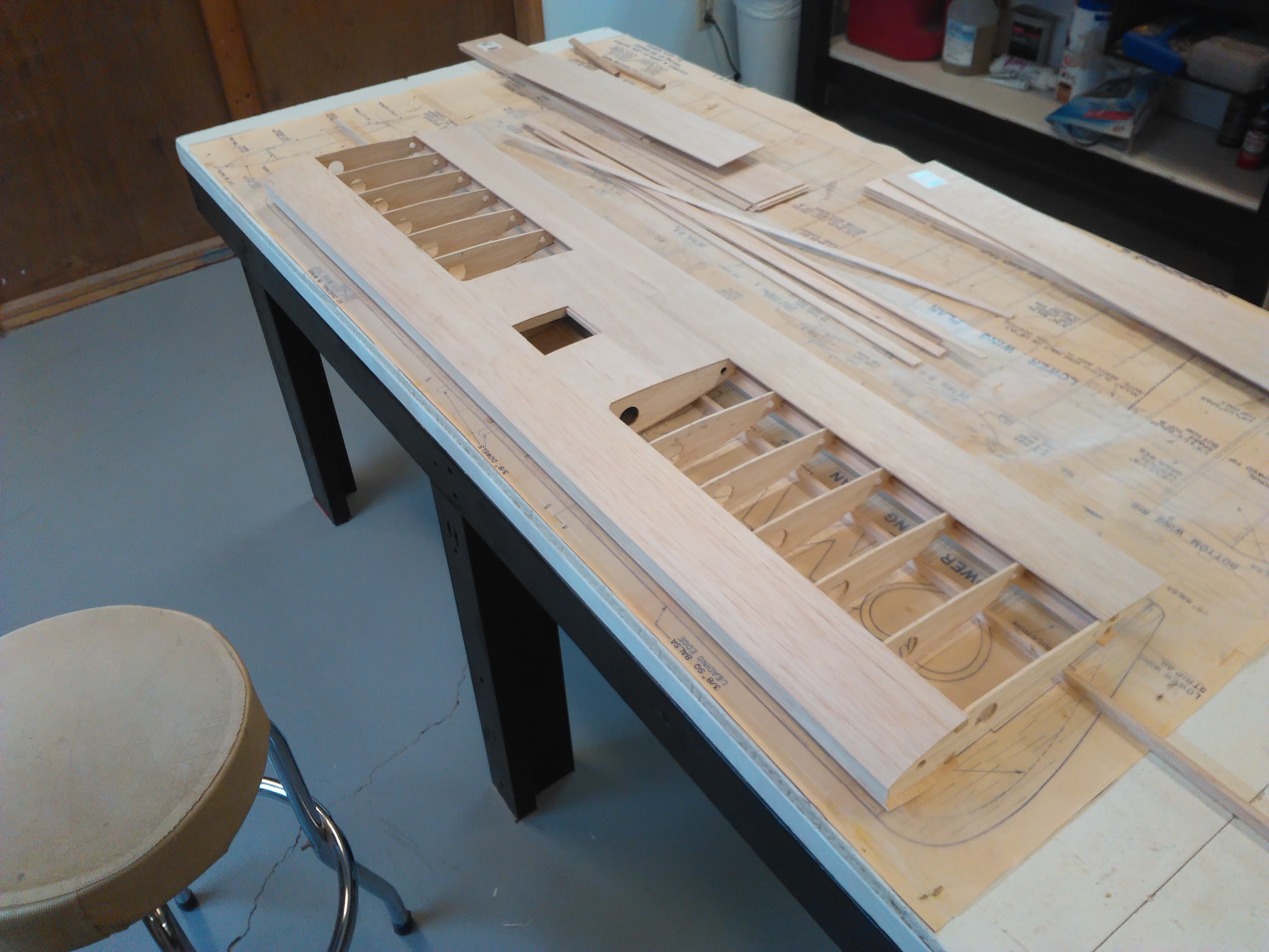

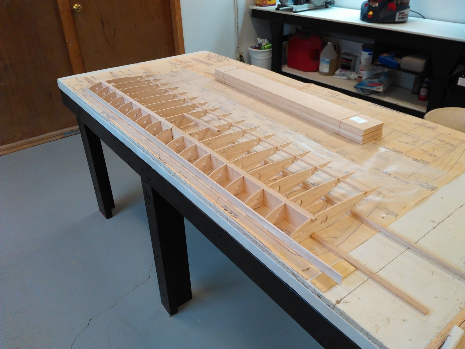

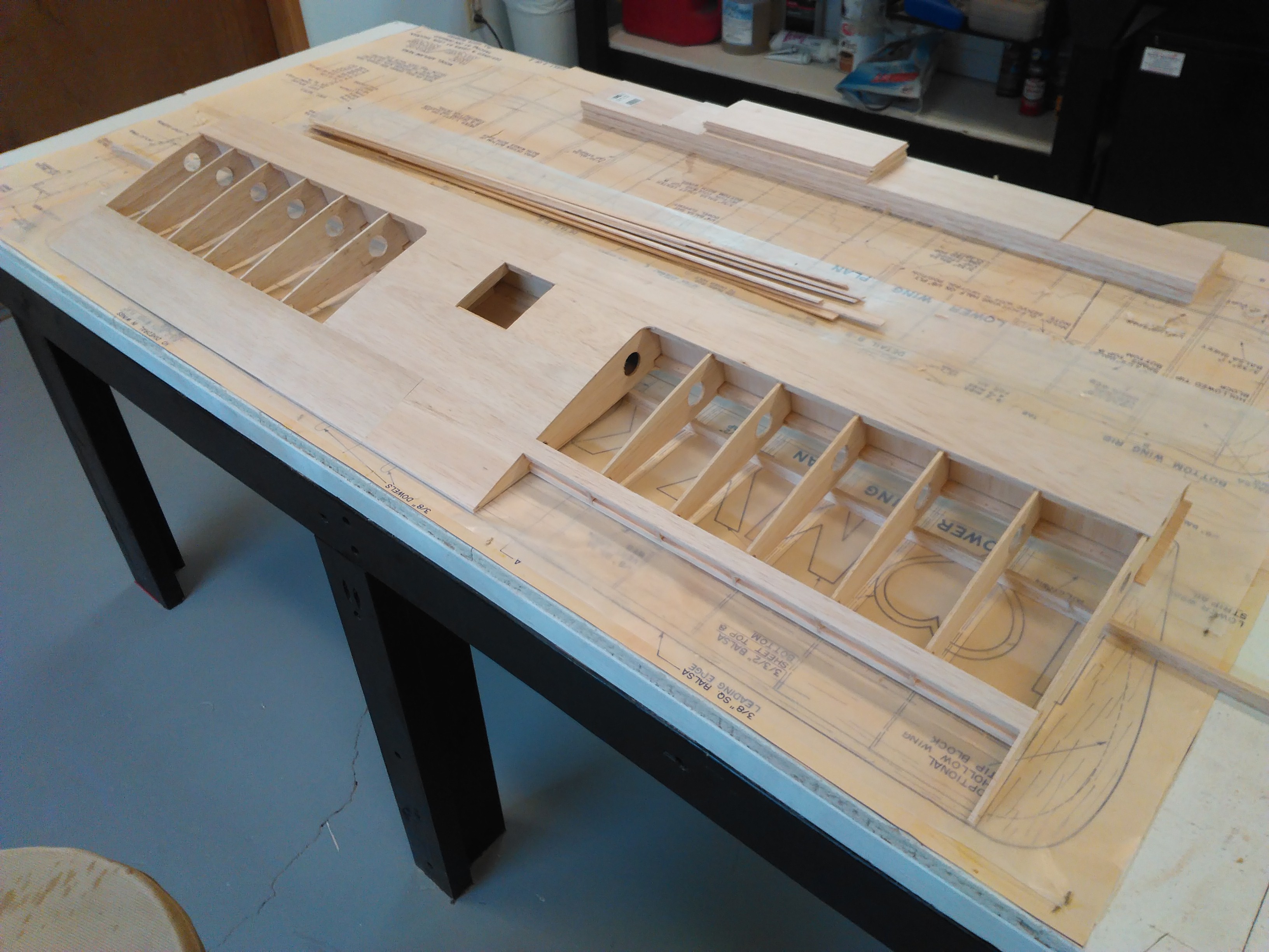

The bottom wing has been progressing slowly the last few days (I've been dealing with a pulled muscle in my shoulder).

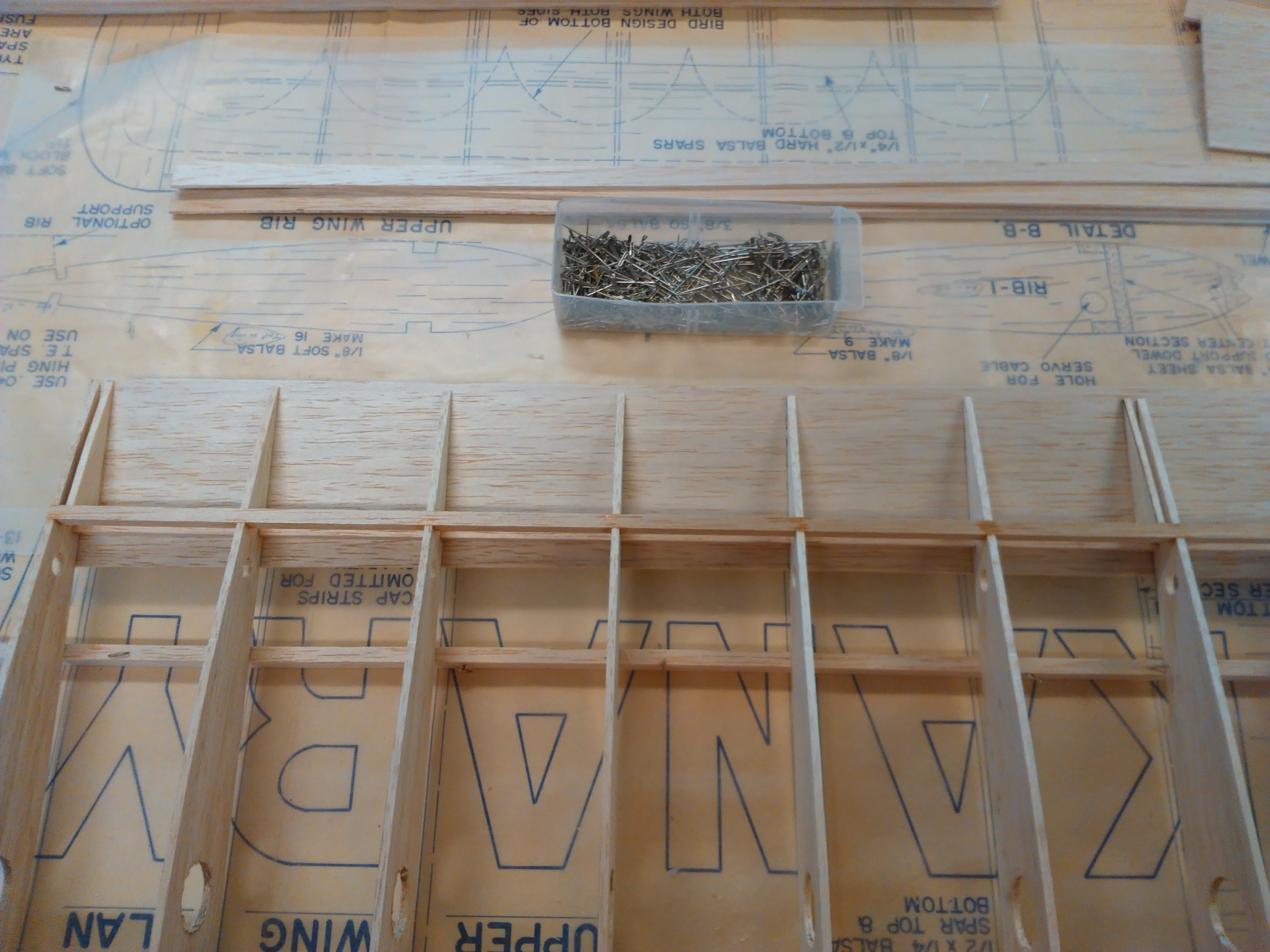

One of the changes I made is the rear spar, the plans called for a single larger top spar with no bottom and had it moved further aft.  I changed it so both top and bottom wings have two 1/4" sq. Spars at the same location.  This also will increase the cord of the aileron by an inch, giving me 16 sq/in more aileron surface combined.
Full span shear webs, the middle shear web is made from 1/8" lite ply.
Top 3/32" sheeting is on.  Here is another change I made, the plans showed a 5/16" sq. Stick on its side (like a diamond) as the leading edge.  I changed that to a flat nosed rib, with a 1/8" sub leading edge, and after sheeting is complete I will glue on a 3/8" leading edge cap.  This creates a stair step for the sheeting to sit on, and also makes the leading edge laminated which is stronger.
