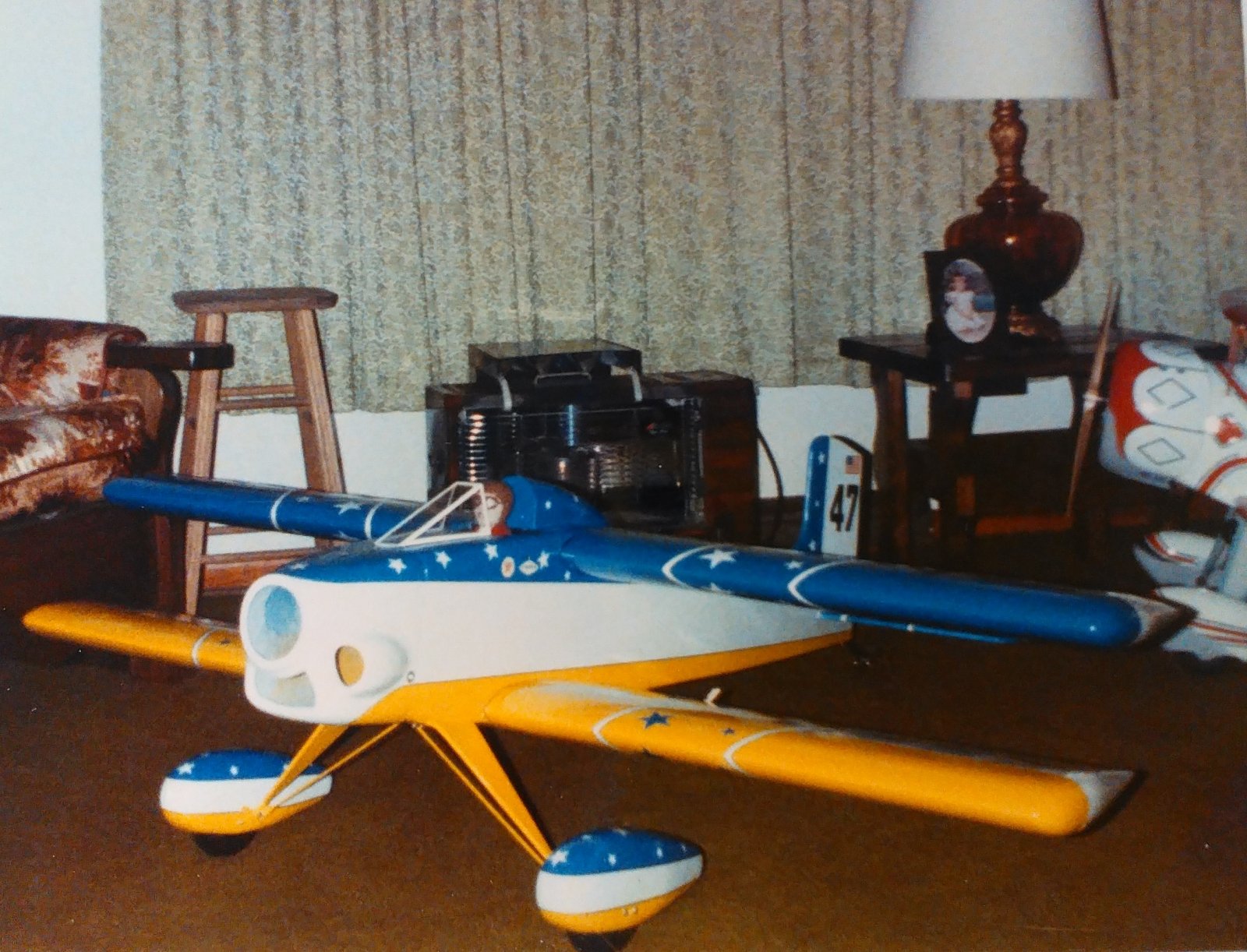

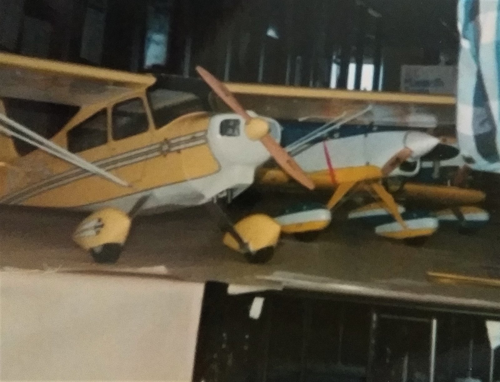

    Here are a few pictures of Grampa's Kanary. Just like the Krier Kraft, I'll be copying his pretty closely.

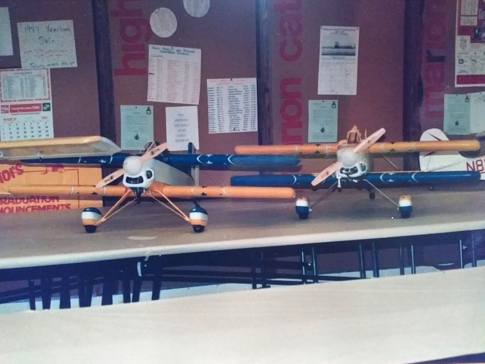

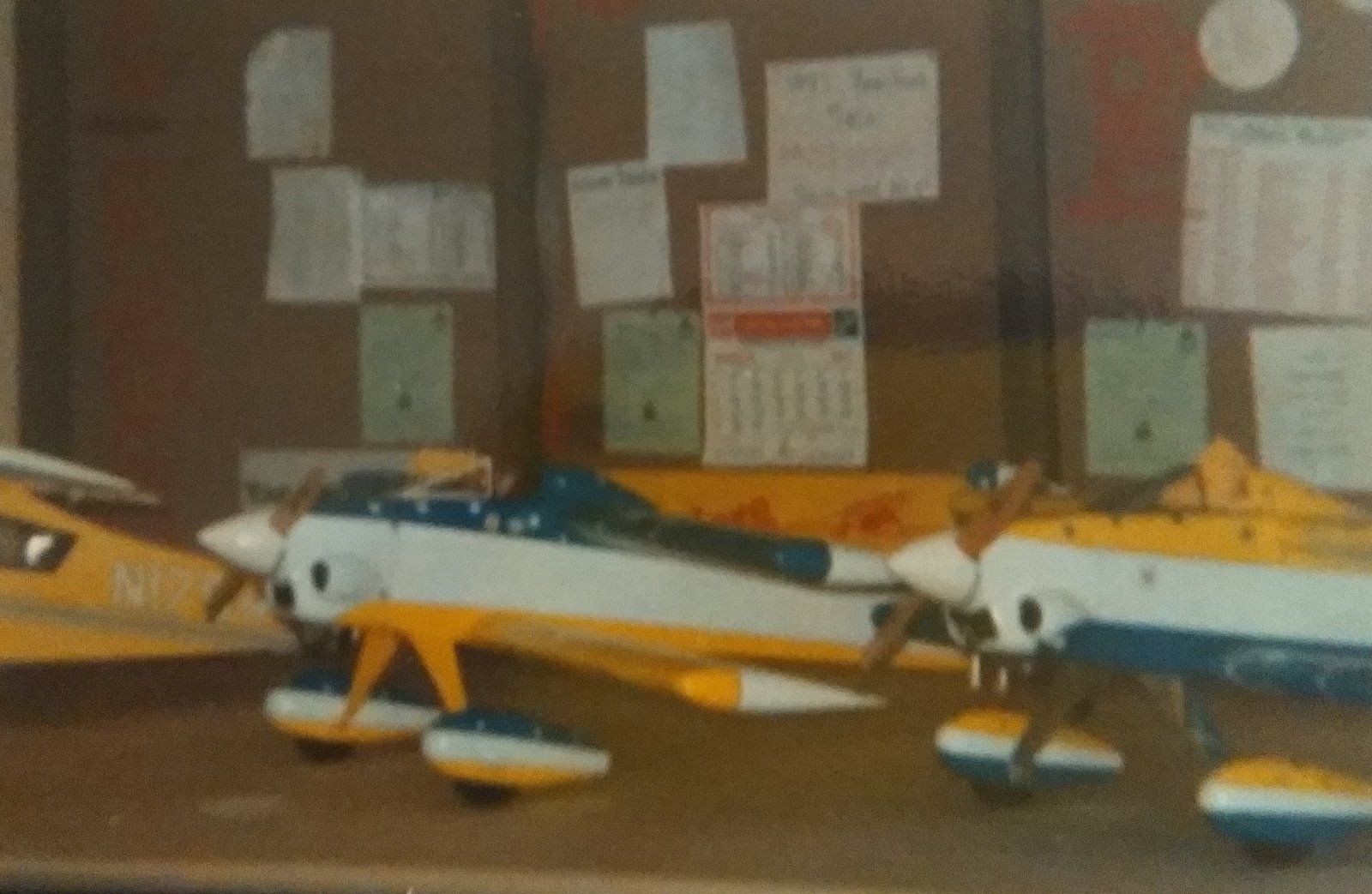

    Most all of the pictures we have of the Kanary were from before it was finished. The only completed pictures we have of it were from the Winter Model Show his club had at the local JVS.
    At that show, grampa's and his buddy's Hot Kanarys. His friends paint scheme was exactly the opposite of his. And the Bud Nosen Citabria behind them was my dad's. My dad's Citabira won a trophy at that show, and he thinks he can't build :)

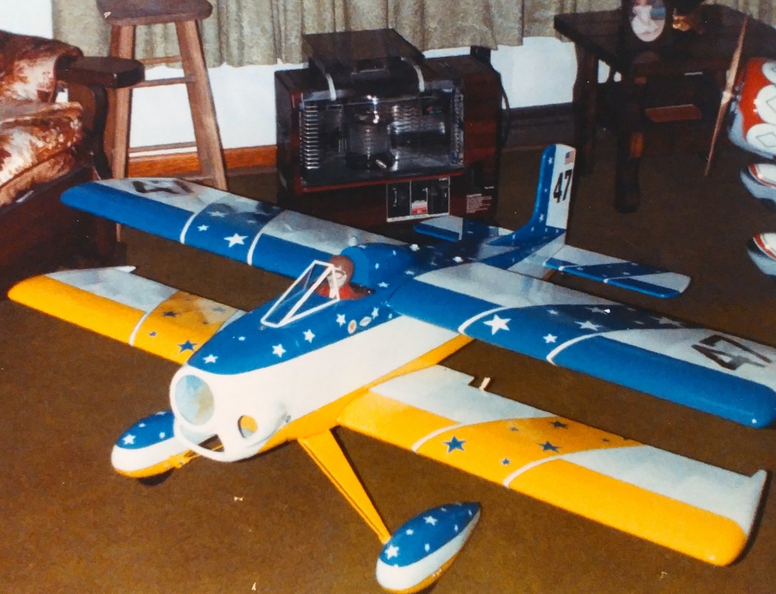

  3. Here's a couple more pictures of Grampa's at the club show. These pretty much represent the only pictures we have of his Kanary.
    So now some info on the airplane. While it is meant for a 35cc engine it is a rather small airplane with a wing span of only 56 inches, the full scale Warwick Hot Canary only had a 16 foot span which makes this 30% scale. The Fuse length is 61 inches and should have a 1.8 glow to up to a 50cc gas. Now I can't imagine anyone bolting a 50cc to the front of this thing but Grampa's had a Q35, and since we still have 2 Q35's on the shelf (ones dad got while I was building the Krier Kraft) mine will have one too.

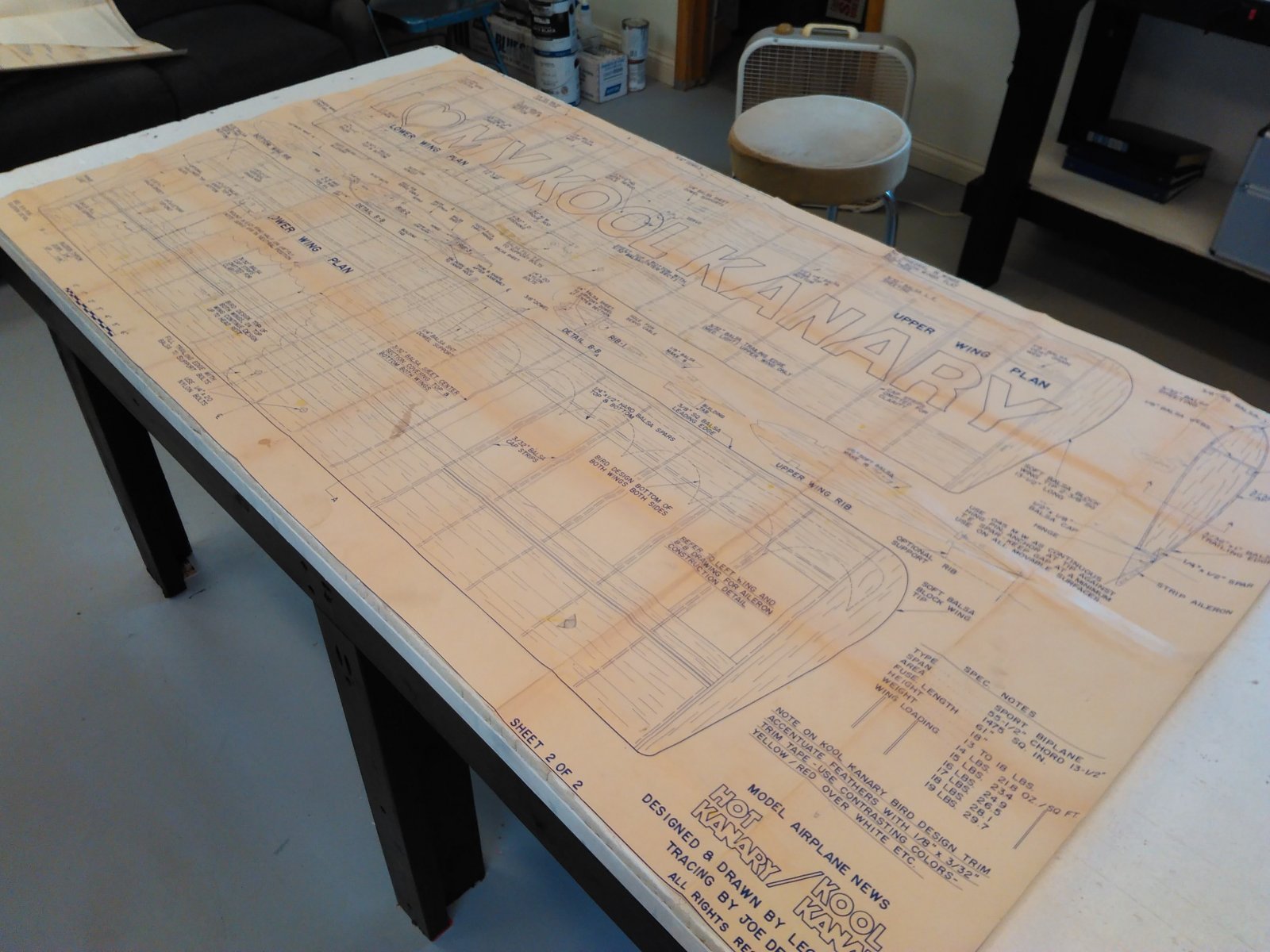

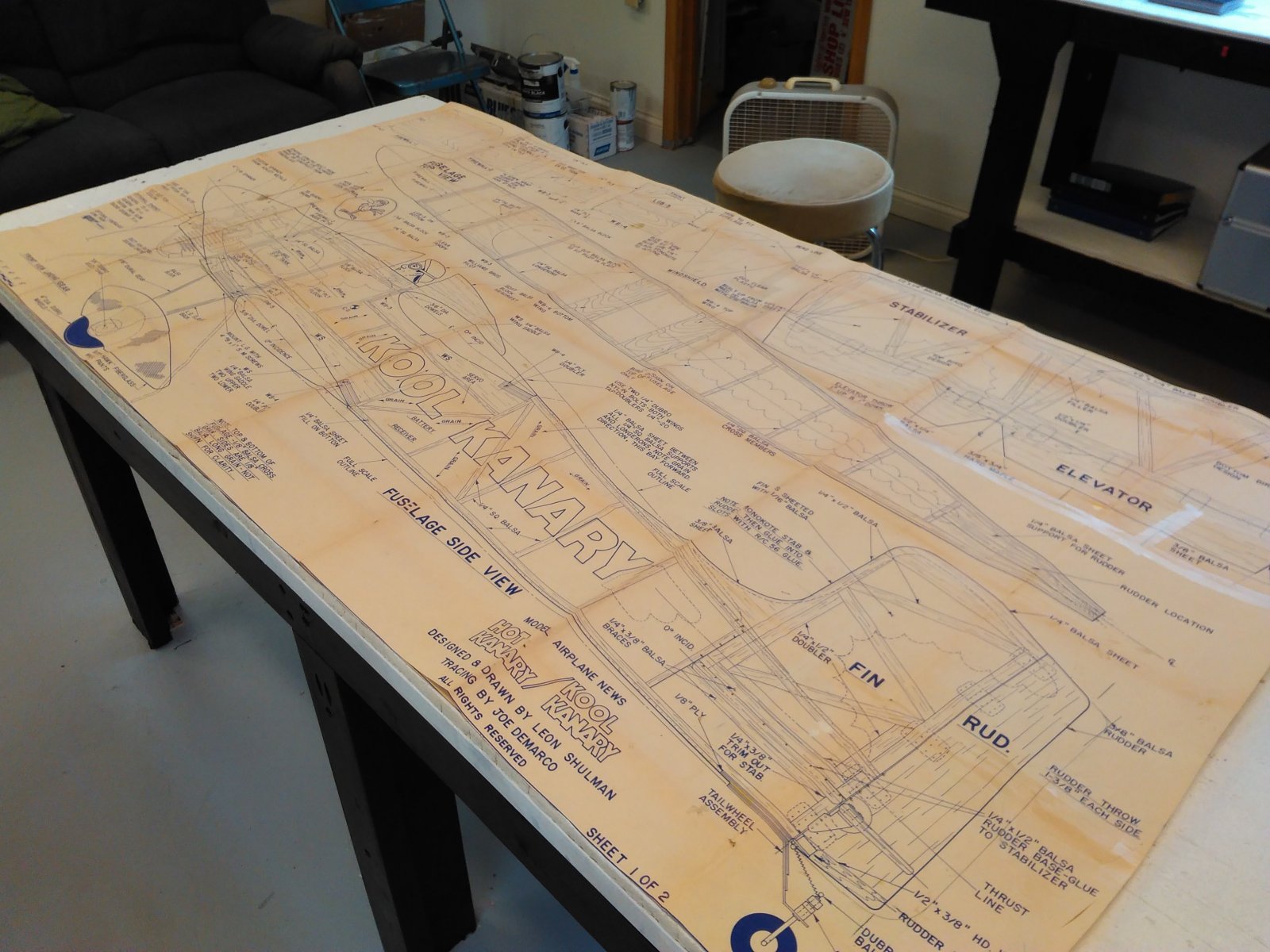

    Now I'm not going to redesign this airplane like I did the Krier Kraft, but I'm also not going to build it 100% according to the plans either. I will describe the changes I'm making as I get to them for those that might want to give building one a go for themselves. Most of my changes will be removing weight and simplifying construction a bit, as well as a little bit of an outline change to make Grampa's cowl fit. Luckily he drew most of his changes on his plans which are the same plans I'm building from.

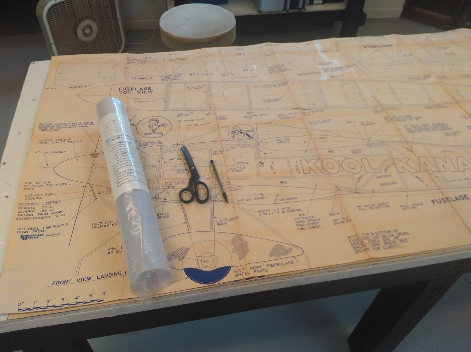

    The plans have some mileage on them, but no sense in buying another set. Besides, it will be fun to build off of the same prints that grampa and his friend Brad did!

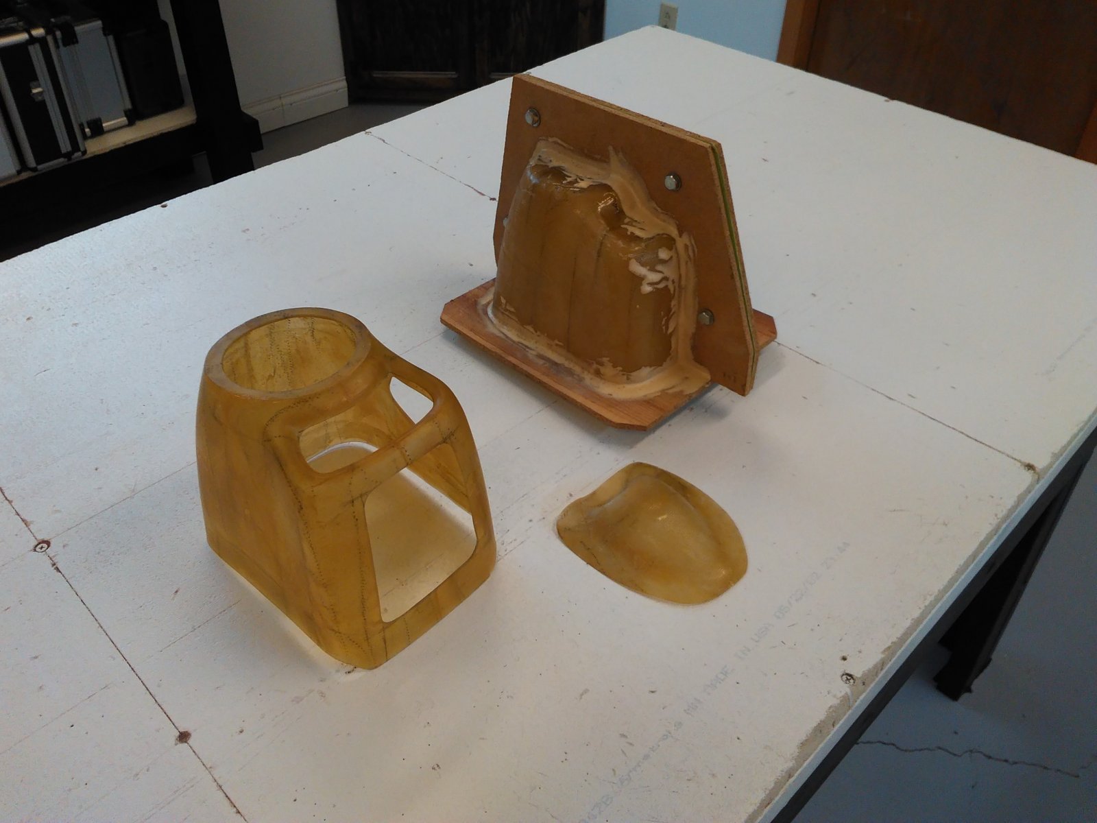

    The cowl mold and the carb scoop mold, plus a cowl that was in the mold when I got it.

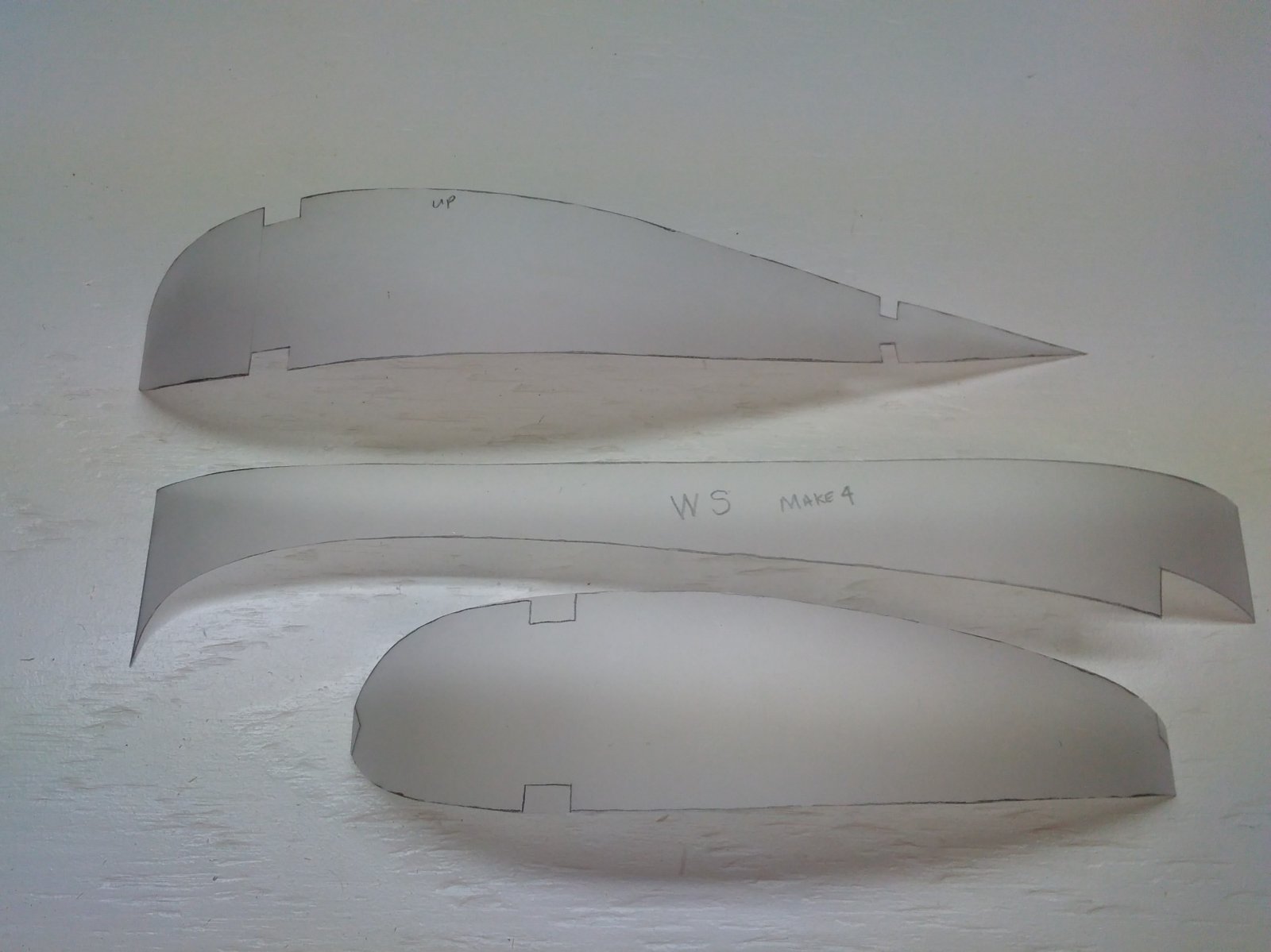

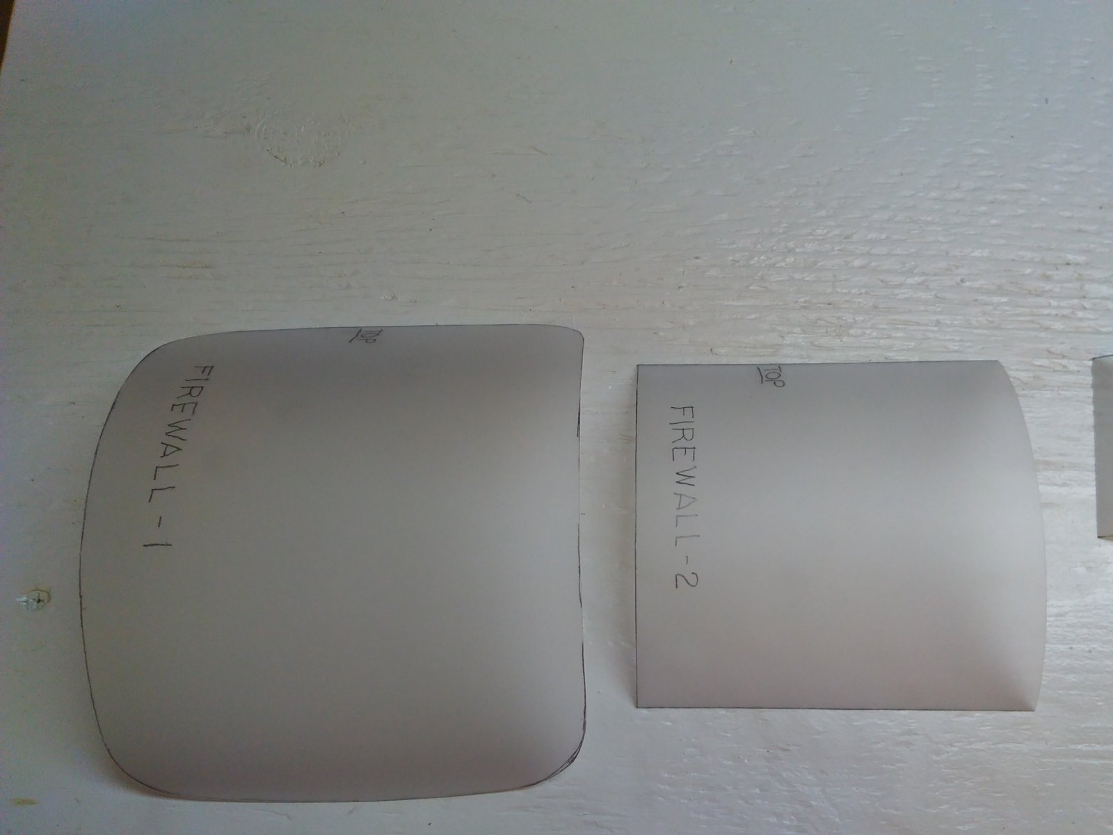

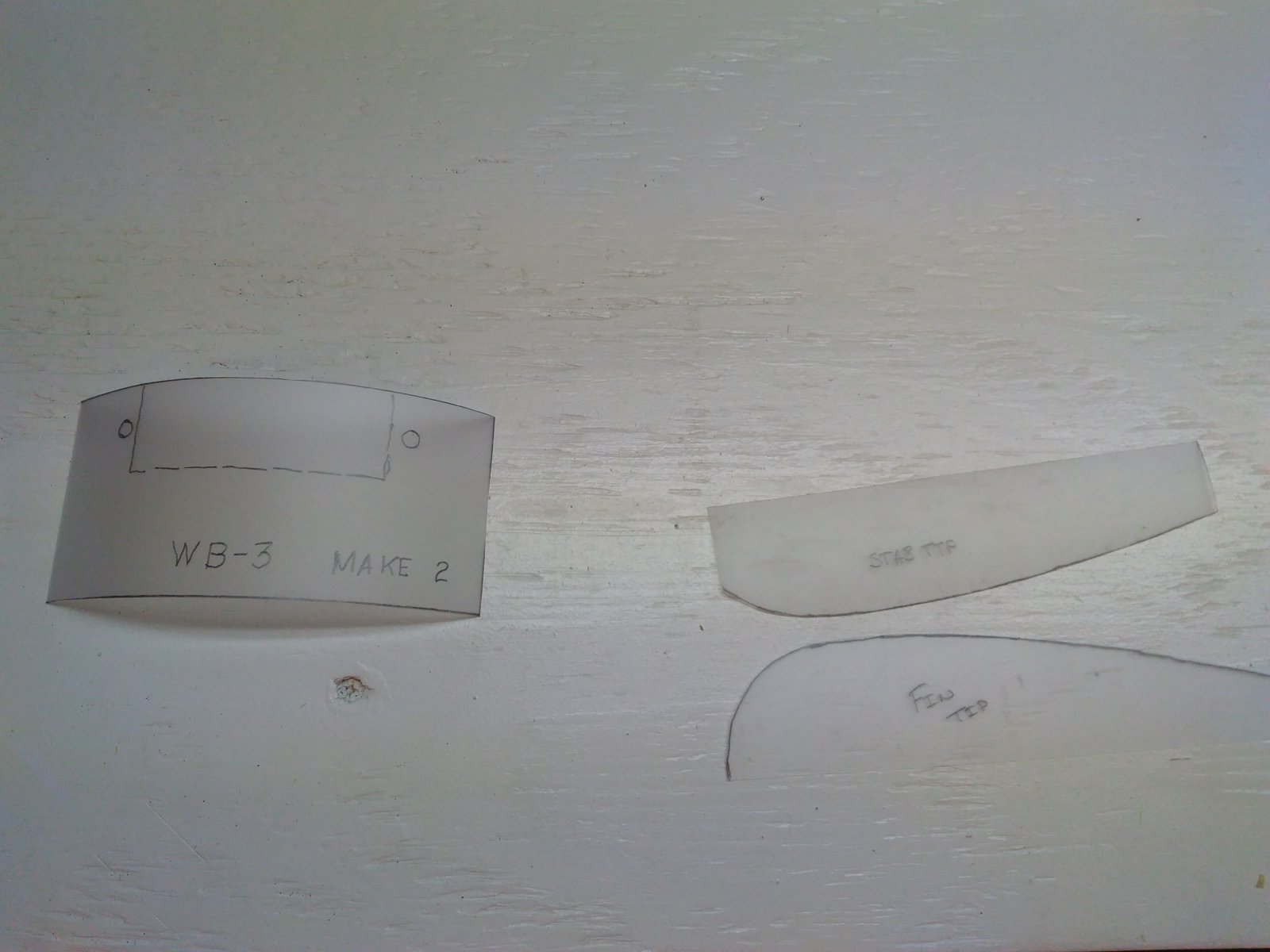

    Time to start making templates. Once again I'm using the See Temp material, good thing there wasn't many templates to make because my roll is starting to get pretty thin! lol
    Templates traced and cut out. This is the first change made over the plans, The bottom of the firewall (F-1) was extended almost 1/2" to fit grampa's cowling. the bottom of the fuse aft of the bottom wing saddle will also be lowered a small amount making a straight line from the firewall to the tail post. This will make construction a bit easier as well as give it the same sleek look Grampa and Brad's Kanary's had.

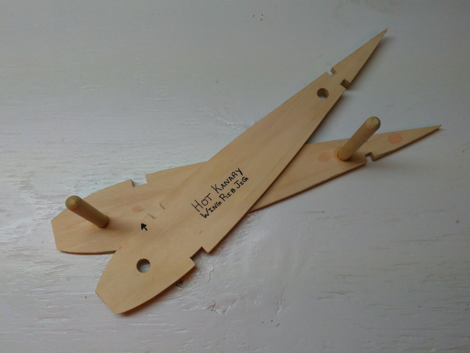

    And my wing rib jig is made, there are only 32 ribs which is nothing compared to the 50+ that are in the Krier. Here is also the second change made to the plans. The plans have 2 different wing drawings, bottom strip ailerons only and 4 barn door ailerons. I'm doing bottoms only like grampa, but with a twist. The plans depict 2 different wing ribs for bottom ailerons only, with solid tapered balsa ailerons. I am going to use the top rib through out both wings, and use the aft spars as my aileron cove. This way I can frame the wings up, and then cut the ailerons free so I will have built up ailerons. This will give me almost 8 sq/in more aileron as it will move the hinge line over 1/2" further forward. I will also be using dual aileron servos with hidden trays (like my Krier Kraft) instead of the torque tubes the plan shows.

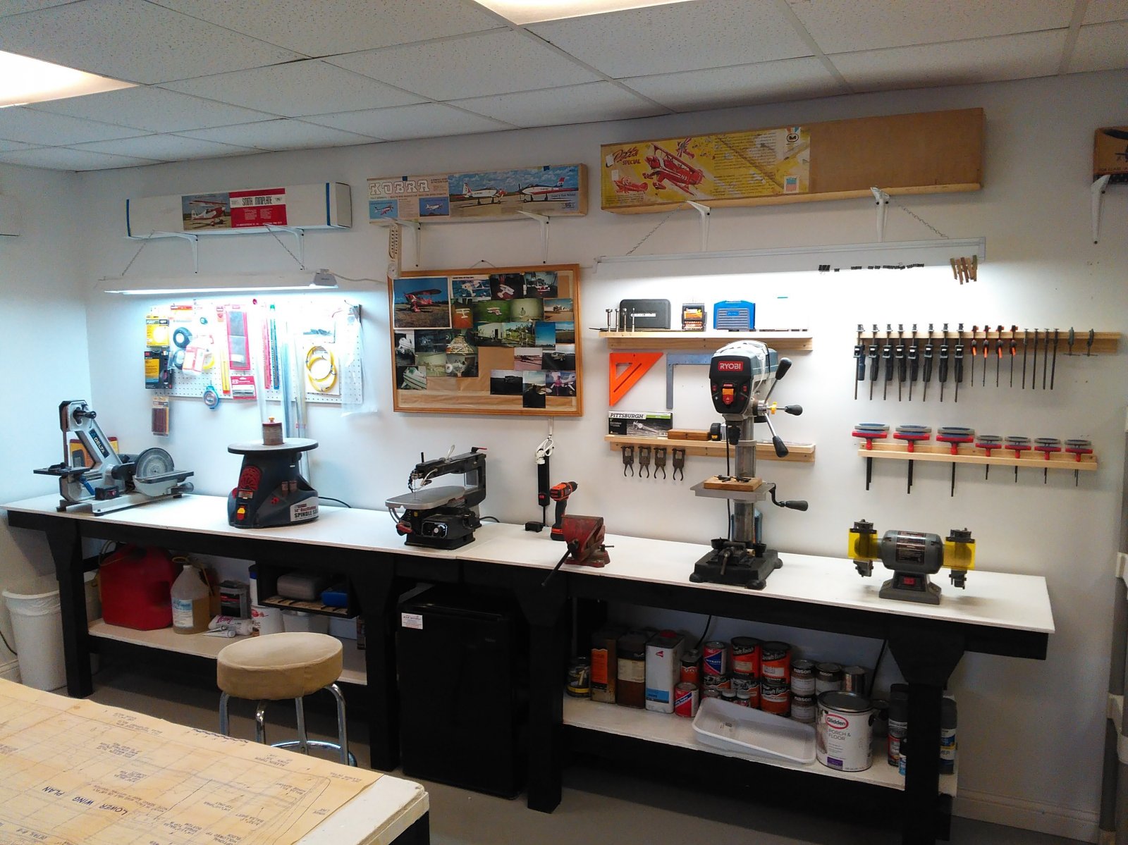

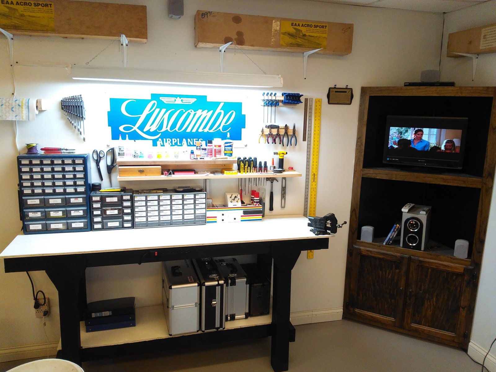

  5. Those that followed my Krier build will probably notice the shop is a bit different. Over the last couple of weeks I tore my shop apart and repainted the floors, walls, and work benches. I also built a new bench that is only 20 inches wide and did away with the old 3 foot wide bench against the far wall, this gave me more floor space. I then moved my parts bins and a lot of my hand tools over to the new bench and built a couple of shelves to hold my glues, screw drivers, files, allen drivers ect. This allowed me to spread out my power tools more, all in all I now have more work space, and that makes me happy :)
    The new bench, with the shelves for my glues and hand tools as well as another light (you cant have enough light in a shop).
    Lots more space around the power tools now, all this stuff used to be crammed on to one end of this bench! Plus I made some shelves for some more tools and hung some peg board for parts.
    I still have to finish up the small room, and clean the hangar (literally the T hangar that is outside of the double doors) so the Kanary will be a little slow moving for a couple more days.
