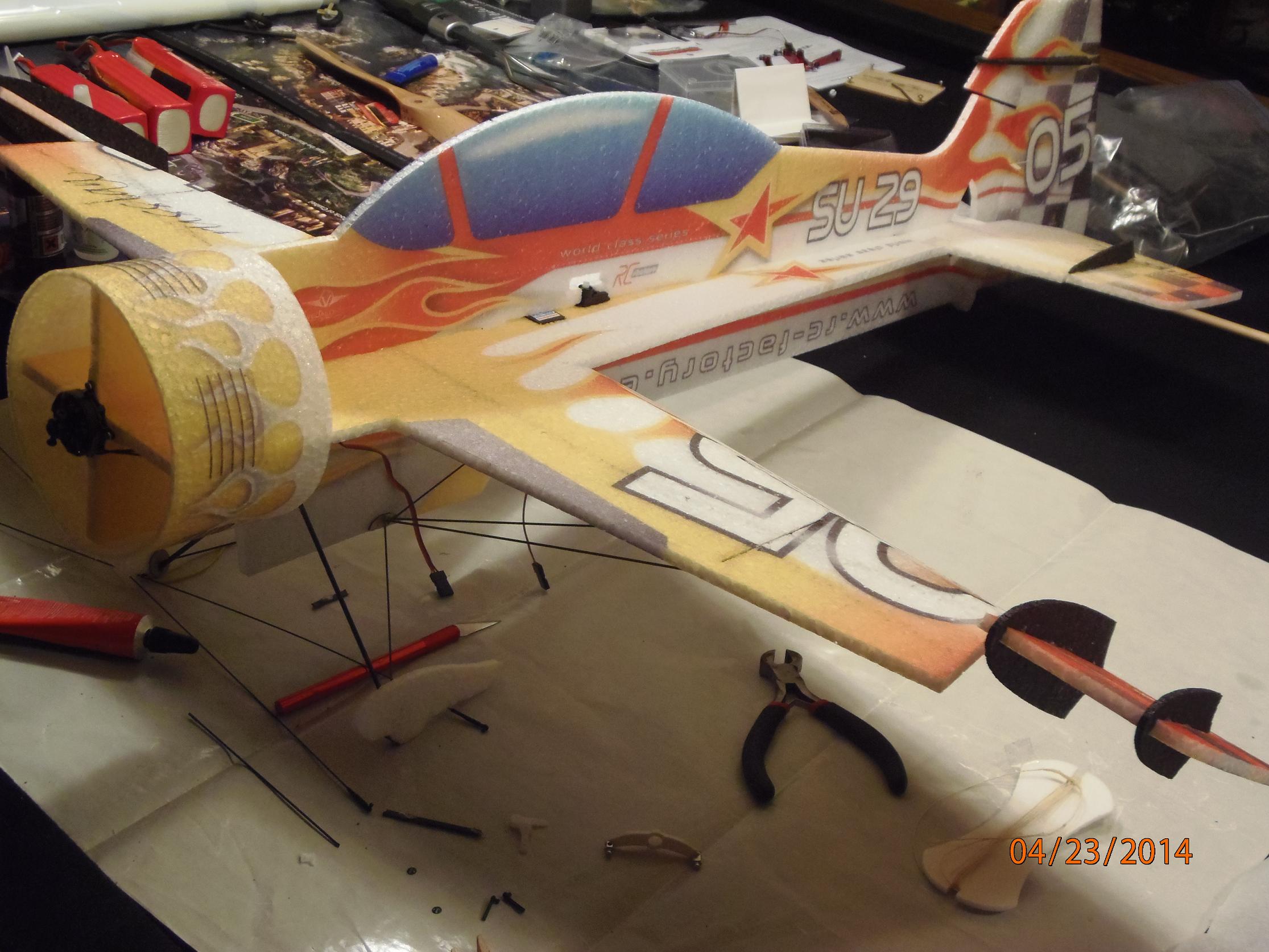

Good luck bro! Just completing an SU29 for this weekend. It's very light and looks like it will be an aerobatic monster. Stay tuned. Will open a new thread for it!

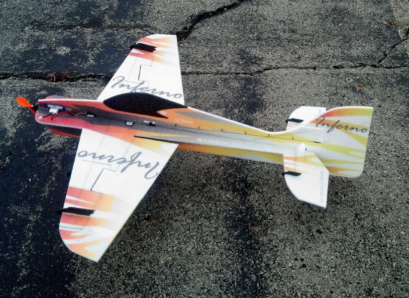

got my Inferno built and maiden flights .
Quite the floater - just got to pick my super calm mornings and just before susnset times to fly.

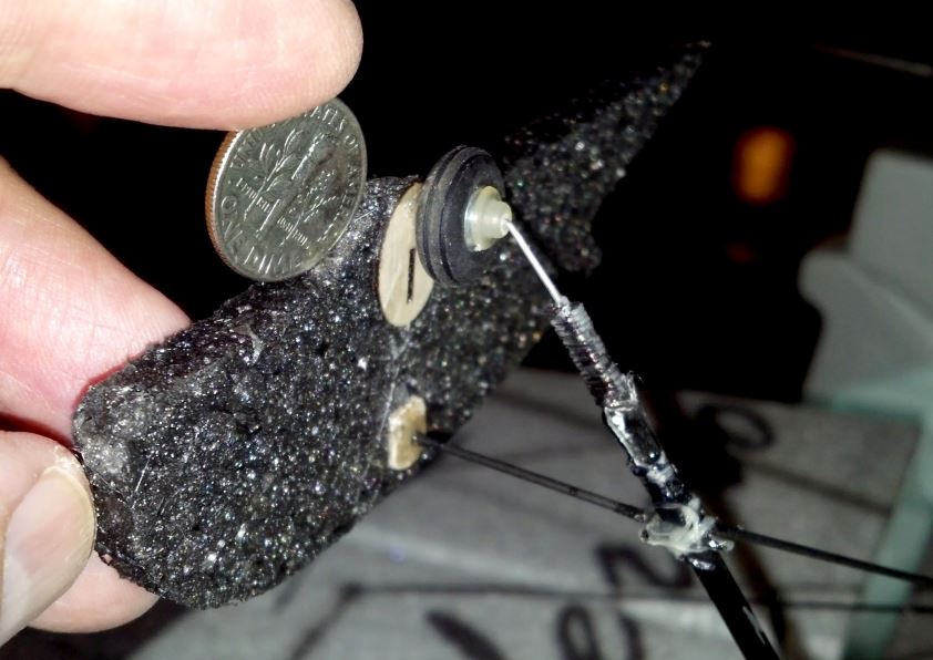

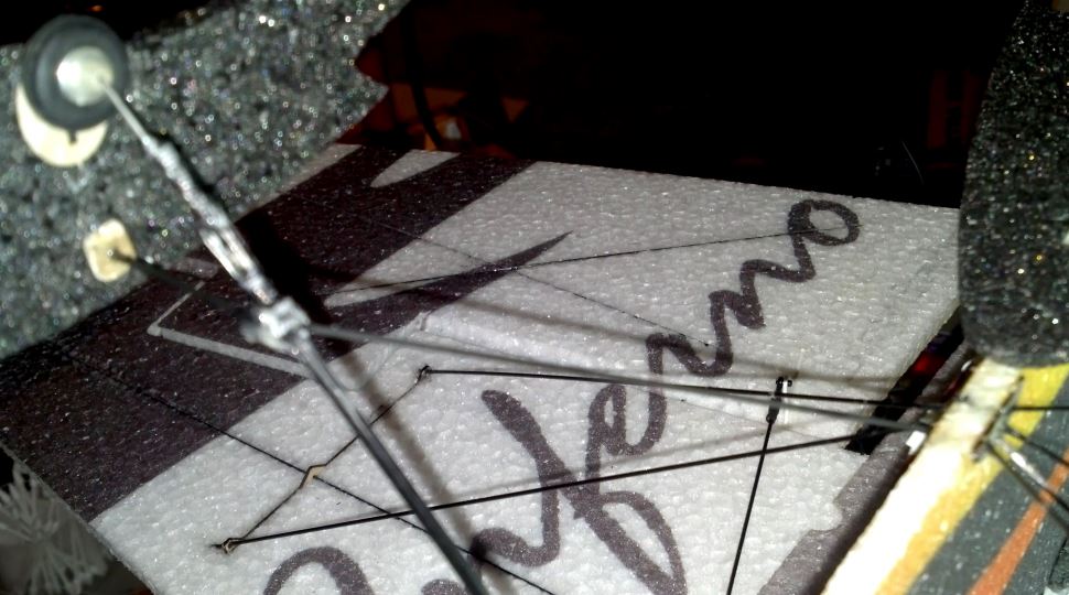

I thought about your mods, and did something similar, but with a twist.
I added 1.5MM rod between the LG and the half moon ply on the fuse to add some stiffness.
I found some very light wheels, collars and wire lg which I tied to the CF rectangular struts, then
plugged in the wheel pants outboard to all. Wheels are tiny - I used a dime to show scale -
I figure the whole set of mods cost me about 4 grams in weight - and as you noted, weight near the CG isn't too big a concern.
What do you think?
