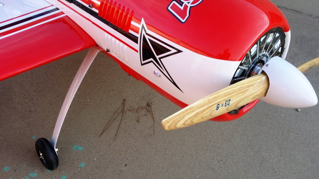

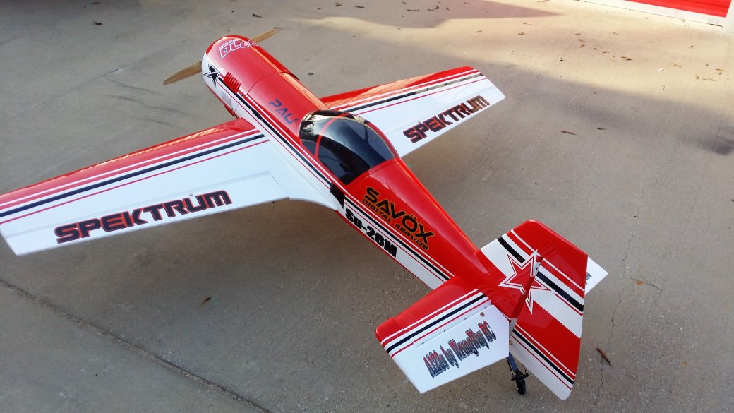

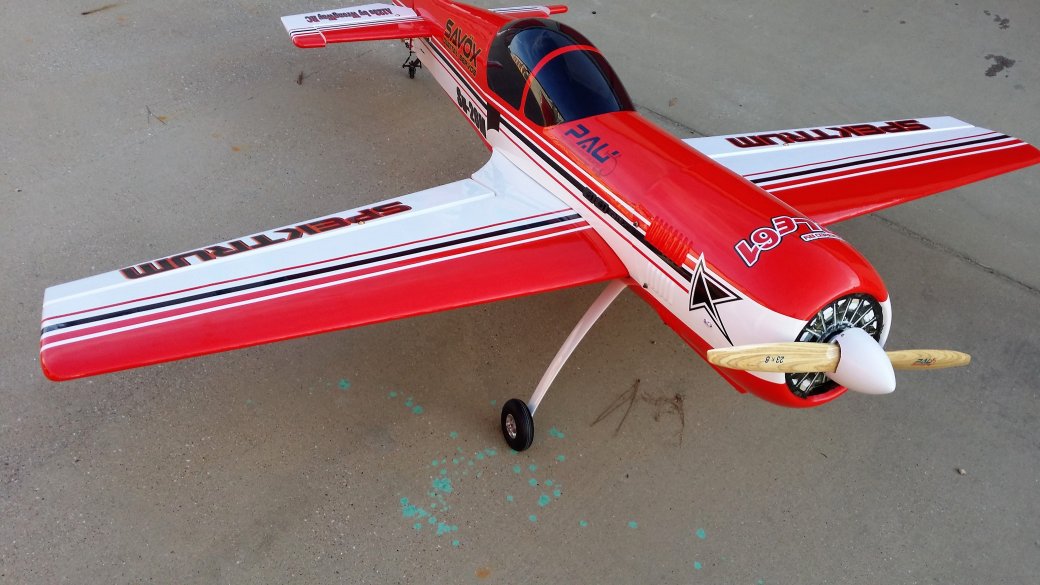

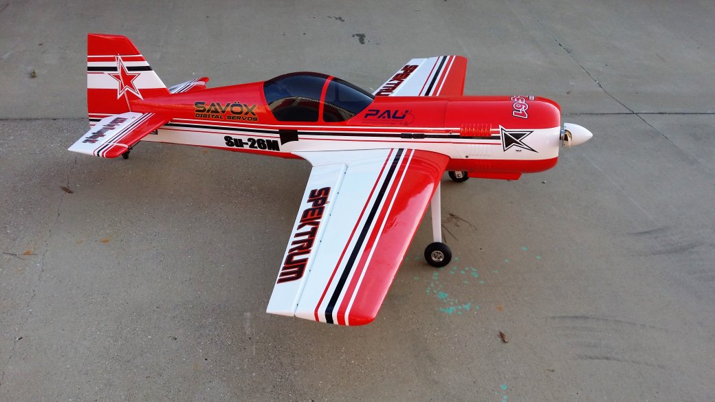

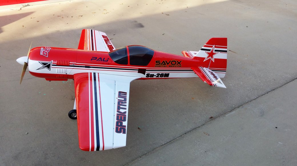

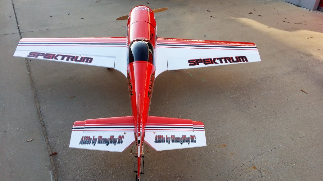

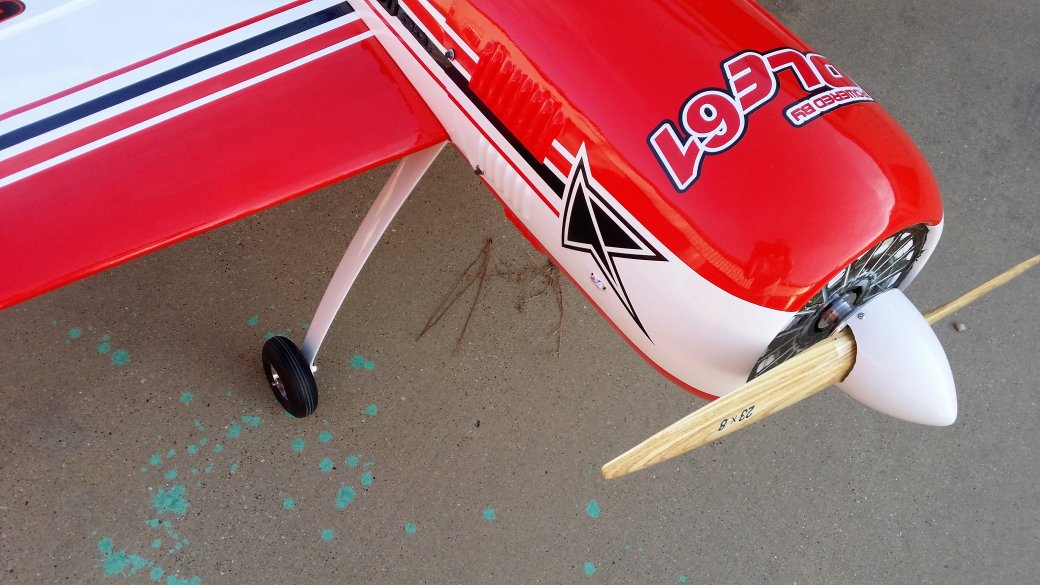

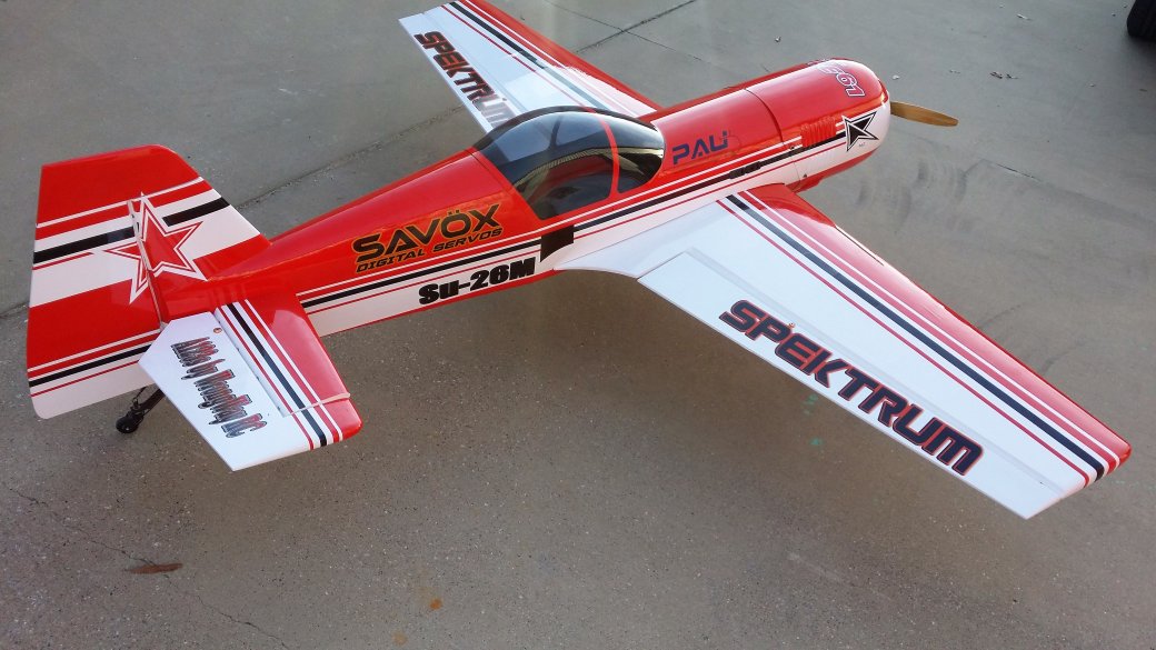

The plane is finished, I did the last of routing the wires to make it look nice and put the charging ports in. Finished it up and cranked the engine up. She cranks up so easy, but I think I may be on the lean side on the low end. When I come back to idle from wide open it takes about 10 seconds to slow all the way down. It will drop right where it should from mid range, but from WO it will come down to a high idle and after about 10 seconds it drops down to a good idle. Here are the latest pictures. Thanks everyone for the suggestions as I was going forward on the build. There are a couple of pictures of my deal with the straws in the cowl to be able to tune the engine while it is running.----Smitty
