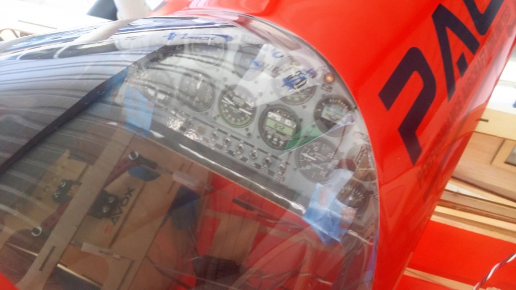

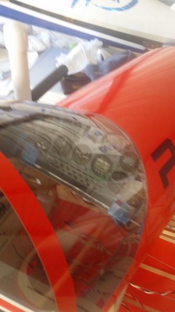

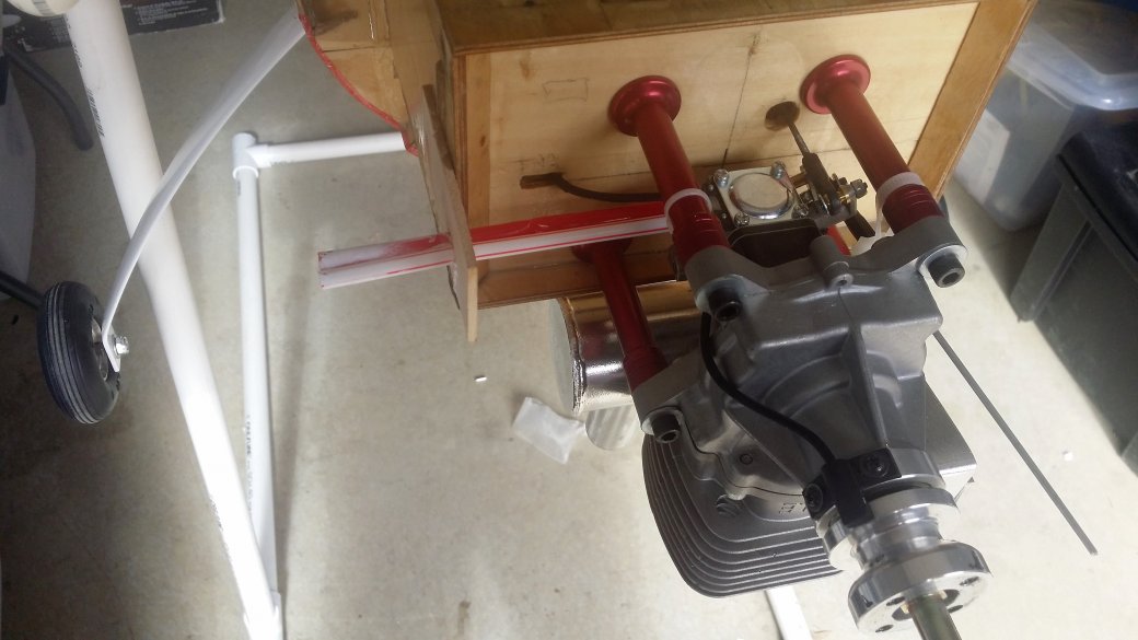

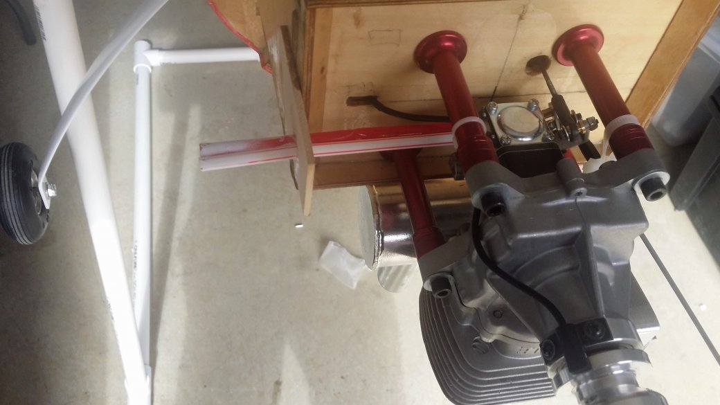

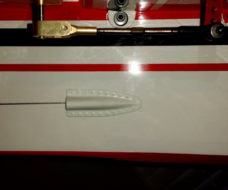

Here is a picture of the instrument panel I put in, also a little thing I do is put soda straws over the needle valve mixture screws . On this model I made a bracket to put on the firewall to support the straws. Then I make small hole in the cowl just big enough for the straws to stick through, I painted the white so they are hard to see. This way you just slide a screwdriver into the straw , feel it go into the slot on the screw and adjust while the engine is running.---Smitty

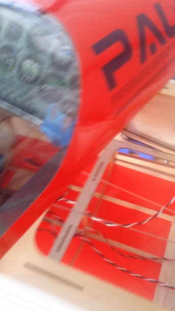

That looks good! Here is my instrument panel.--Smitty
