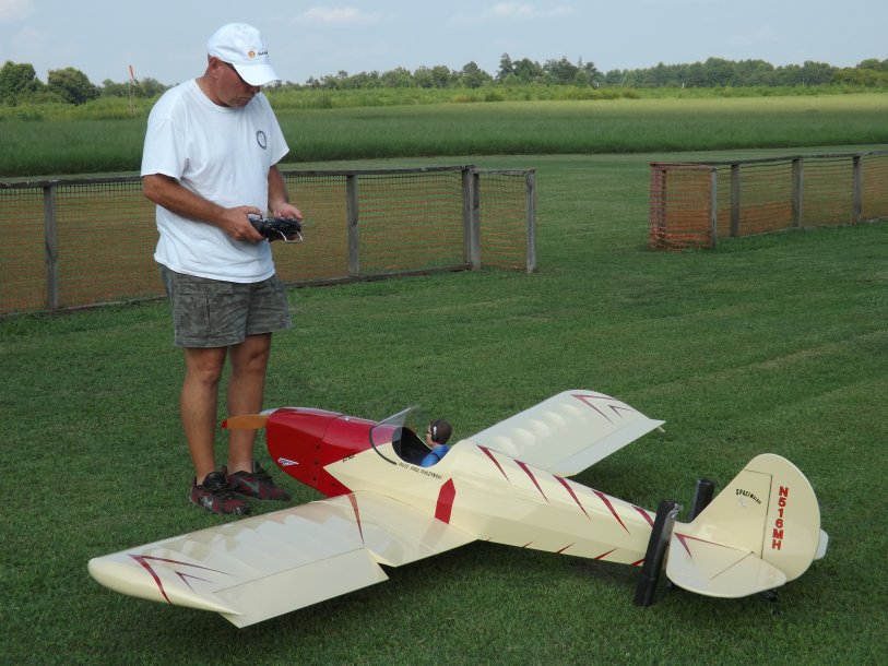

In the pic, you can see what type of restraint we use.

Like I have told you once before it has nothing to with luck or the loto. The strap I use is fine. There are many that use the same setup You use what you want I have been starting my gassers this way for over 20 years. All the people I have seen with there arms and hands cut up do all the safety items you guys are talking about. Even Our District AMA VP could tell you some stories How he stuck his hand in a few props while being SAFE.
