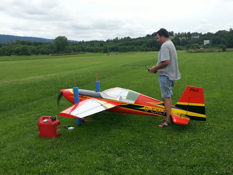

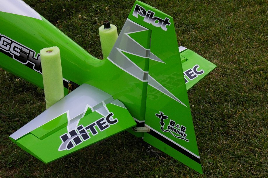

Back to the topic at hand. We use pieces of conduit driven into the ground that receive removable pieces of conduit padded with pool noodles. For larger airplanes like 40% you can space them farther apart and use them on the wings. Very easy to use and very secure.
One thing to add, if you use this method sink a small brick or something between the in the ground pipes so you can find them. Around here clover will cover those thing in a day sometimes and it makes finding them a real pain.;)
