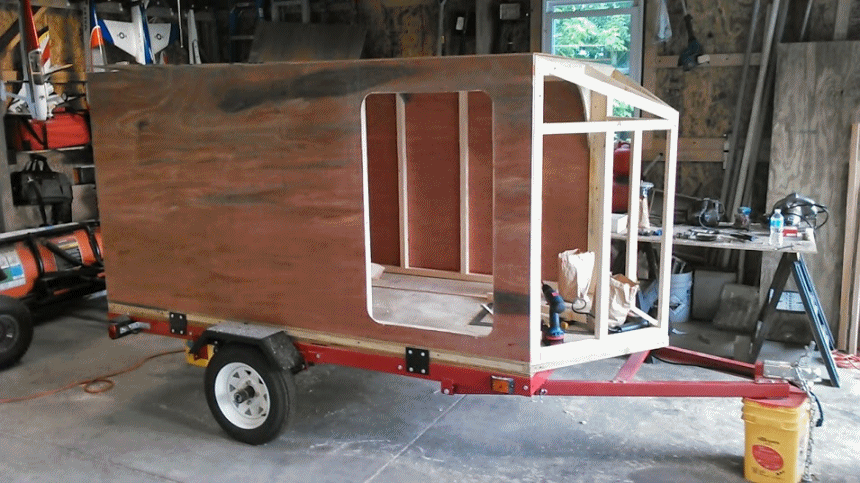

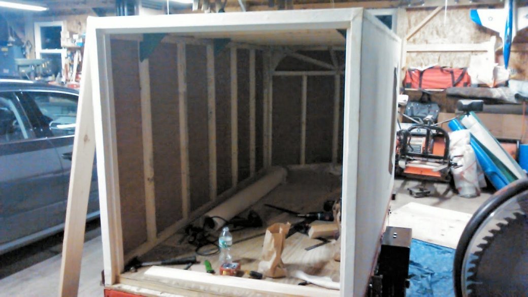

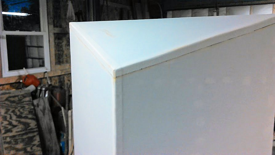

    Here are the pictures of the trailer I mentioned earlier. it is 2x2 frame with luan sheeting covered with a 8oz canvas like used in boats. He glued it all on with titebond 2 glue and then said it took around 10 coats of Sherwin Williams exterior latex paint. Said it took so much as he kept painting it until it didn't look like cavas anymore. Said final weight came out around 600 lbs
