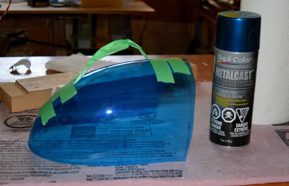

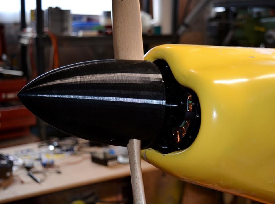

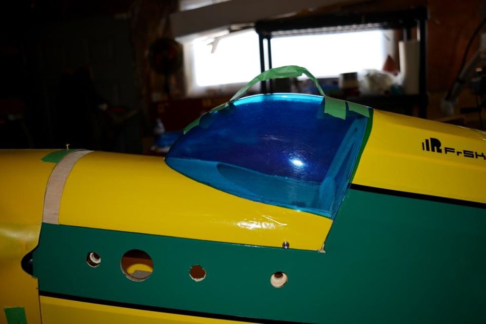

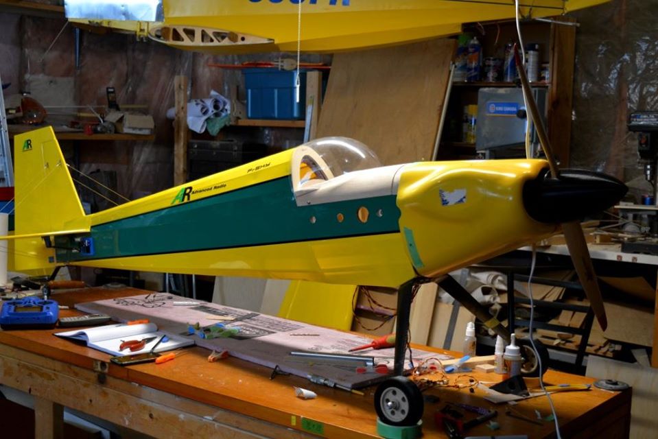

more work done, you will notice I started to clean the cowling to repaint it, lots of sanding to do and get a paint match, then the canopy, transparent blue, , I have done this before with Testors transparent blue paint, but this time I didn't have any , couldn't find any, but I had plenty of the Dupli-Color anadizing blue and you know what I think it is the same thing, the results are exactly the same, spray the inside , which is why there is a sort of handle with masking tape
