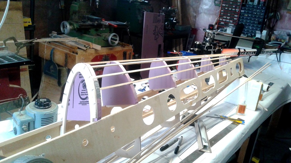

IMAC Scratch build Laser 200
well looks like the foam hot wire cut bulkheads seems to be working

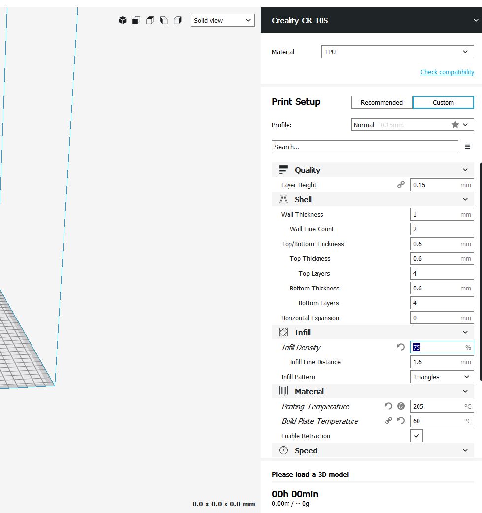

Yes it is , using TPU filament, which is basically Urathane , the amount of flex will depend on the amount of fill I program into it.
I have some TPU sitting around. I need to give it a whirl!! Looks like a CR-10? Any tips for a guy who has been using PLA to try out TPU setting wise? I wonder how the tire will hold up under torsion or even rocks for that matter. WAY cool, I haven't seen anyone accomplish this yet. Way to go!
Yes I use the CR 10S, As for holding up, you have to remember TPU is made with Urethane material which is very tough, the belt I made for the alternator never gave me any problems and I had a few made for different sizes and had some of my friends pull on it to break it and they couldn't .
As for holding out I believe it will but until I put the mileage LOL I can only speculate.
In the picture this is mostly the settings in Cura for the CR 10 for TPU, you have to make sure the nozzle if very close to the glass.
If you have problems I'm sure I can help , just let know
