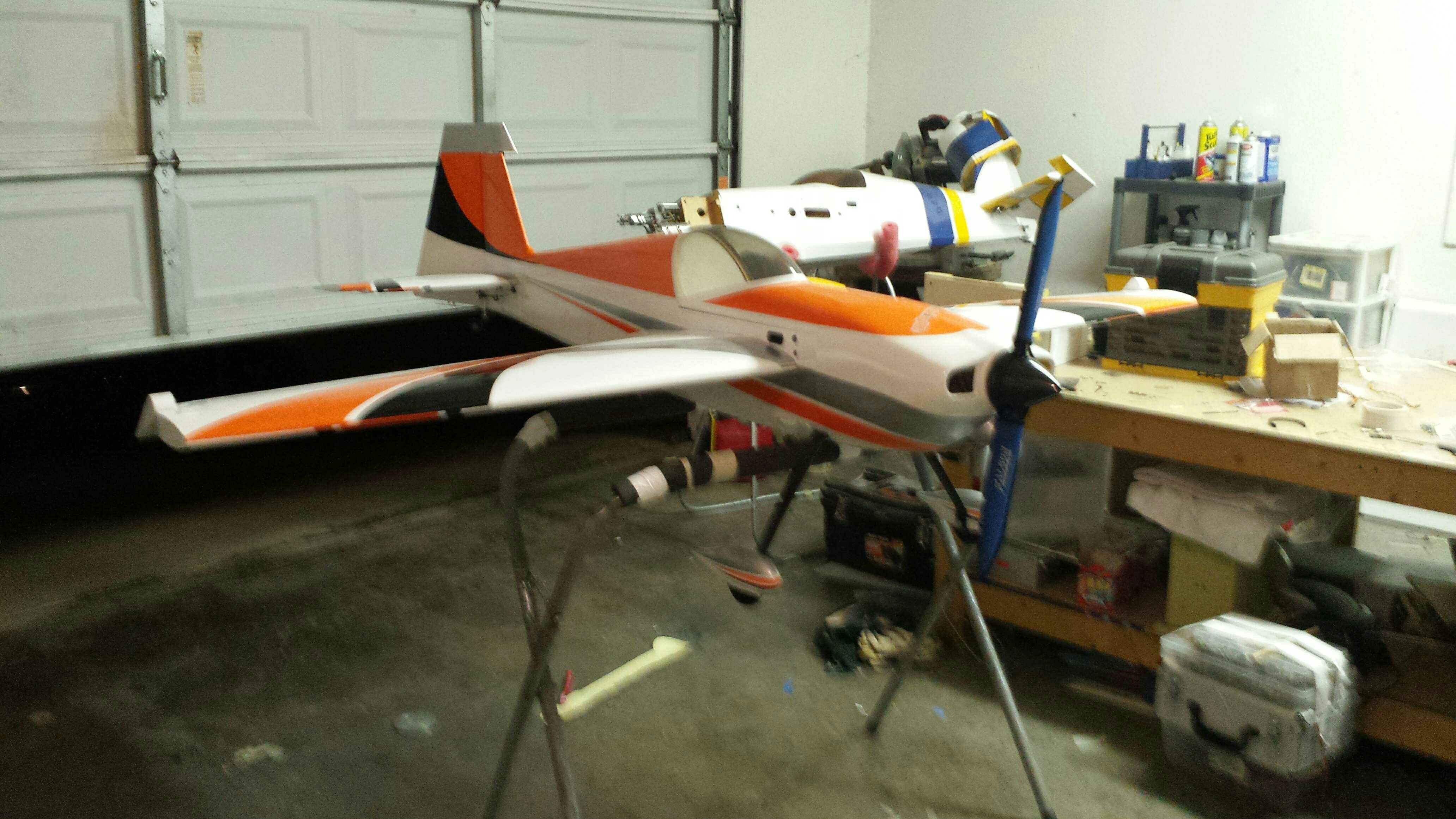

uploadfromtaptalk1402634959460.jpgshe is complete.. saturday can't get here fast enough

Well madien is complete and all i can say is wow,, Redwing sure has a winner here..
The plan Tracks Great,, flys like it is on rails..,, low slow High alpha stuff is great...tork rolls are simple..
