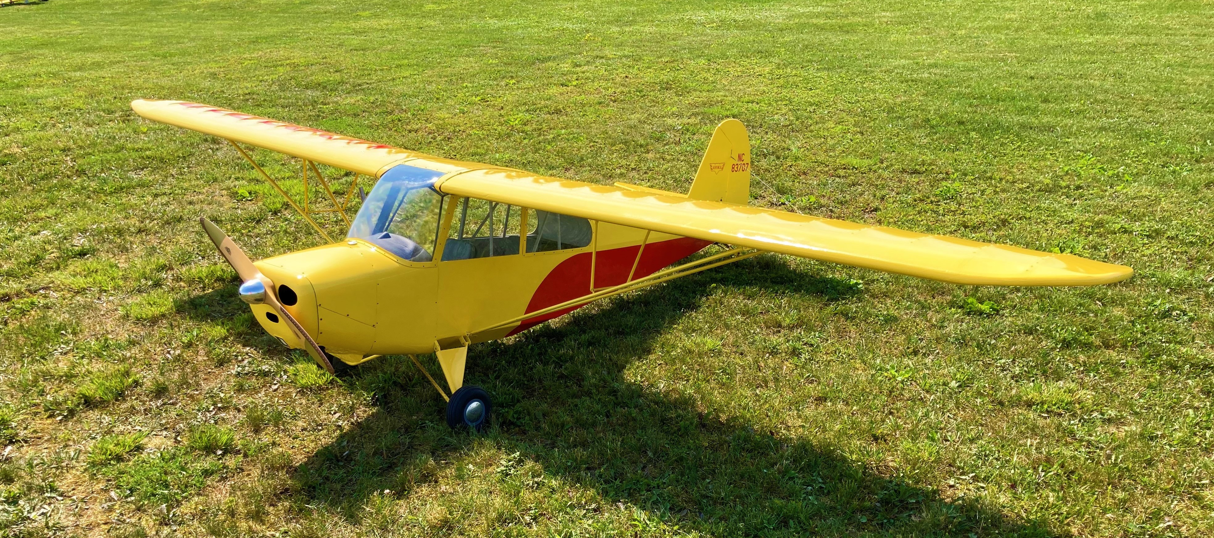

  8. Someone brought this nice Champ to the Indiana Flyers Club fun fly on 6/29/21, wonder who? IMG_7052 (1).jpg
    WMcNabb, dhal22, AKNick and 1 other person like this.
  9. dhal22
    dhal22 GSN Sponsor Tier 1
    I've seen one like that recently. Somewhere................. They both are beautiful.
