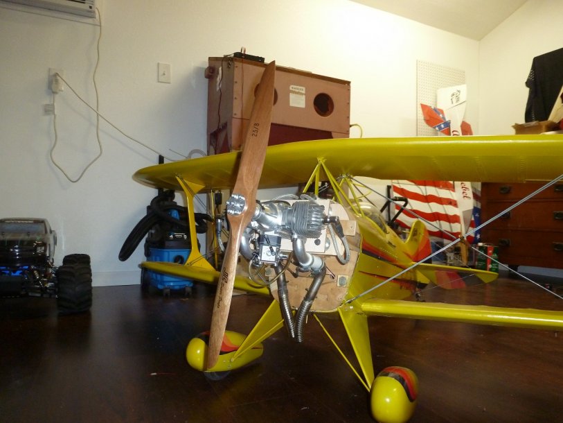

@Bunky.F.Knuckle, I was referring to what is listed, not what they may actually be. Stronger than advertised is a good thing. And, I have one, two weeks old with 20oz through it. Smooth as silk and running straight pipes, will run it a couple more times tomorrow then close it up and go fly. I started with the recommended break-in prop of 22x8 but there was not enough load for my liking. Now turning a 23x8, much better, far more than this bird needs. I have not had an RCGF engine that I do not like, but, I like the smoothness of the twins so much I am switching all airframes to one. I only have one more to go, a DLE 55 and it will get replaced with one of these.

The yella Pitts shown above had the CRRC 55cc twin in it, moved it to the lighter GP Pitts. The way the CRRC flew it was great, but, this RCGF is really going to jack it up. No comparison between the two.
