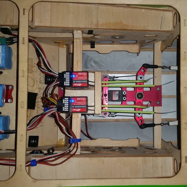

I would like to update this, I am now running a pair of Maxima 9 receivers, one for each side of the airplane.

Are you splitting the plane in the middle or running opposite control surfaces on separate rx's? I run dual rx's and split the controls like RA, LE and a rudder servo on one rx and the rest on the other rx. So as long as I have one rx still working, I can at least have some sort of control over the plane :) I am sure you have thought of this as well :)

I have the left side of the airplane on the left receiver, and the right side of the airplane on the right receiver. Since I run dual rudder servos in a tray, I run one rudder servo on each receiver, so I can at least maintain some level of control in the event one receiver loses link or shuts down. Throttle servo is on one receiver.
Let me tell you about how hairy it is when a wire breaks off of your switch and kills the half of the airplane that has the throttle servo :oblong:
