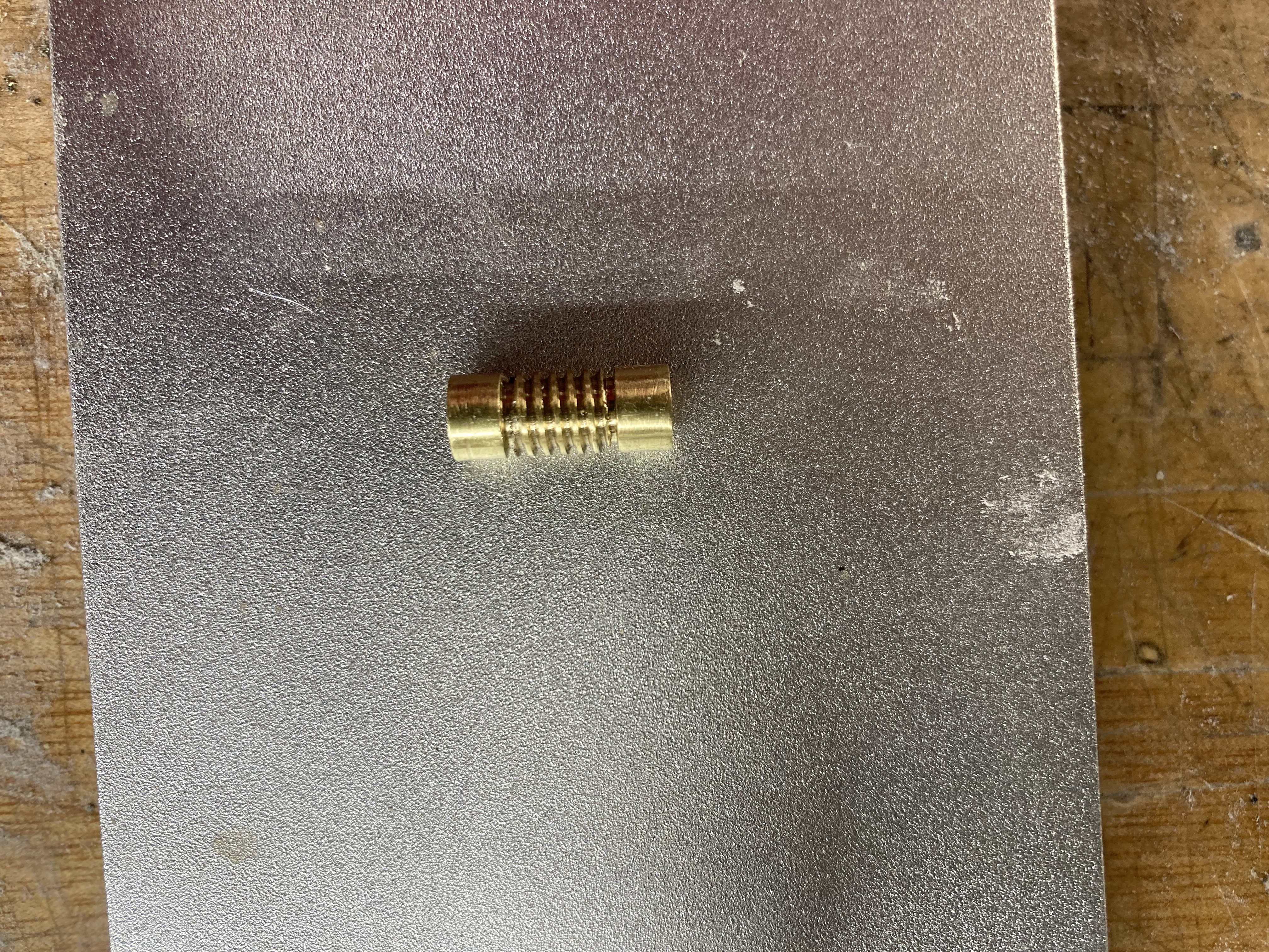

Looks good Tony,
But the threaded part must be in the center of two non threaded ends. I can do the center drilling and also cut in the key slot. I just don't have any way to cut the threads. The threads look really good though!!
TonyHallo
Oh, I know that I was simply testing, I had to change the tool that I ground after I noticed it was cutting more like a thread. At any rate PM me your address and I will mail it to you. I didn't make the reliefs as big on each end as shown on the drawing since there was no dimension provided and I didn't need to make it bigger since I kept the half nut engaged and turned the lathe by hand. You can make those bigger if needed, much easier to take off than add! I drilled and reamed the center hole.
