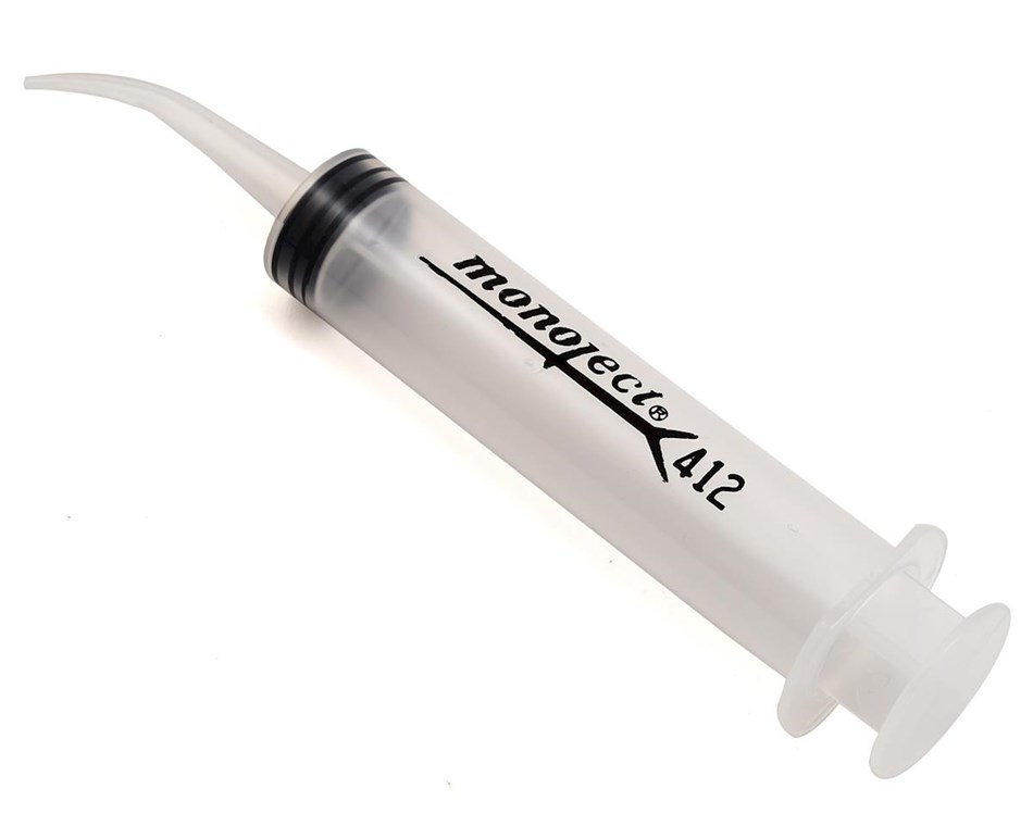

I would suggest not using CA on a giant scale canopy. It's too hard and can cause the canopy to crack. Some say the CA itself makes the plastic more brittle. RC56, now Formula 560, works well, and stays a little flexible. Goop would probably work great. On another guys advice I used it to hold the cowl ring in the fiberglass cowl on my scratch build Miss Moana, and it worked awesome. He had me put it in a big syringe to make it easier to apply.

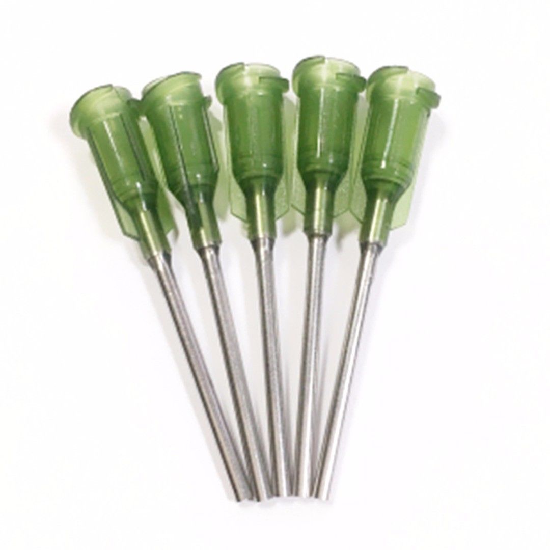

I agree with everything you said and will probably use the Goop. On one of the pics of the old and new bench, front right corner, there is a box of syringes and filler needles. They be bought really cheap on eBay, ten cents a piece or something like that.
Jetpainter
One like this is what I used.

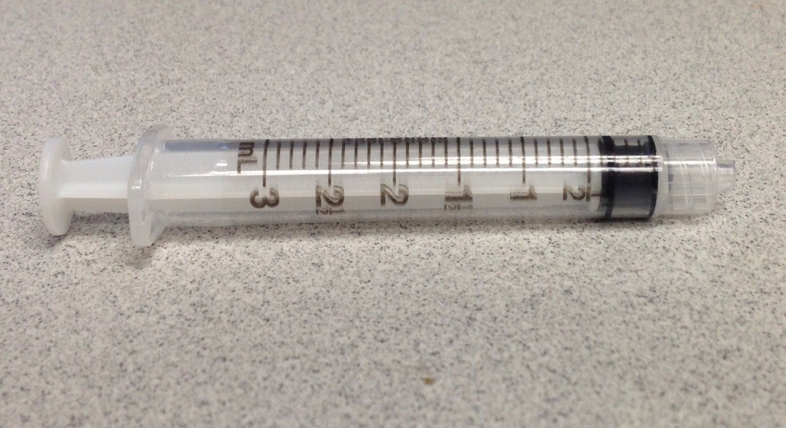

I use the plain syringe, a box of 100 syringes are about ten bucks and 100 tips for about the same.
