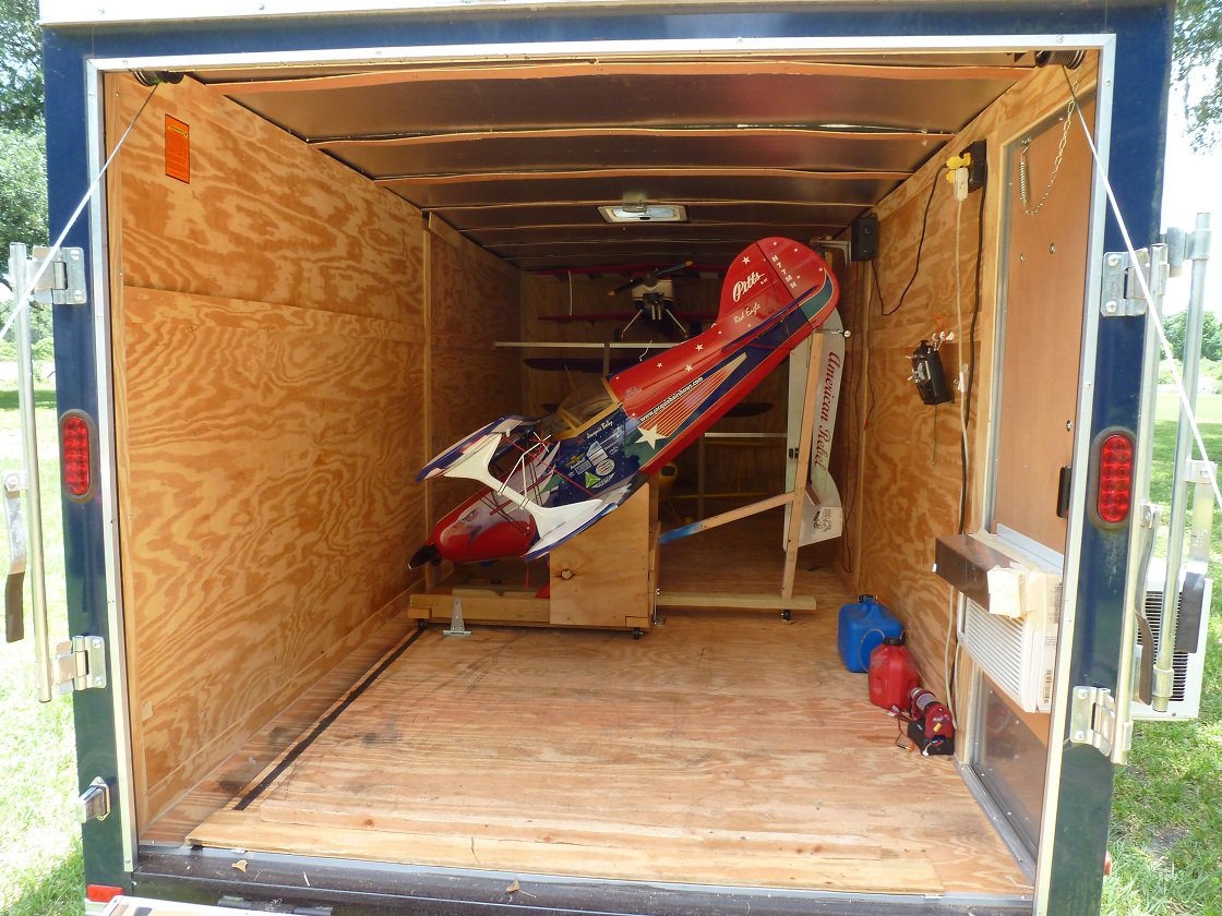

When you build all these big bi planes do you take them to the field assembled or do you assemble them at the field.

Like this.

Ok that makes life a lot easier. Pull it out and fly. So you have a maximum size that fits and then you build everything to that.

But this Challenger is being built to take the wings off quick and easily, one bolt top wing, one bolt each bottom wing half, flying wires disconnect at fuselage. It will have a piece made (I'll call it the joint strut) to hold each half of the top and bottom wings together so as to not have to remove the strut and the rest of the flying wires. To install the wings I pull the joint strut, slide wings on, install three bolts, and hook up two flying wires. I have done this method before and assembly at the field is less than five minutes.
