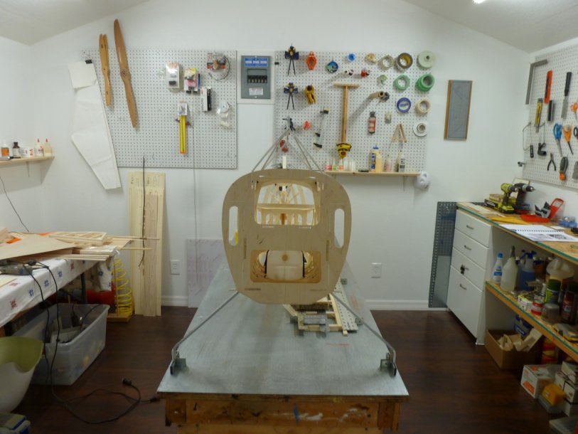

The bird is off it's back and on it's own leg's.

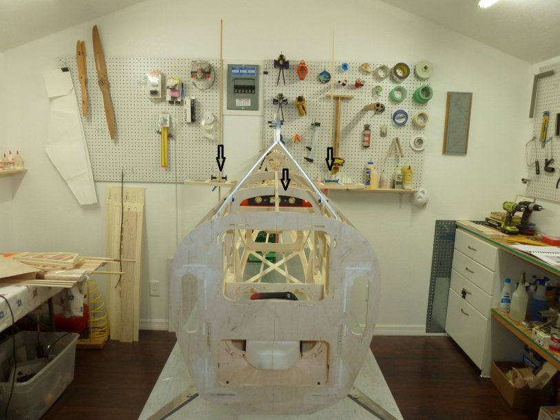

The fin has been fitted and leveled/squared. I will leave it here for the day, in the morning I need to do some sanding to fit the stab tube and stabs.

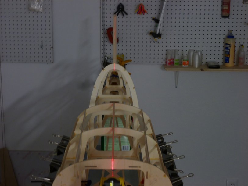

The fuse tube's along with the stab halves are in place, leveled, and epoxied. Note level on fuse and each stab half, check, check, and double check...
