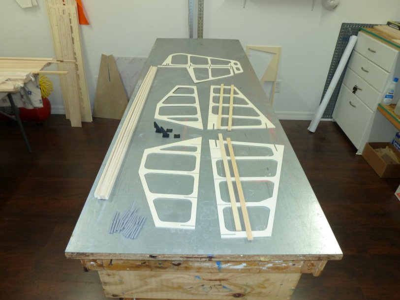

Thank you @Jaketab. From what I see this one will be the easiest, quickest (in actual build time), and lightest. As it currently stands I do not see why this thing can not come in at or below the mfg.'s listed weight of 32lbs, which is good for me. The pic is everything to complete the tail feathers less the Ultracote. Not much to them, the wings are the same, the fuse has some chunks of 1/4" ply of which can be lightened, it's as close to an ARF as it can get and be of kit form.

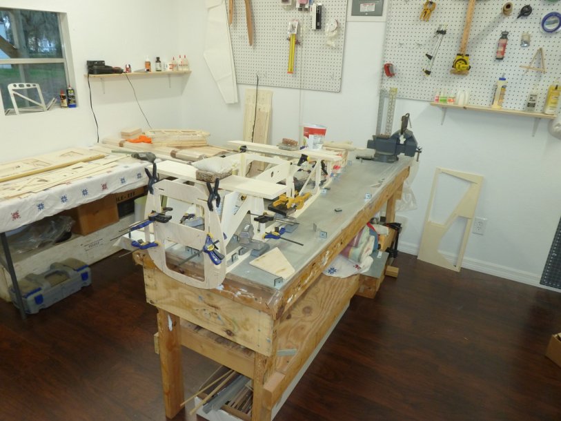

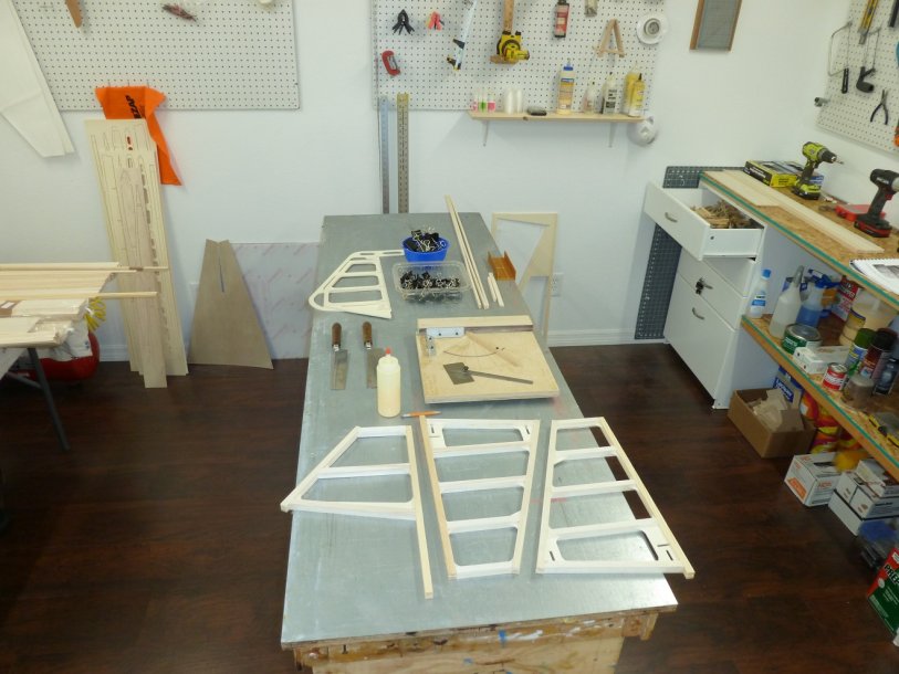

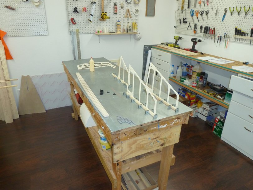

Had some running around today but still managing to get something done, the fin and stabs are done. In case no one recall's I do all the sanding when everything is framed, thus my saying things are done when they clearly are not. Should have the rest of the tail feathers complete tonight.

The fuse took some thought and planning to glue the box together at one time, which to me is the best way to ensure everything is square. But here it is curing.
