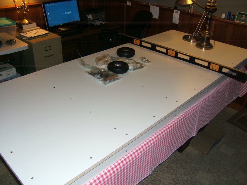

DSCF3991.JPG Forgot to include pic of the hardware along with my new 3'x7' build table.
It's in a warm room situated between the computer and TV.

Question - getting ready to build the tail and wing sections to start. Is it necessary to have a semi-soft table overlay to pin the sections too??
Will clamps, weights, tape, or sandbags be adequate to weigh down flat and hold into place as glue dries ??
If pinning down is required, what would be a table good overlay?? Drywall? Soft panel board? Something else ????/
Thanks - Jaketab

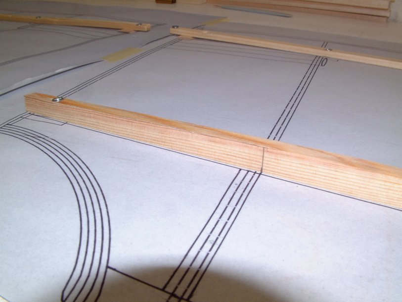

Weight's will be fine for the tail feathers but the wing is a different story. The wing get's built upon ply runners which need to be very securely fastened down, see pic. If you are ok with screwing to the table you show above is, that is what I would suggest. If you don't want to screw to it then I would lay a sheet of ply over it and clamp the perimeter.

The ply runners are discarded after the wing is laid out? (Correct or not?)
The jig for the fuse is also screwed to the board, so I will get a 3/8" sheet of ply to cover the building table to screw into.
My concern was getting something soft enough that would accept push pins.
Thanks - Jaketab

That would be correct, the ply runners are discarded.
I never found much love of the push pin method but absolutely love the magnet way. Drywall or ceiling panels may very well work, but, with a model of this nature I would not trust it.
