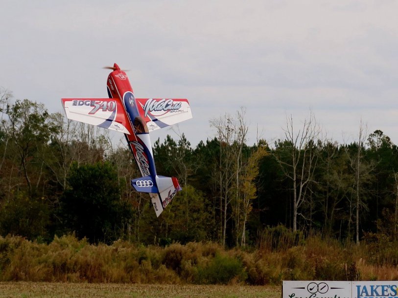

I have had mine for 3 years now. It has a Da 150 on stock mufflers with a 30x10 falcon prop, 7955's all the way around. 3 on the rudder, 4 on elevators, 4 on ailerons. Just to let you all know, I have played with the cg a lot on this plane and I have it on the leading edge of the wing tube and it is perfect.
