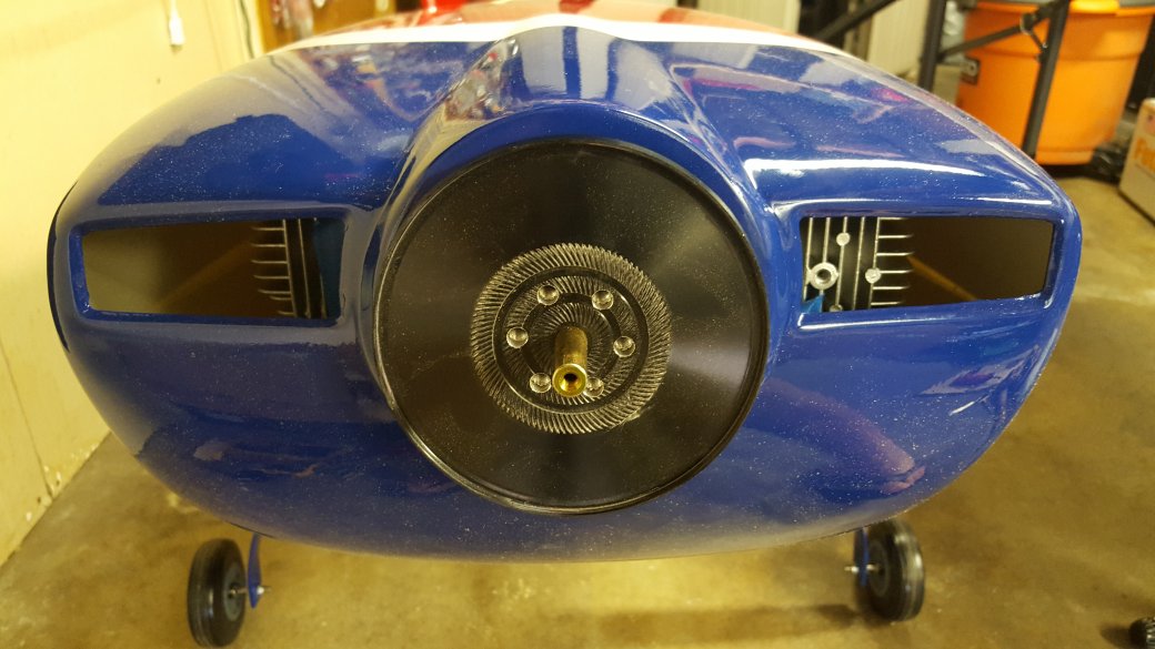

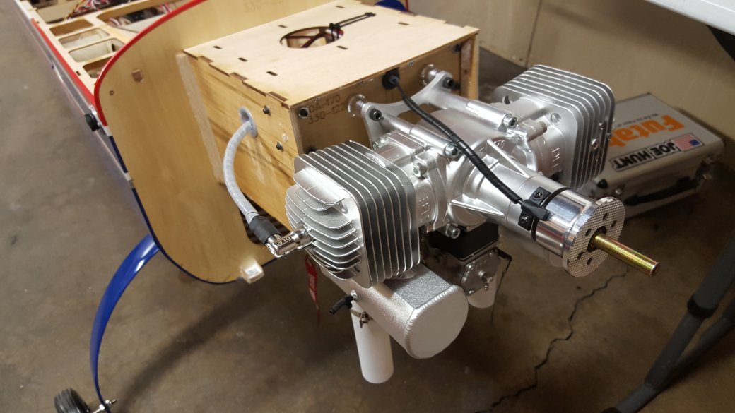

I didn't finish the plane yesterday for a Thursday maiden. I got stymied on the motorbox. Last one worked out perfect drilling the factory template holes on the firewall. This one came out 1/4" low. Took awhile to fix that.

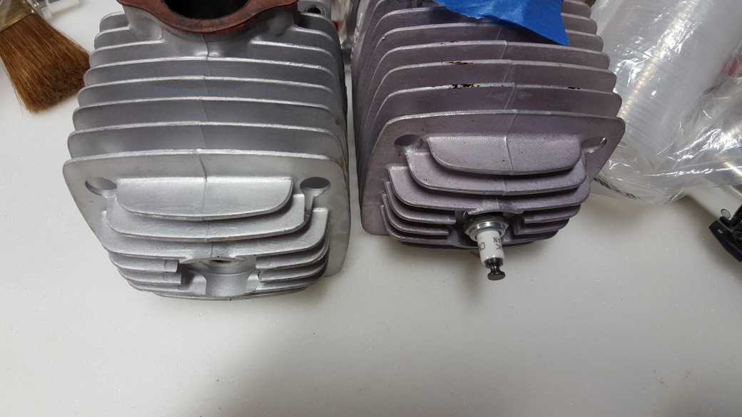

Took a shot of my DA-170 head after 65 flights (I did a pretty nice baffle job) next to my friend's DA-170 (his is the pink one on the right).

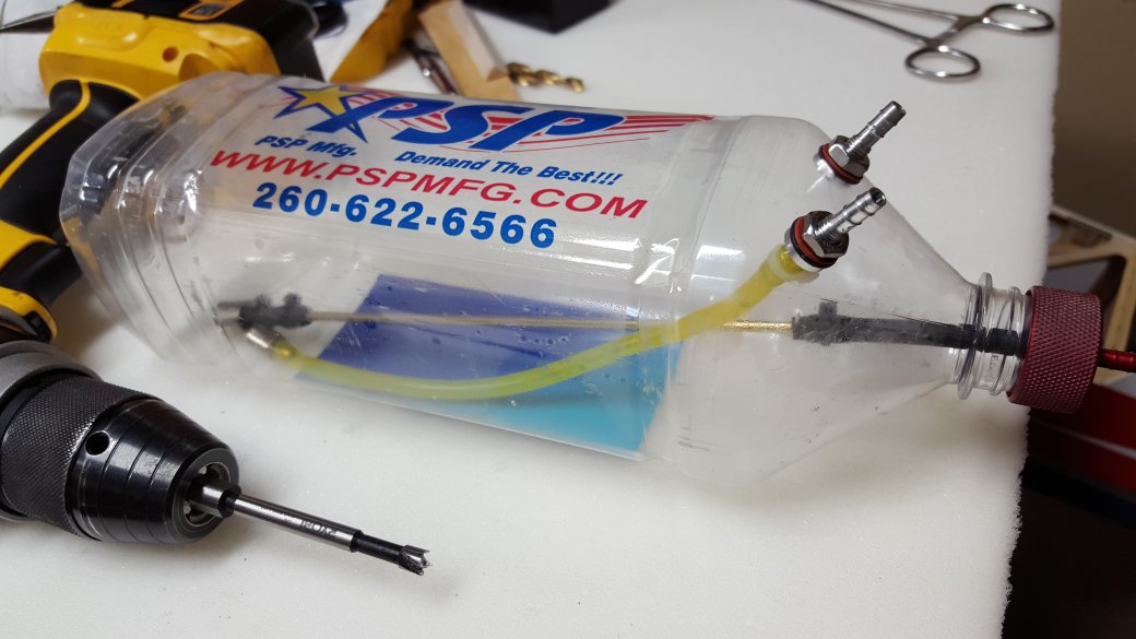

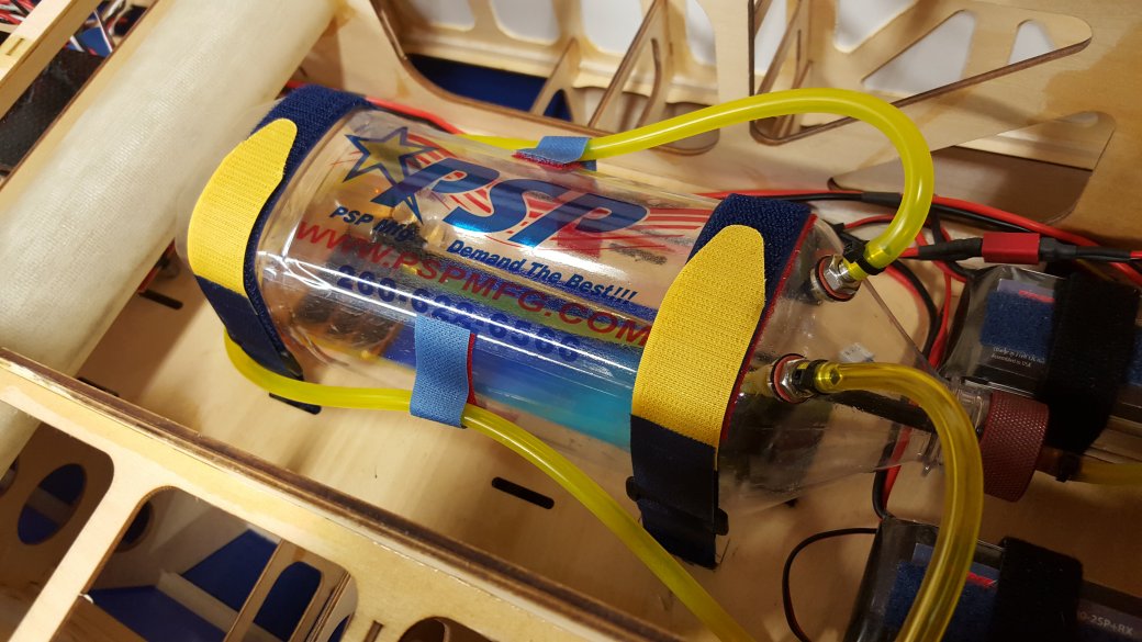

I made up a new PSP fuel tank (I'm going to throw the older one back in the H9 Sukhoi w/ DA-170 on tune pipes for IMAC). I used DUBRO clunks because they're slotted.

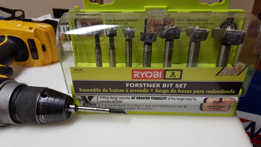

PSP has an instruction video on putting these together (not that you need one), and they show using a sharpened brass pipe to cut the holes in the water bottle. But, I found that these Forstner bits work really well.
