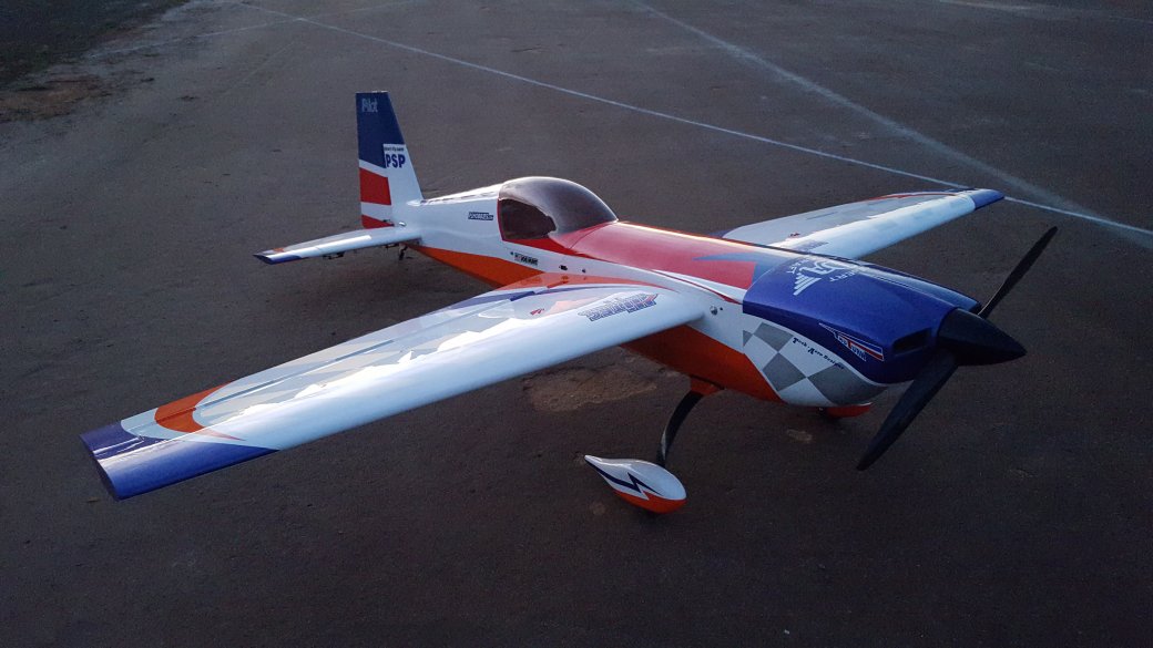

I see Joe Smith likes the purple scheme too:

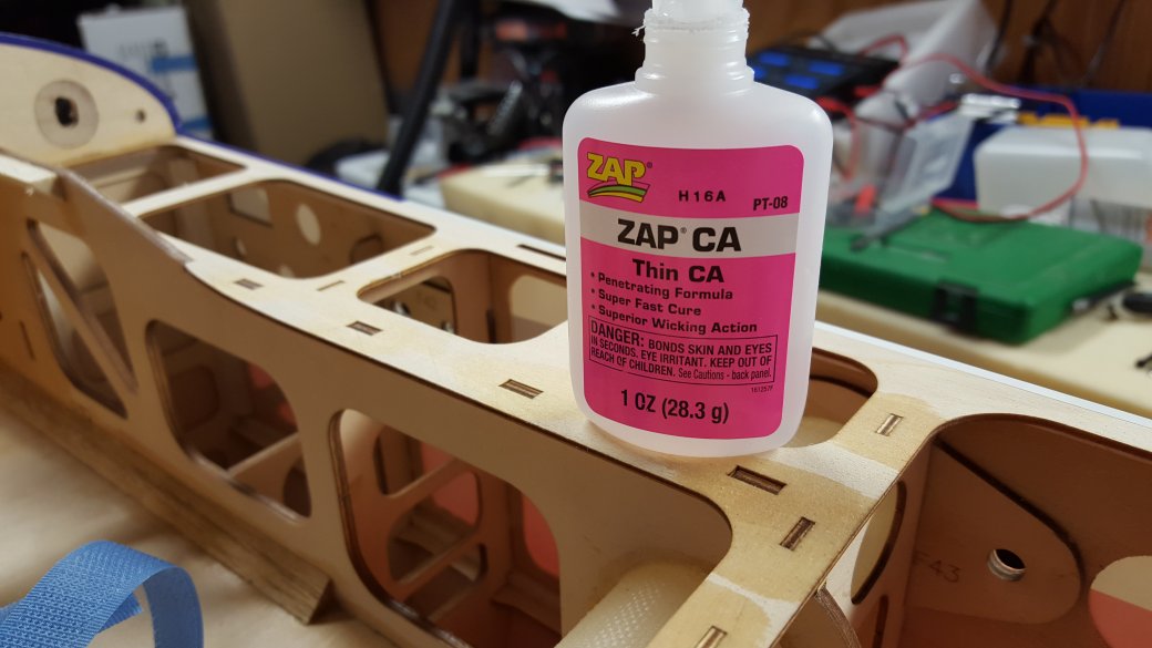

I am going to soak all the joints with thin CA because these planes are basically not glued together (just a little hot glue).

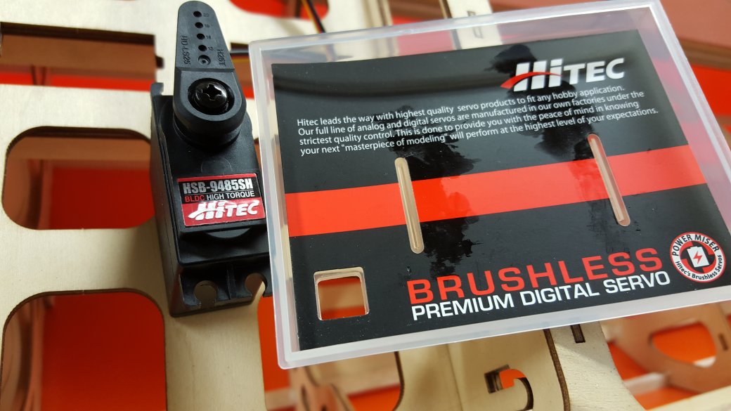

Still no 9380s (I have two for the elevators, though) so going with 9485s on the ailerons and rudder... 9360 on the throttle.

The 9485's are kinda somewhat similar to the 7955's, but they don't fade in torque like all coreless servos do. Either way, they are more than plenty for ailerons and rudder- Kim Quenette is using the 9485's on his EF 104" Extra ailerons he was flying at the fly in last month. As you can tell, they were more than enough :mario-banana:
