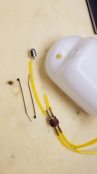

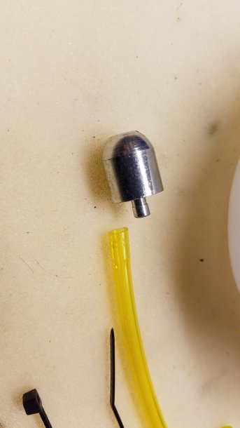

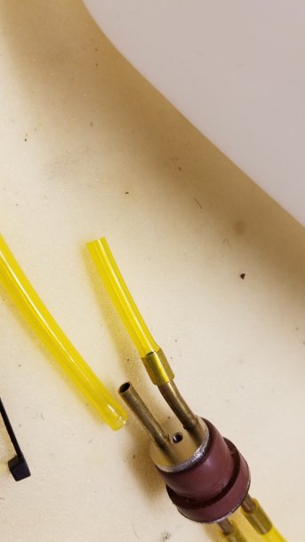

I have three of these Pilot RC tanks sitting here so I got curious about them. The stopper goes on kinda like a grommet and seems pretty good. The clunk is big and is chamfer'd and has a slot like DUBRO (maybe not as pretty, haha), although it doesn't have much of a "barb" per se... just a tiny recess. And, there's no barb on the brass fuel tubing end. Change the clunk to one with a barb, and solder on a barb on the fuel tubing side and looks fine, more or less. haha

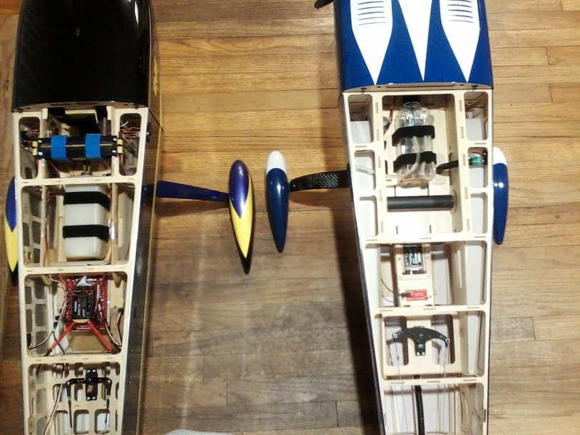

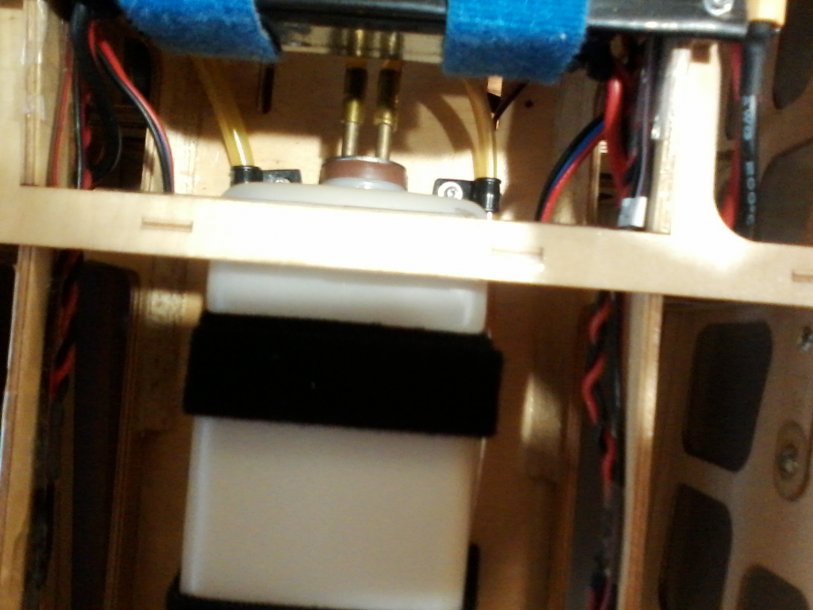

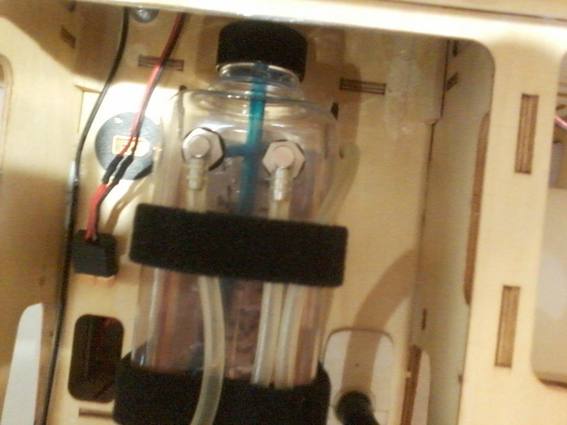

Joe I have been running the stock fuel tank in my Pilot Edge for over 5 years now. The silicon/poly fuel tubing has not got hard and stays put (no barbs needed).
These new "Kuza" tanks that a lot of ARF companies now offer (and of course after market) are nice and easy to set up but I wonder how long will they hold up??? My Pilot stock tank with that tubing (came with the ARF) is for the "duration". I'm wondering if it will ever need maintenance!

Yeah, I noticed I had to cut the line off the tubing with no barb. I couldn't pull it off, it would just stretch with a healthy he-man effort. So that stock line is pretty good, huh? Five years? Wow! Do you think these new ones have just as good of line as your five year old one?
