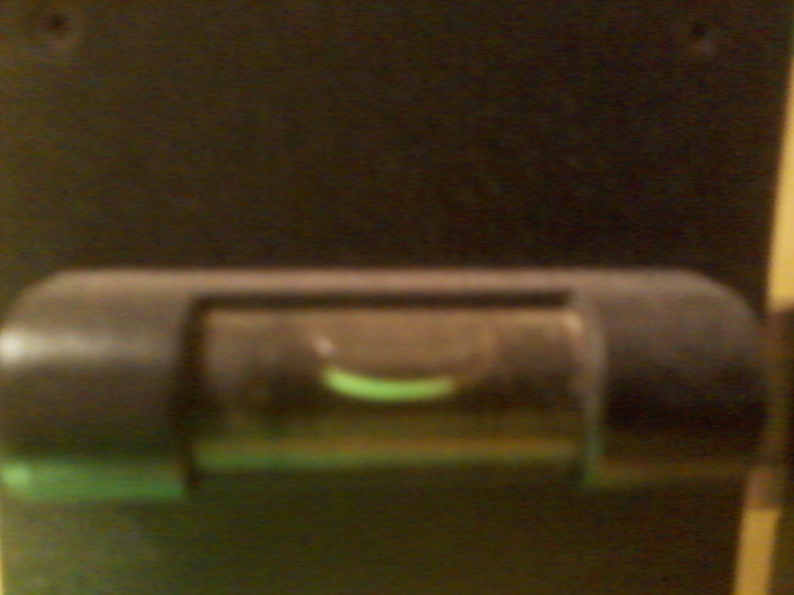

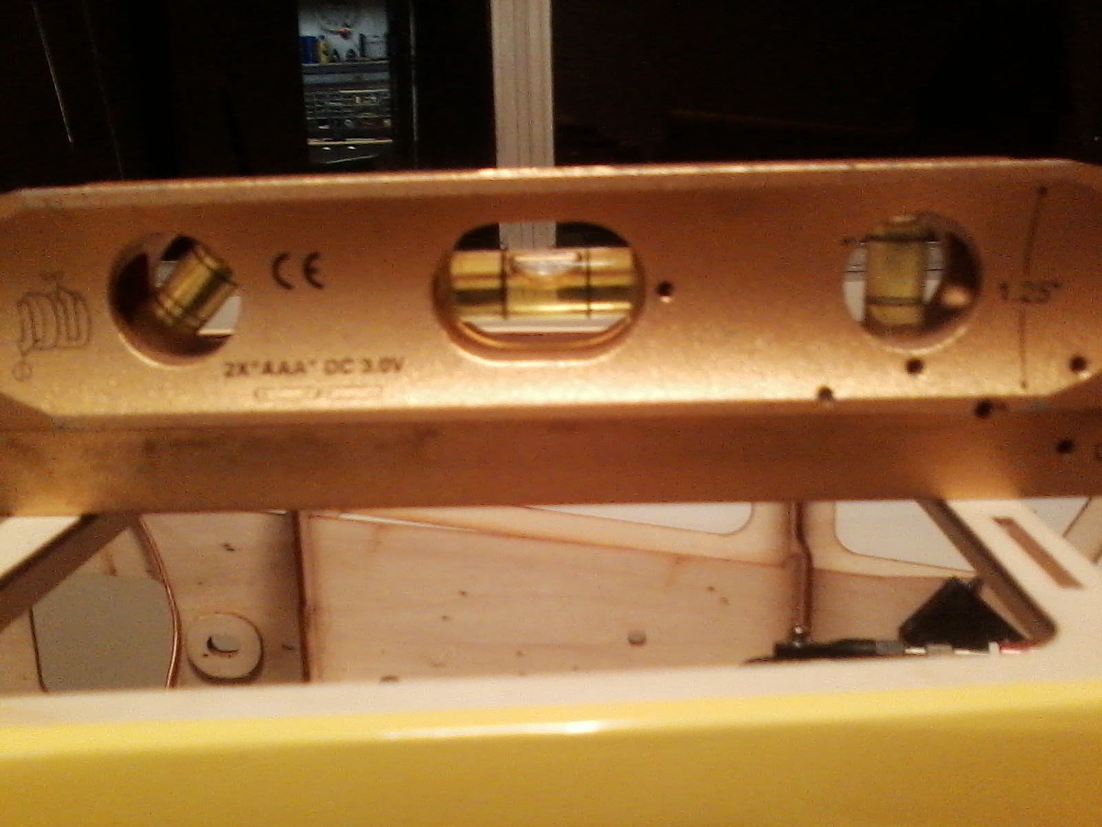

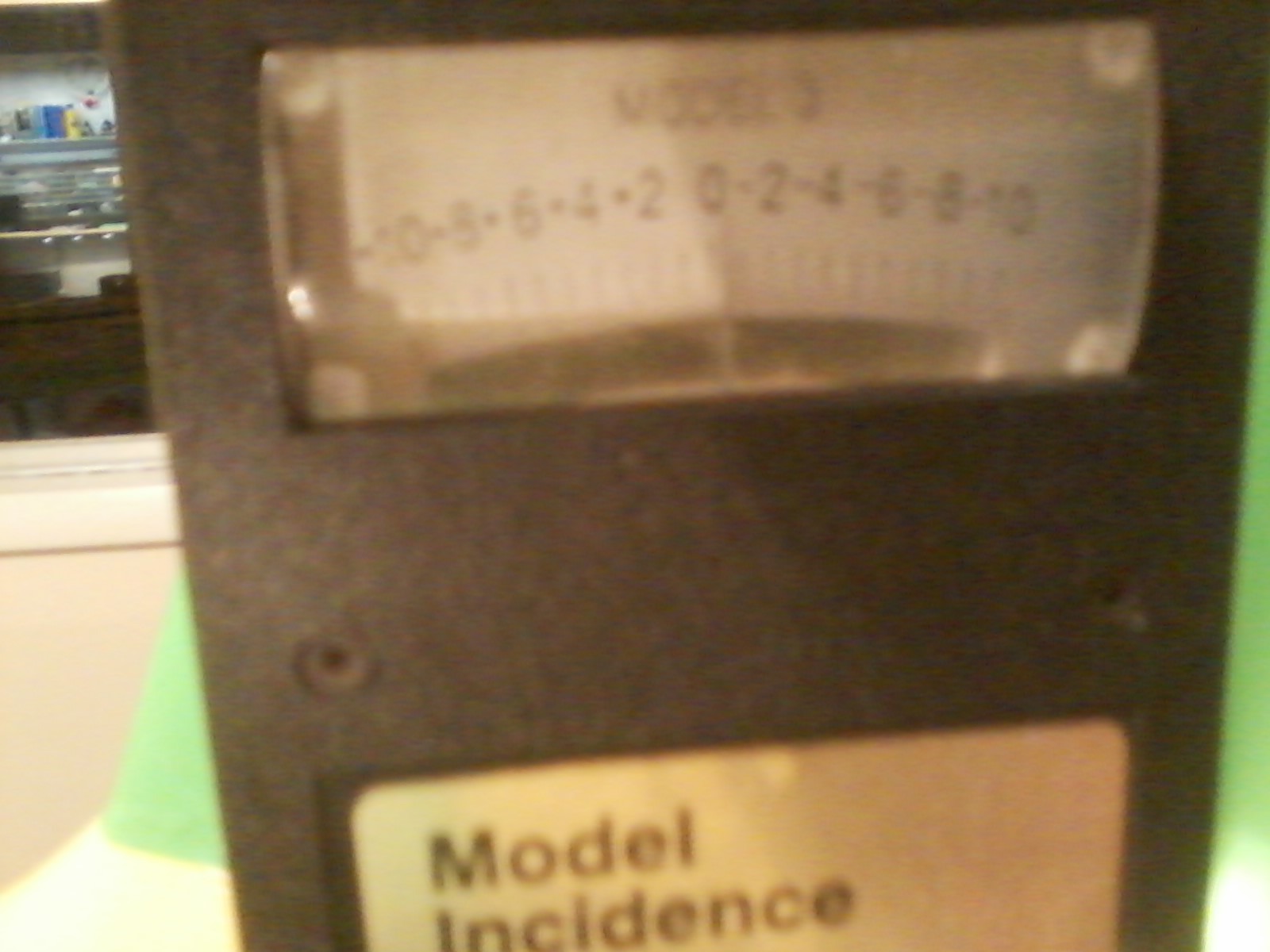

Broke out the level and incidence meter to check the stab. What'd ya know......Stab is actually just about 0. Measured Neg -.5 degrees in relation to the main wing. When I did this to the V1 it measured Pos +1 degree (which I set back to 0 ).
So I am going to move the 8oz weight further forward just about where the prop hub is. Even though the wing is 0 with the datum or thrust line it sure doesn't look like it by just looking at it. Tail seems too high. And going back to the landing picks it seems that the wing was perfectly parallel to the ground then. That landing should have been a 2 point grease job. Huh!?

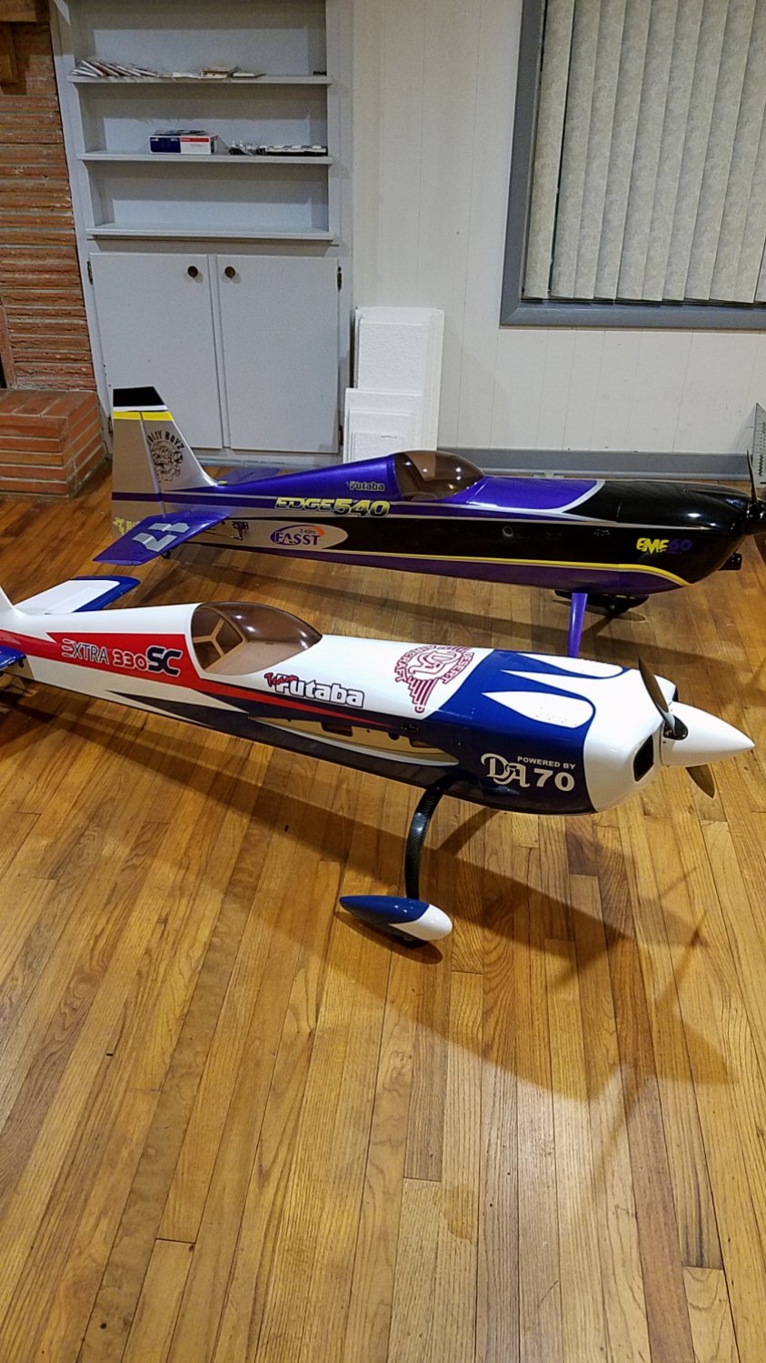

. But Nooooooooo! Kelly got to prove a DL50 can whup up on a 60
What was I thinking when I sold it.....
to some pretty bulky flips in my day
