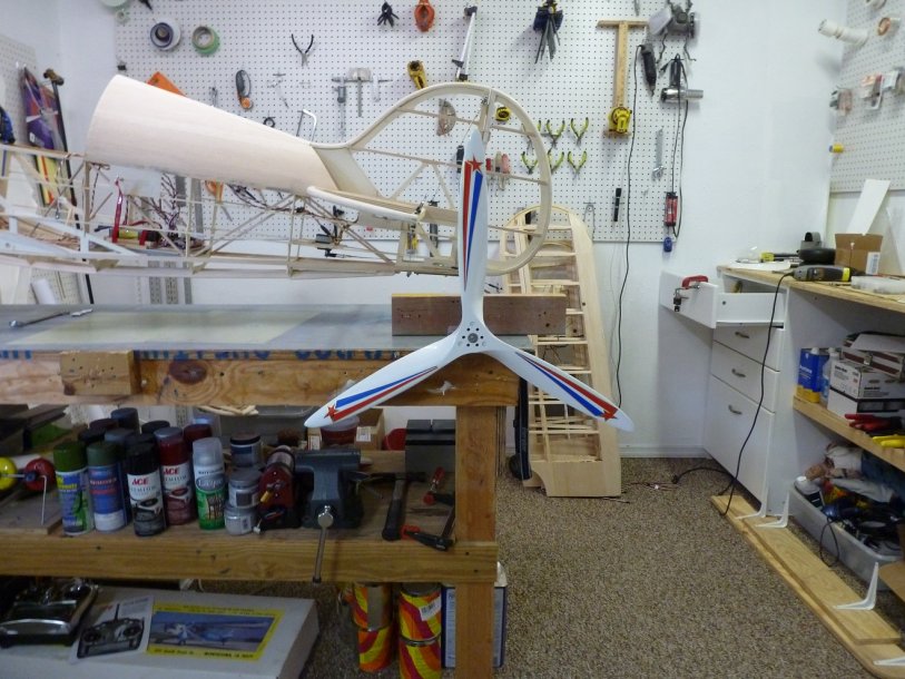

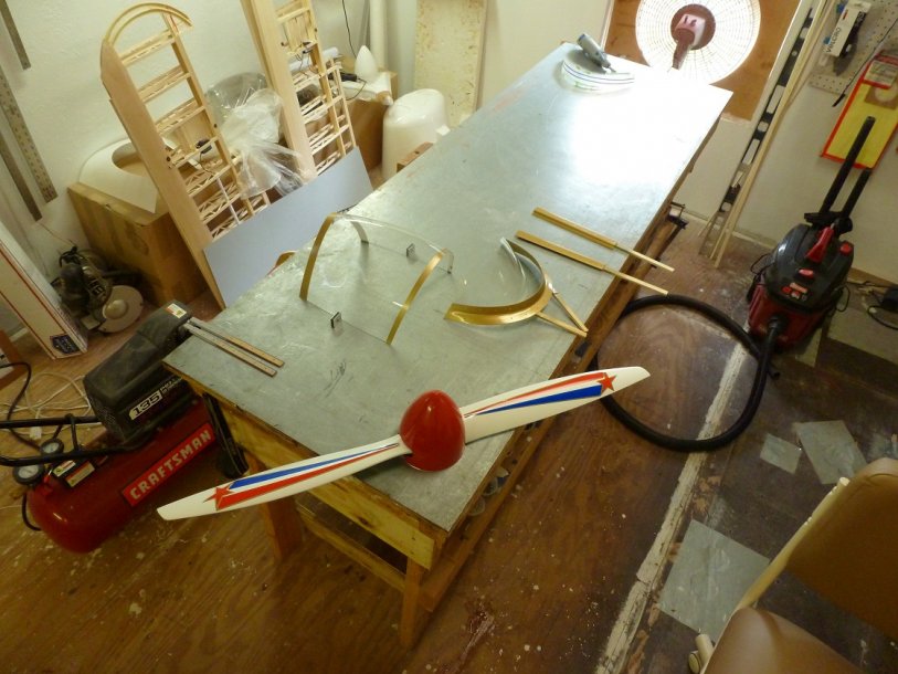

    I forgot to post the painted prop that I was asking for. The first is the fist two blade, and then a three blade. The two blade was a tad to small at 34x12, the three blade was ridiculously small at 30x14, and I am currently painting a two blade 34x14 that should be perfect sized. I decided to use the Stits colors I used on the airframe and the same automotive clear coat. It worked out real well and seemed to be pretty tuff. Eventually I will get another three blade, 32x16, but for now I just want to fly it some.
