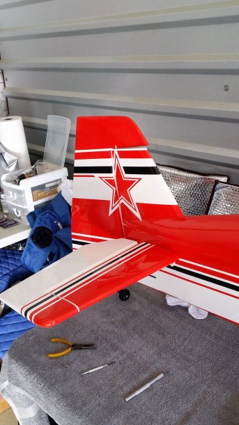

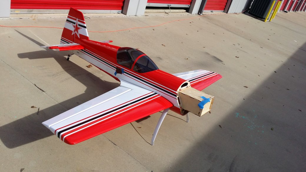

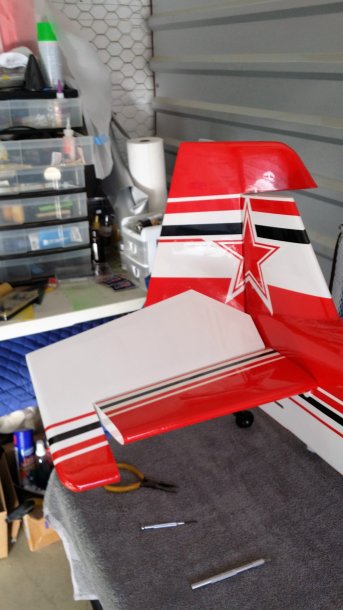

Thanks Terry. I am in Tyler, Tx. and we have hot and humid days so I guess I will go lower pitch for the spool up. I was talking to Richard at WrongWay RC and he was talking about some of the PAU props that he has, they are wood. that have been working good on his GP-60. Here are a couple of pictures I took today.
