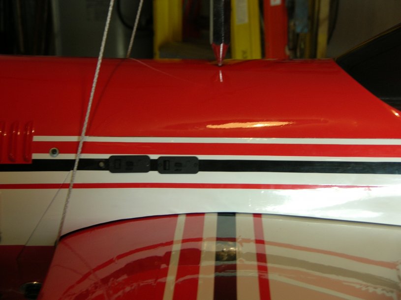

The assembly manual says 6.5" for IMAC. I fly in Basic. I'll spend some more time measuring tomorrow. And I've still got a spinner to install. I've got a headache from trying to remember how to program my radio at the moment. Close but not done yet.
rmyers
I definitely need to move the COG 1 inch forward. Still need to cut a spinner and I haven't baffled the cowl yet. Any other ideas?

I just put it back up on the balancer and really leveled it. After waiting for the plumb bob to settle down it looks a little better. Right in the middle of the wing tube. Perhaps it was late and I was a little tired yesterday. I'm going to go ahead and get spinner done and the baffle installed. Then I'll have another look at the COG.
rmyers
Oops
