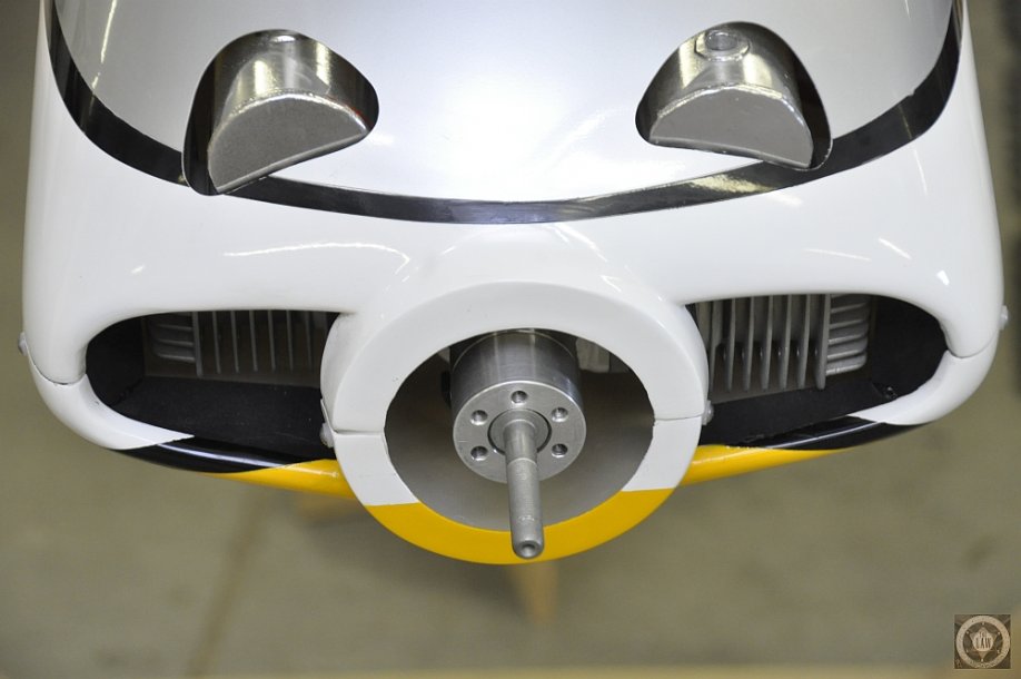

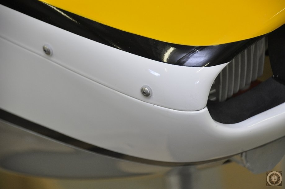

Looks great Terry. If I can offer a suggestion though. try and wrap your baffling behind the heads. I dropped 60F from going from baffling like what you have to including a wrap to force air behind the cylinder heads. Plus it balanced out the temps from head to head. I had a large differential between both heads prior also.
Terryscustom
I've seen that in books and on the web, and understand the concept behind it but it is largely un-needed for this type of installation and the type of flying I do (3d with a mix of precision and scale aerobatics).

Split cowls makes baffling much easier. Not so easy on a single piece. Good looking work.

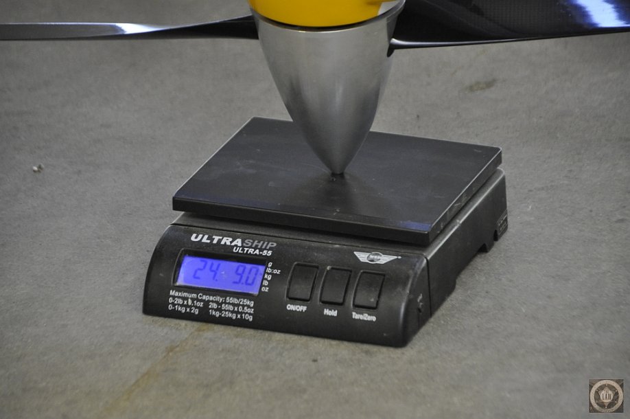

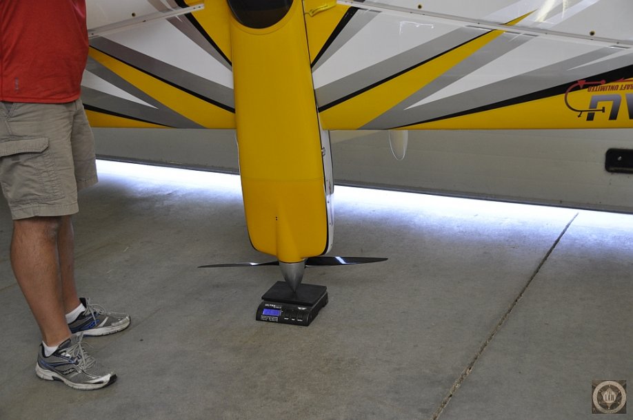

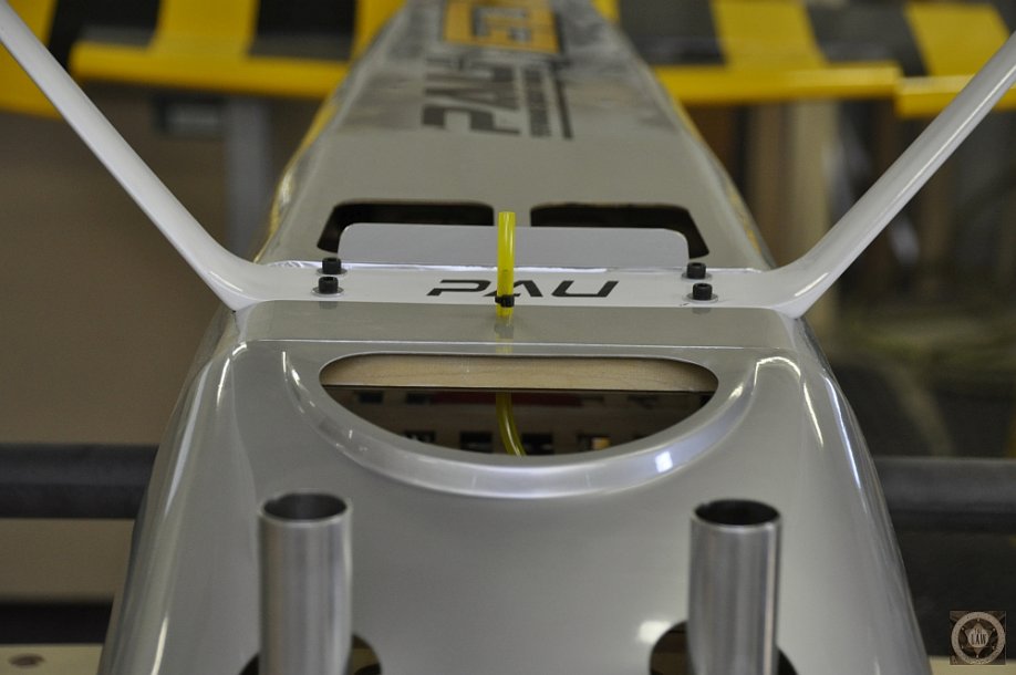

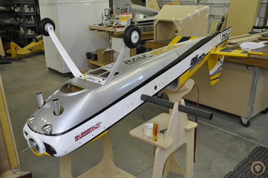

Wrapped up and ready to fly... Engine has been started three times for tuning, will get a vid later today of a cold startup and some run-ups. It is smoooooooth from bottom to top, can't wait to see it after we get a few gallons through it.
24lb. 9oz. without batteries.
