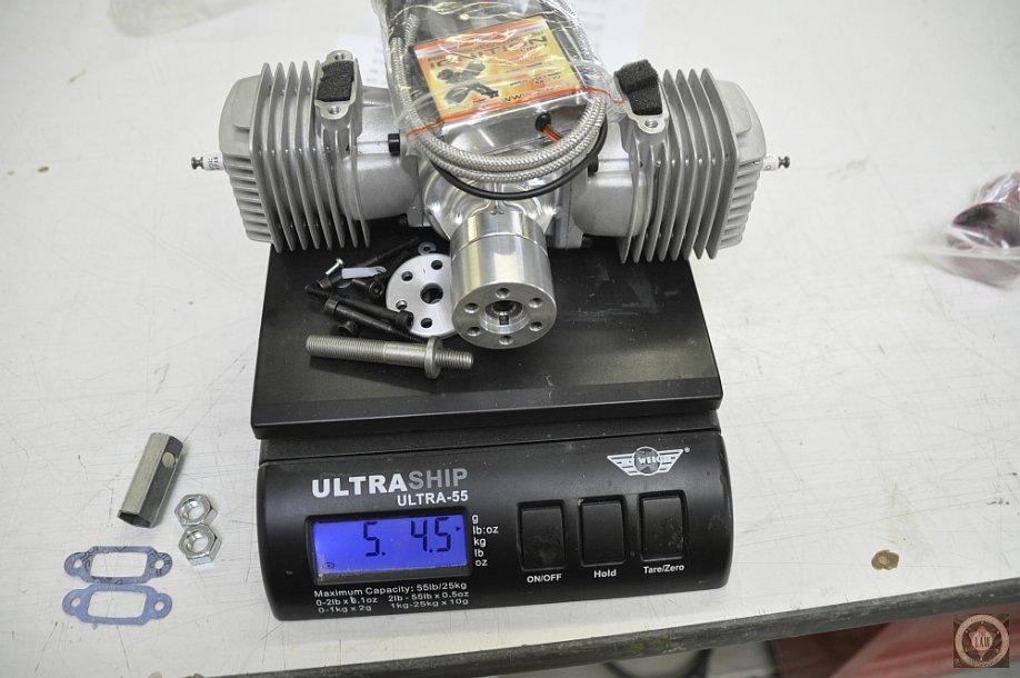

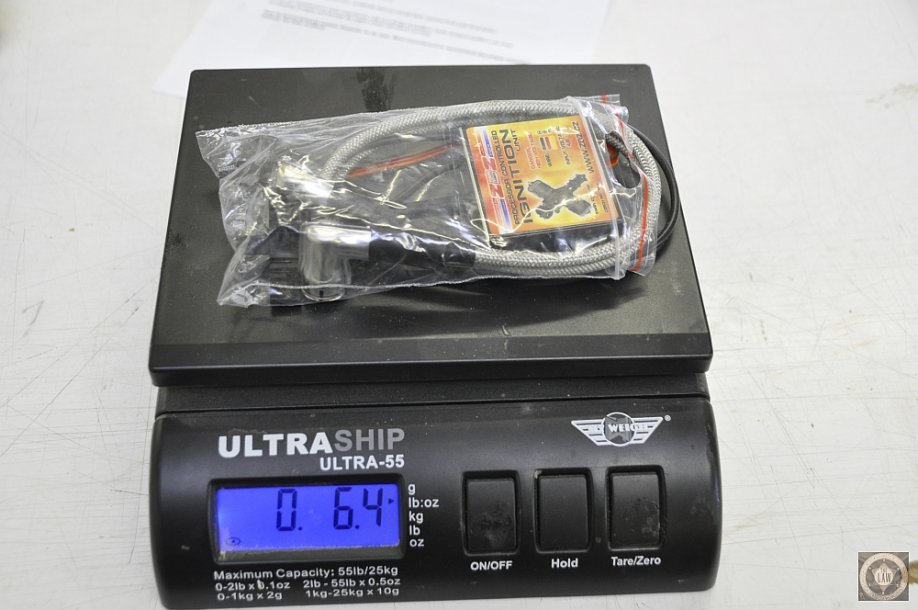

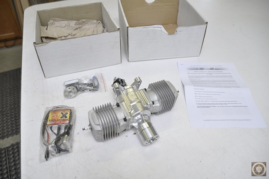

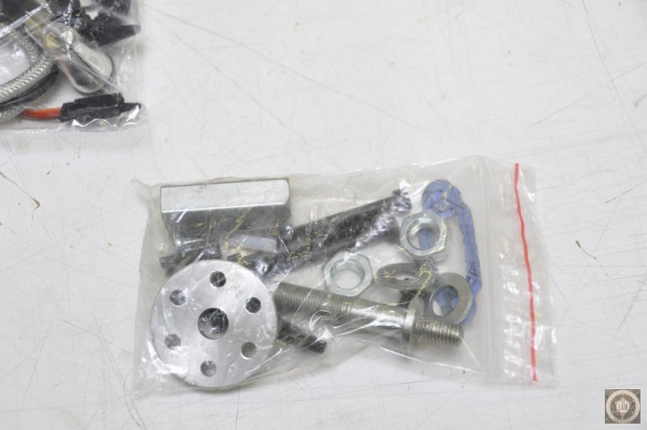

So I un-boxed and checked out the contents. Since all of this is pretty sudden the new engines came and there was supposed to be some machined throttle and choke arms included that did not make the shipping date. I think he said they come from Germany and are on their way ASAP.
So just to get a head start on all the posts that are going to say "I had the XX ZDZ small engine and it was a bastard to start" I am hear to say I DID TOO!!!! However, from watching the 90, 112 and larger I'm not seeing it so far. I got to fly a 50% cap with a 210 in it and it was smother than most 35% planes with a 120cc on the nose. Amazing fluid power. I'm excited to try it.

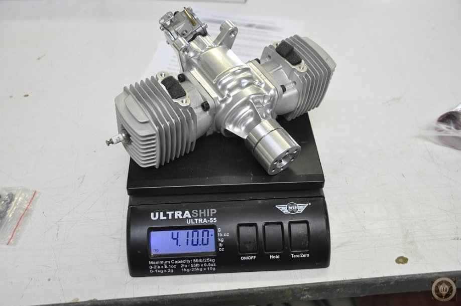

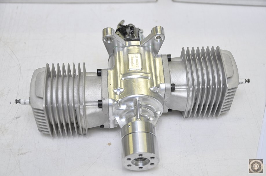

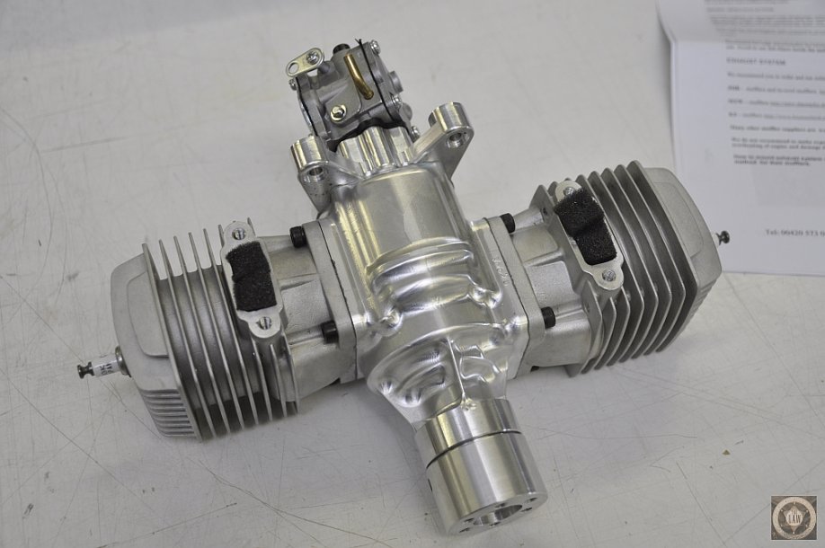

So a few observations from the couple ZDZ's that I had in the past:

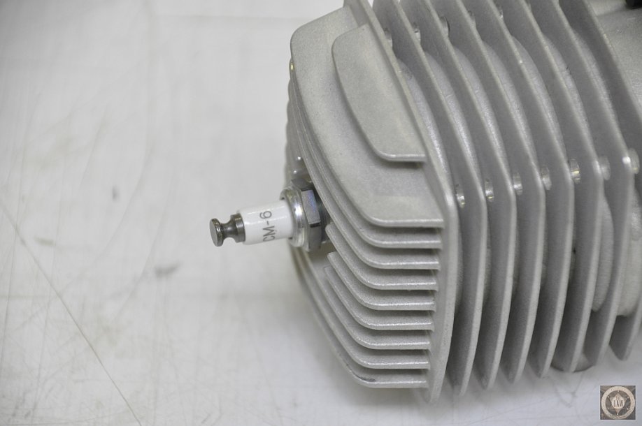

1 - Standard CM-6 plugs!!!! Thank Goodness!! No special plugs to find or funky caps with allen set screws:banana-dance:

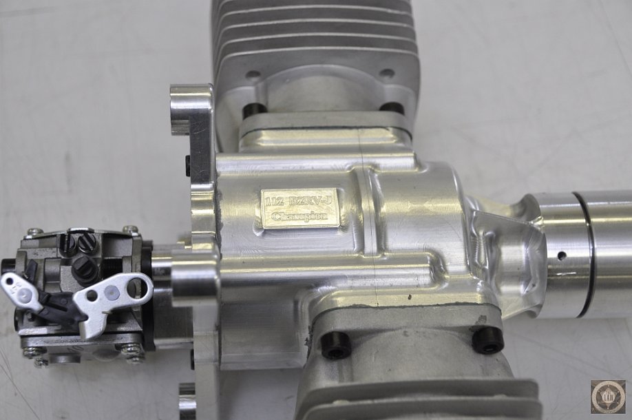

2 - Beautifully machined crank case that is a work of art. Being an engineer I looked at the tooling path, the chamfered edges on holes, radius and fillets on all exposed edges, etc. Very nicely done and well thought out.

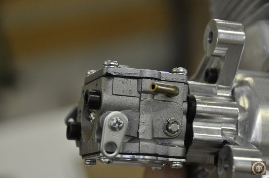

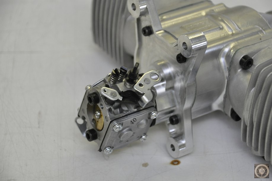

3 - A genuine Walbro carb!!!!:fist_pump:
4 - I could not get a pic of the inside and I'm not going to take it apart but the inside components are a work of art as well. It also uses all high quality sealed bearings and roller bearings.

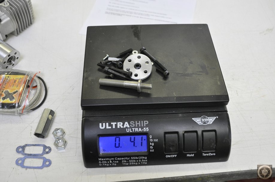

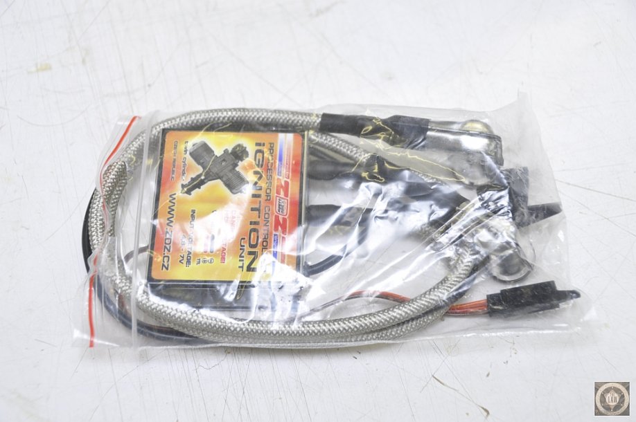

Here are a few pics for reference of un-packing:

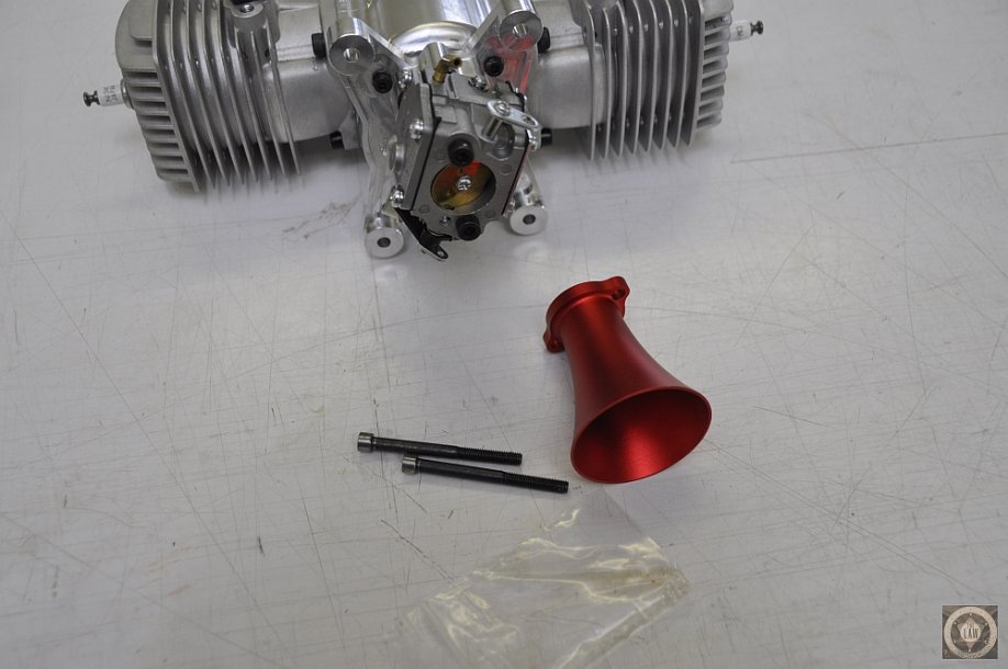

Pretty much one given thing with any rear carb engine being reed or rotary valve.....there is likely to be at least some drip or back-spitting form teh carb at least some point in it's operation. I picked up a velocity stack from TBM that fits the carp perfectly.

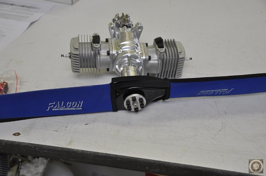

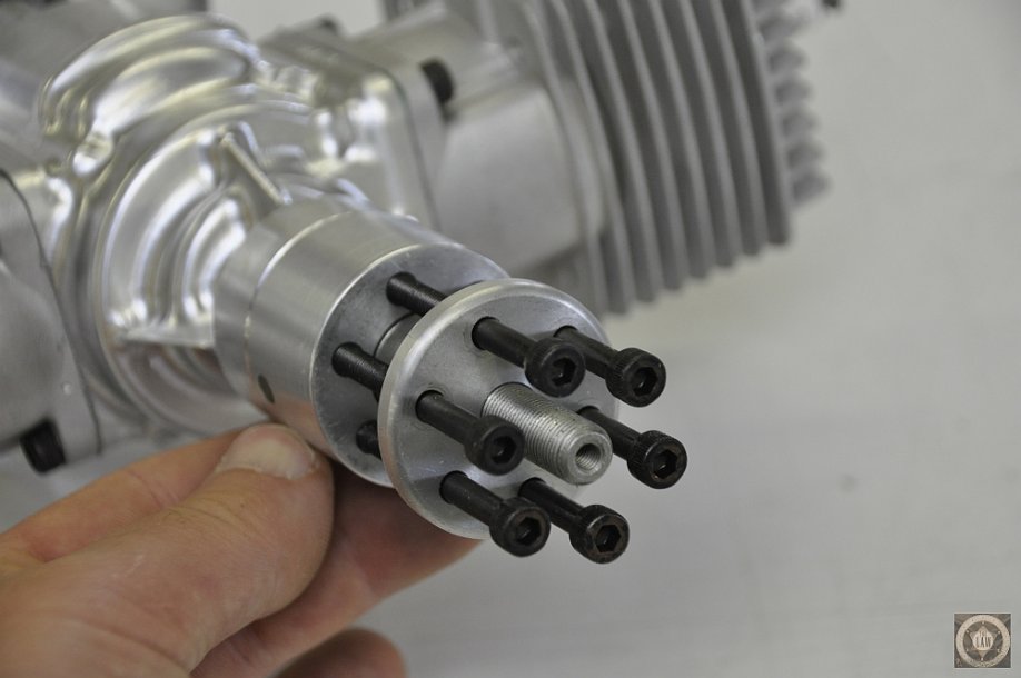

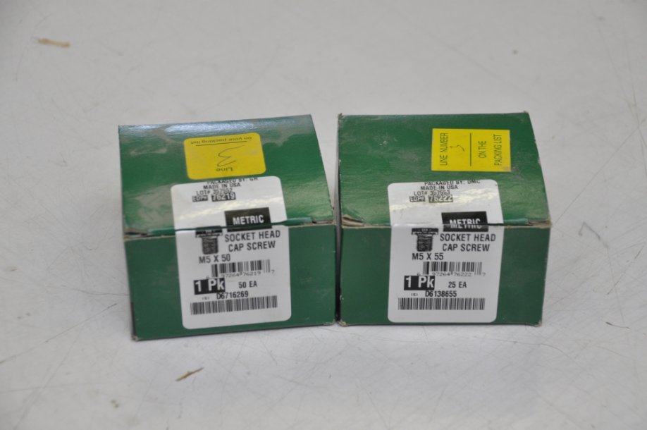

I also verified that the prop bolt pattern is standard to all common DA, DLE, EME etc. 100-120cc engines. I will be doing some prop experimenting so I also filled up on my supply of prop bolts. I replace my prop bolts every 4 times I change a prop because of expansion and potential to snap the bolts. This is probably over-kill but I've never had one break on me yet either:)
