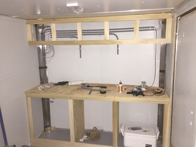

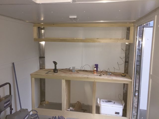

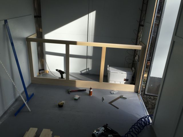

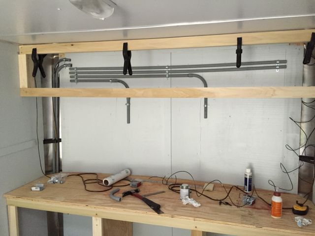

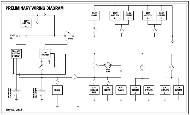

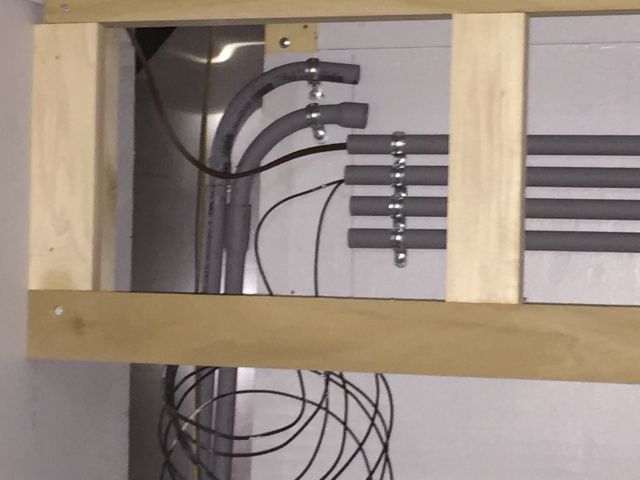

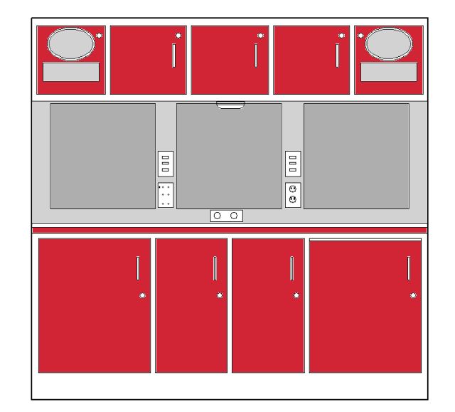

    Well... have started working on the trailer in earnest... since I started this thread earlier, with a few questions, might as well go ahead and post some pictures of the progress. In the trailer idea thread, I had already posted the planned schematic. I will repost that here to keep things together. Today, I installed most of the conduits to make running wires easier. The two center conduits will feed the four outlets that will be located between three small sections of pegboard... see the cabinet rendering below. Have made some progress on the cabinet frames.... not a cabinet guy, so just making this up as I go...

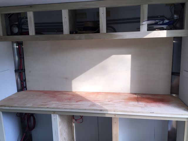

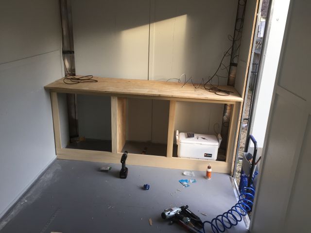

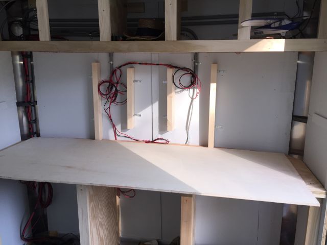

    Have the majority of the ruff wiring done and major parts of the cabinets... and set the back wall up... wires, outlets and switches will be placed in this back wall... in between sections of pegboard... you can kind of see that in the colored rendering above. The corners will be filled in with a couple of things... that will come shortly. Anybody ever put down Formica?
