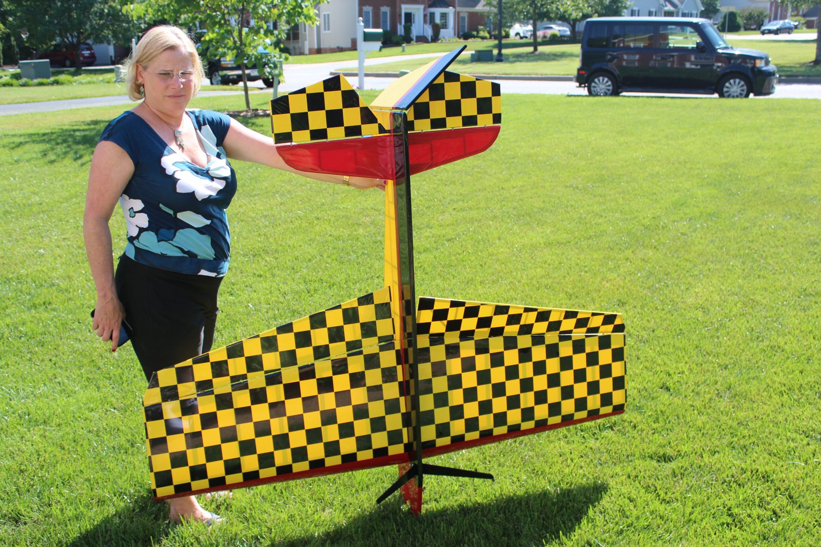

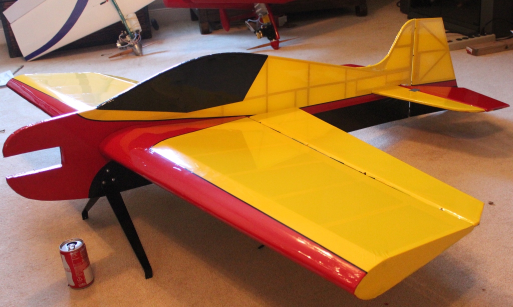

Looks nice. I chose a similar scheme for my 20cc Sbach.
