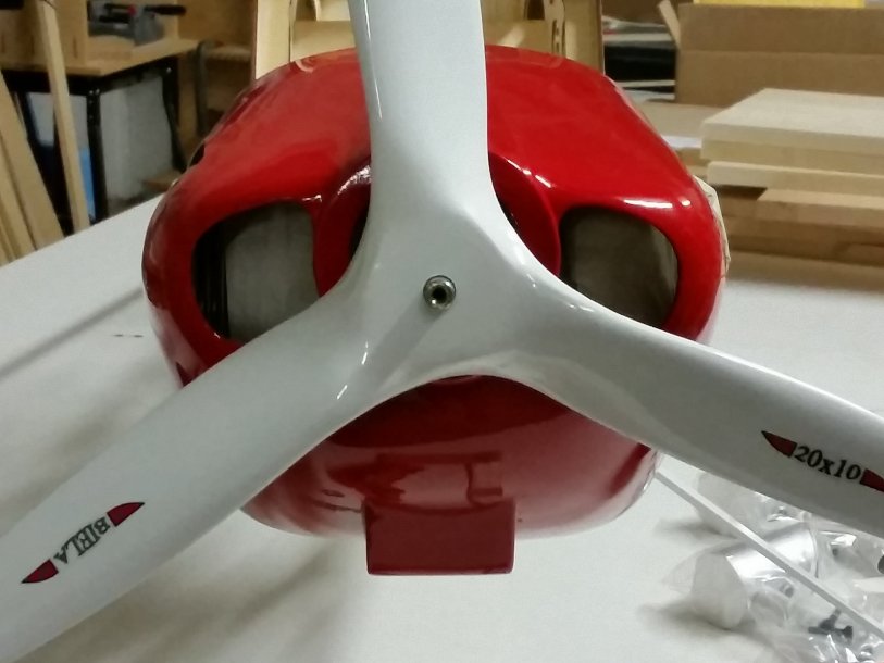

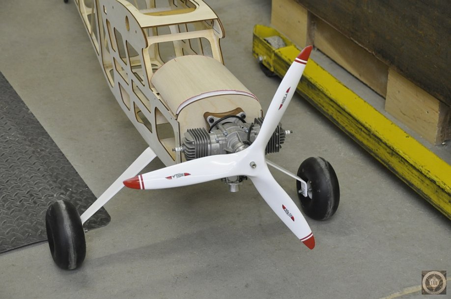

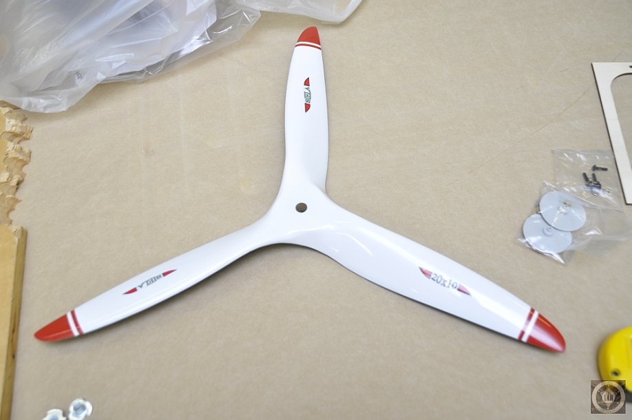

Prop showed up, should be sweet on there! It will have a True-Turn cub hub as well. Only problem is I'm going to have to carve the crap out of the cowl for the heads and the mufflers. Looks like I may have to split it. I may have to make some templates and cut it first to see how much is left. My old Hempel cub that had this engine was cut so large the cowl flexed enough to get on there.

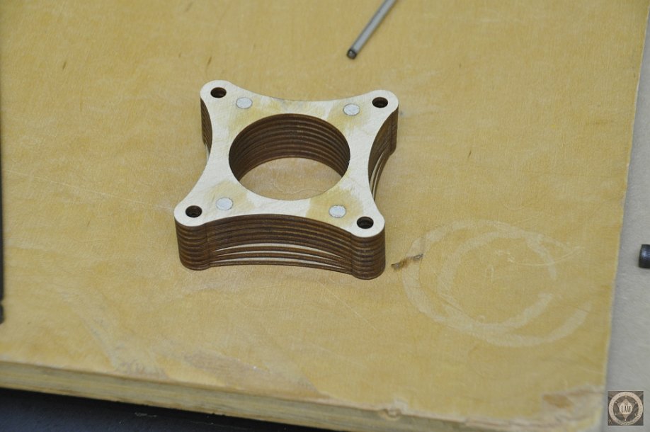

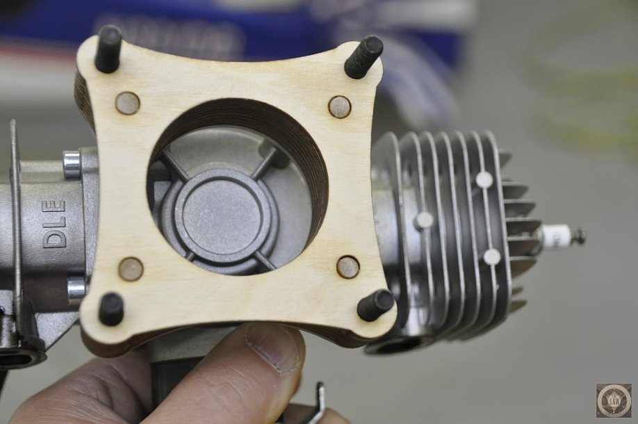

Finally have something to test my own engine mount on!
I love that prop!
I was wondering about the cowl. Even with a 40 Twin it just barely clears with angled plugs.

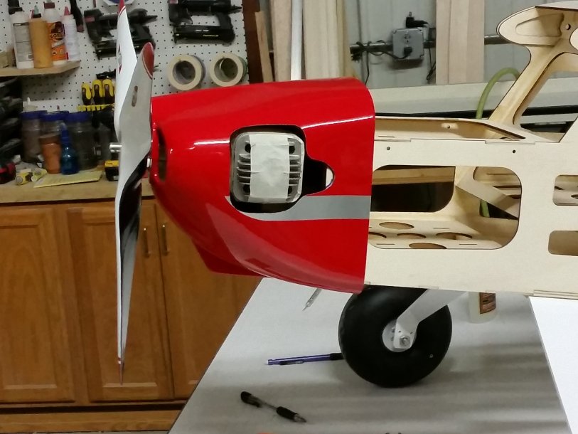

Yea, cowl is tight. Have to pull the plugs to slip it on. Also had to lower the thrust line 3/8" or the heads would be cut out of the top of the cowl almost. Since im not running a spinner itll still look good.
This cowl would be perfect for a dle61 though! I'll probably build another one and set it up for that depending on how it flies.
