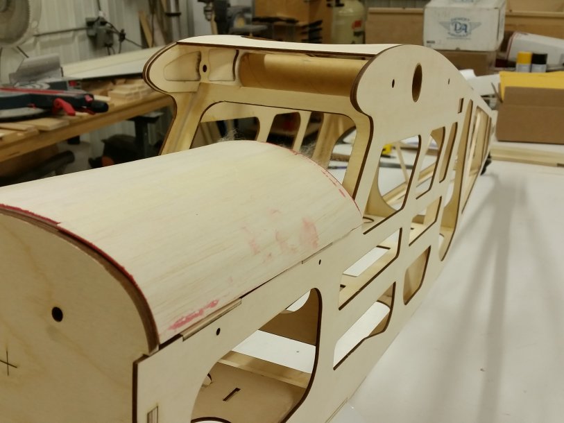

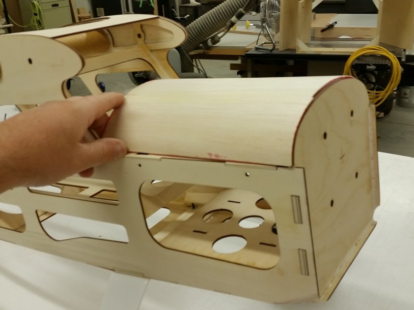

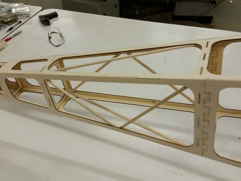

This is what happens when you don't hit the new posts button since yesterday morning, Terry designs and builds an airplane!
Hey somebody has to keep you on your toes! Unfortunately that's kind of the way I work I have it all figured out in my head and then it doesn't take me long to put it into CAD didn't make it come to life.
Added a few strategically placed sticks took the wings out of the bags and have the tiniest canopy deck known to man ready for assembly when I get time..... maybe a little bit tomorrow.
Now what in the world do I call this thing..... that is the question! Kind of has a tail of a decathlon, but looks a little bit like a little deuce coupe from the front.

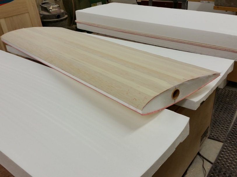

I have always shy'ed away from foam wings cause I always worry about not getting them right.
Sorry, glazed over this one. It's easier than you think. Although doing vacuum bagging and resin seems to really make it simple once you have the setup, I will never build a "built up" wing EVER again. I can do foam faster, lighter, stronger and straighter than built up. Piece of cake once you have the tools required. I still thank @Fixed Wing for his persistent advice to get me to learn how to do foam cores. His advice really took my building to the next level in terms of success and satisfaction:)
