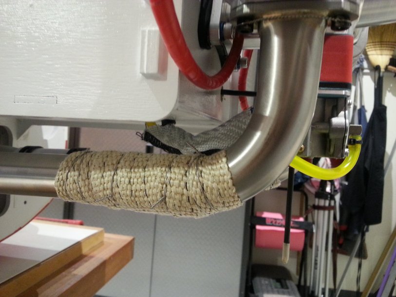

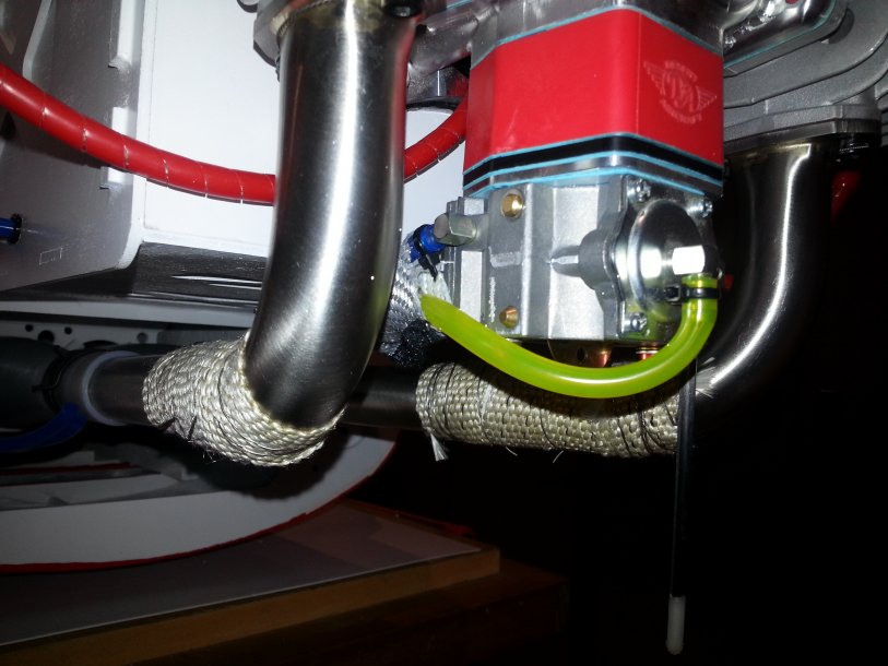

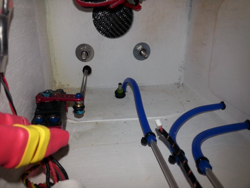

Trying a different approach to the vent for diaphragm on carb. I've read that it should be run to static air ,not flowing air ,so I ran a xlg id viton line to motor box, easily disassembled if I don't like it. My other engine DA 170, just has a short piece if fuel line, 1", on it running straight down and works fine. Also added a heat shield sock around it and fuel line, never melted a line before but sure can't hurt, re3s seem to run hotter than cans and 2 grams of protection seems worth the effort. Anybody else run theirs like this ? Started a thread on this method , some do, some don't.

I started a thread on this question in fueled engines section but thought I'd ask here too.
