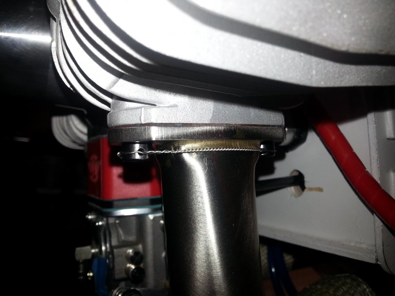

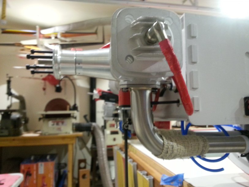

Minor changes ,big improvements. Re did plug wires and ingnition lead , forgot to wrap with spiral protectors and found red from mcmaster-carr , love that place. Should have a McMaster decal on this thing somewhere! Wrapped headers with better Teflon and heat shield cloth and stainless safety wire to minimize the sooting/ noise when the Teflon inevitably cracks and leaks. (And looks cool too), drilled flange bolts for safety wire , I find myself re tightening those bolts 2-3 times a season.. Not any more !
Re3s mounted, just need to drill and screw the connectors so they can't move.
Heat wrap, wire and spiral only adds .6 oz . so worth the effort to me for longevity and maintenance.
That's it. Just waiting for painted parts and a few small details before final assembly and balance. Then the nerve to actually fly the damn thing.
