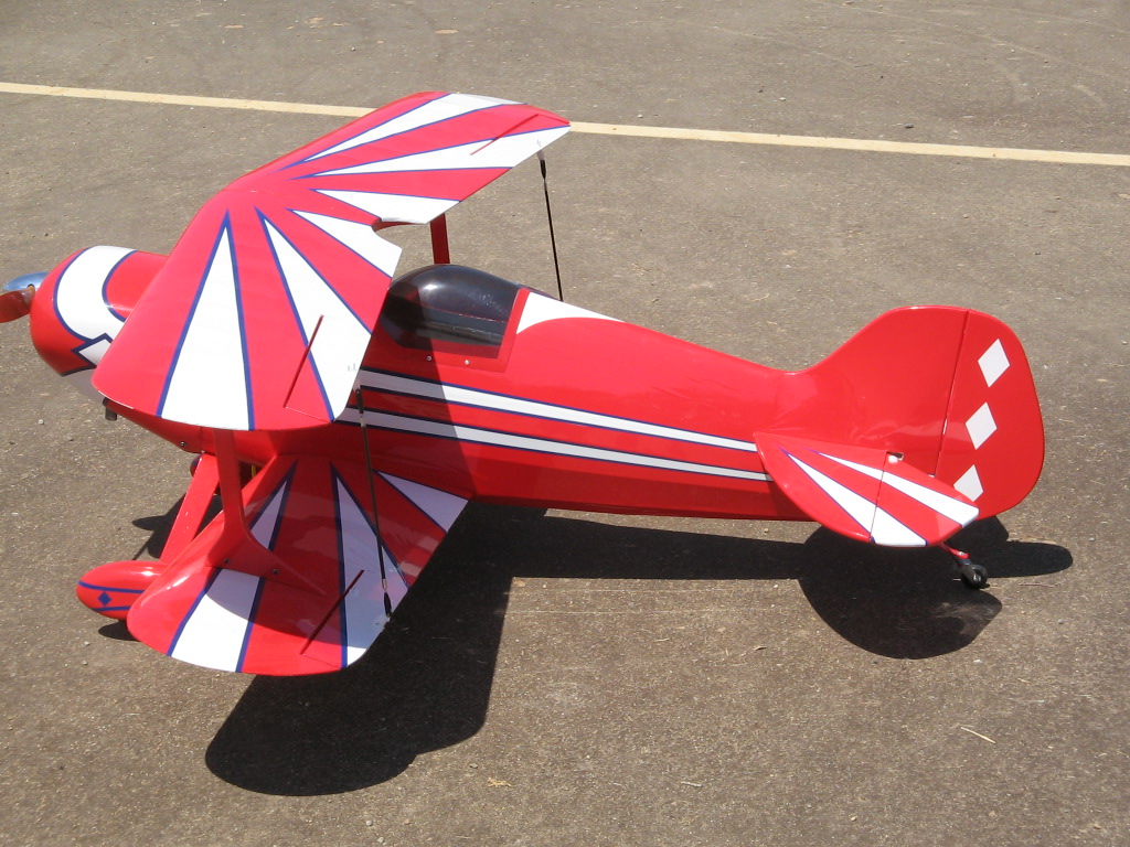

Kinda disagree, that funky wire connecting the two elevator halves will flex and cause grief. I will be adding the second servo to my elevator.

My 33% R C Guys Pitts.
Your design is different from my Jtec Pitts. There is no joiner wire for the elevator halves.
